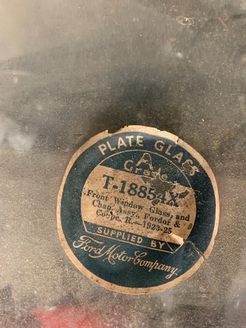

Today I took the glass for the windshield, doors, quarter panels, and rear window to the local glass shop. I will replace them with tempered glass. They measured the glass. It measured 1/4" for every piece except the quarter panel pieces which measured 3/16".
Is that normal or an odd situation? They can provide both thicknesses.

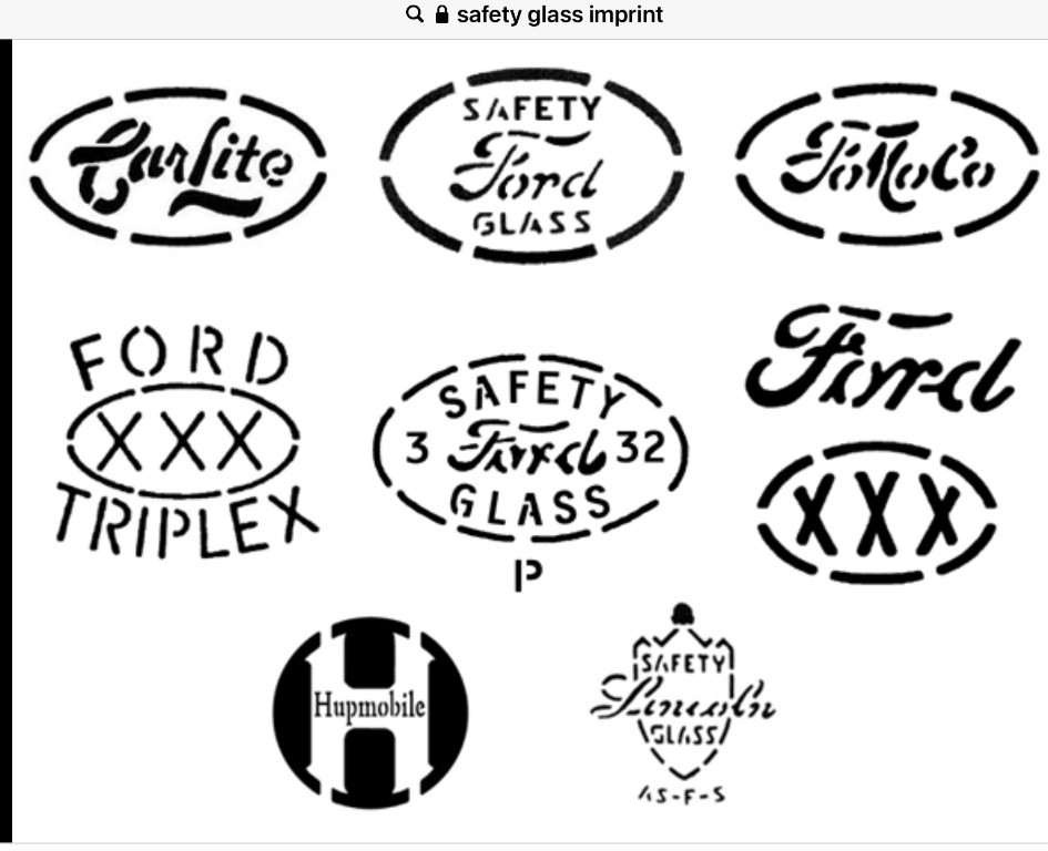

Tim, What is "imprinted" (maybe a dumb question!).

This is just a sample of some of the many types of glass imprints. It’s acid etched and usually placed on the lower corners of each piece. It gets kind of busy to have all that extra writing on the glass, especially so in a coupe where you are so close to it all. AND the original glass didn’t have these markings. To each their own!

A friend accompanying me pointed out he had some original glass in his car. An interesting discussion followed.
