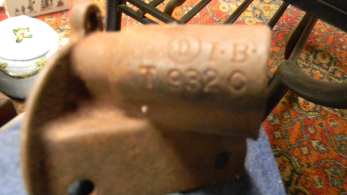

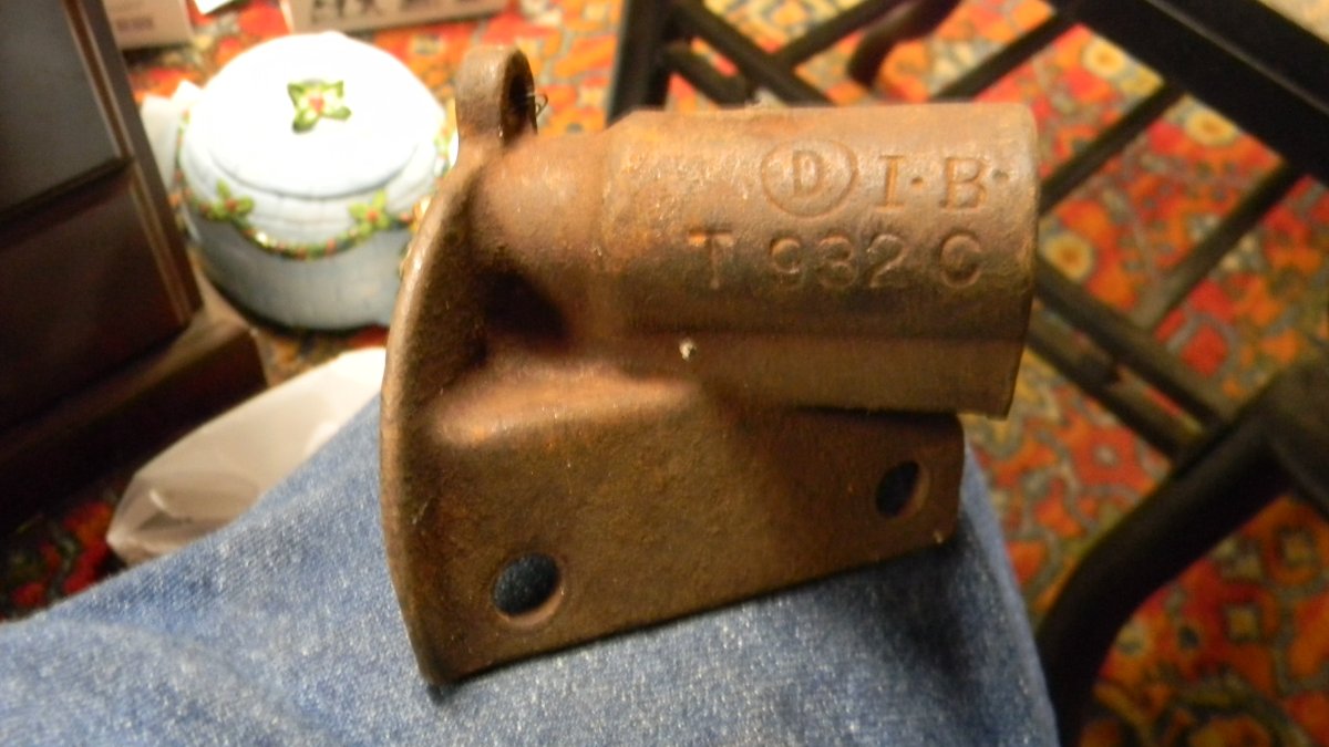

Post by FATMAN » Fri Feb 25, 2022 4:06 pm
Unusual steering bracket number
the TT 932C is for the 26-6 cars but what are the letters D T.B. ?
Bob
Les Schubert
Posts: 1357
First Name: Les
Last Name: Schubert
Location: Calgary
Re: Unusual steering bracket number
Post by Les Schubert » Fri Feb 25, 2022 4:14 pm
I don’t know what the numbers mean, but it looks like a RHD version?
FATMAN
Posts: 1697
First Name: ROBERT
Last Name: BERGSTADT
Location: LOVES PARK IL
Post by FATMAN » Fri Feb 25, 2022 4:26 pm
No it bis left hand drive,Bob
Posts: 3813
* REQUIRED* Type and Year of Model Ts owned: ‘12 open express,'23 cutoff, '27 touring
Post by DanTreace » Fri Feb 25, 2022 4:38 pm
For the 26-27 cars except the Fordor and the Chassis only. The letters identified the mfg of the bracket but don’t know that supplier to Ford.
