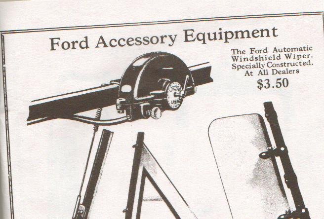

I'm looking for a period correct wiper for my Australian assembled 26. Looking at the U.S. literature we see this common Trico vacuum wiper as being the available accessory:

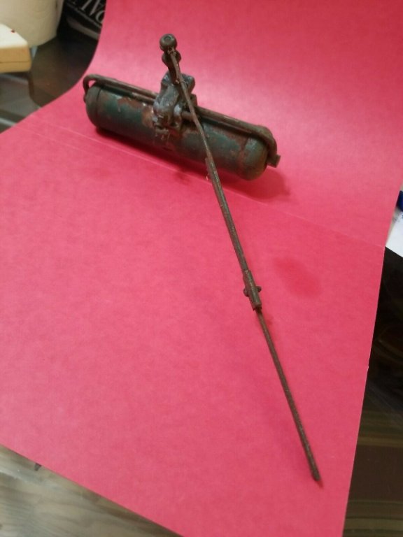

At first I wondered if it was a Folberth:

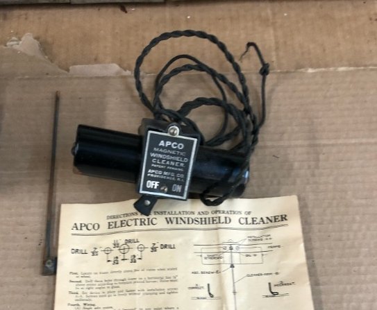

But then I was looking through the classifieds and found this Apco (alas, too late!):
Was it one of these?

John , having owned several originals, they are made by Trico, but not common at all. One of the very hardest to find late model T accessories. They are close to the regular Trico wiper, but just about nothing is interchangeable, other than the wiper arm. The actual ford supplied units have a round etched disc with the Ford logo on it. Two different models, one for open cars and one for closed cars. They were made from bad potmetal, so very hard to find one that isn’t warped and cracked. The arms for them are made as a perfect reproduction by A & L . They supply mostly model A very high quality reproduction parts, wholesale only. Hope this is some help. Good luck on the search, that is half the fun.

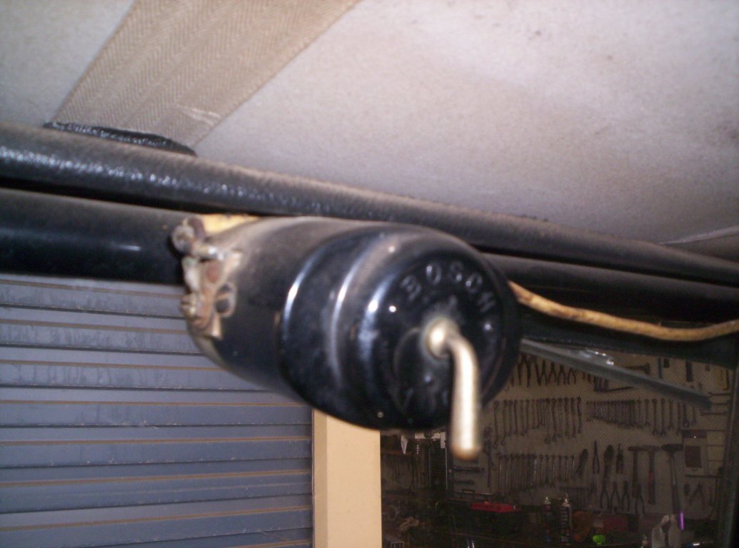

John, my 26 has an electric one made by Bosch, I don't know if it left the dealership with it. The oldest photo I've got of the T is 1964 and it was on it then.

Forget vacuum, Unless you just want to look at it, that bOSCH that Kerry has would be my first choice. Likely period correct, too.

Kerry, your Bosch is very elegant and certainly looks period correct. I'm curious about the the wire, since none of the advertisements I've seen for old wipers show how to route this (or the vacuum hose). I presume it's just clipped to the windscreen frame and run under the dash. What kind of clips were used and are they just screwed under the existing side curtain clips?
