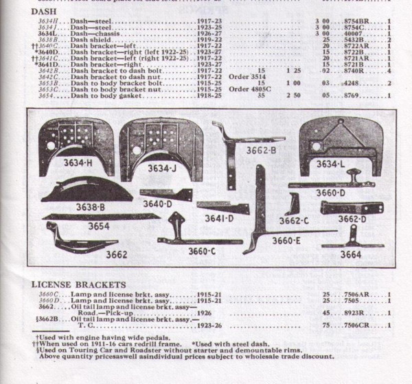

Why does the part list shows 3634-H for 1917 - 1923. Note also the * for the bracket years.

Frank B asked "Why does the part list shows 3634-H for 1917 - 1923." Referring to the low steel firewall.
Ford considered the steel firewall to be a superior replacement, and an appropriate repair/replacement for a damaged wooden firewall. Ford was not trying to satisfy our judging standards today. Just keeping his cars running, and his customers happy.
My officielly 1922 but maybe 1920 Model T wich originally was a Touring but at some time in it's life got a danish build four door body, have a low steel firewall and that have made me wonder.
Either it have been a requirement in Denmark/Europe to have firewalls of steel OR it was exchanged with that 3634H when the 4 door body was made.
My officially 1921 Roadstar pick-up is the same. The body is a 1920 touring also with steel firewall also assempled in Copenhagen originally.

Steel firewalls for 1917 - 1923 was not something where people adapted a 1923 - 1925 steel firewall - it was a regular Ford sparepart! It COULD have been added later as the wooden firewalls broke down, but it's there in my original danish Ford Sparepart catalog of 1931 just 8 years after 1923. NO mention of using it in place of the wooden type, but then - the wooden firewall is not listed.
So there are "Factory Originals", "Vintage Owner Originals". I prefer cars with character - Vintage Owner Originals that reflect the history of ownership like yours.
