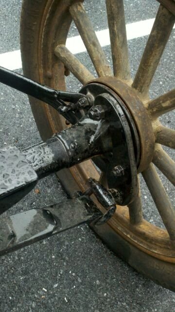

Hi Morgan,
These are not as nice as yours but I found them online and have seen a nicer set. I'm just thinking that new bands & lining would be just north of $400 and i'm pretty cheap. If I don't do the lions share of the work I can't afford all my toys. Craig.

Re: 1925 vs 1926-27 Rocky Mountain brakes
Those look good, pretty much exactly like the ones I saw plans for. I understand and agree about doing your own work. That’s how I am myself. I have too many interests to pay someone else to do the work. I also get really annoyed when I pay someone to do the job worse than I could do it myself. Plus, with every job I learn something.
