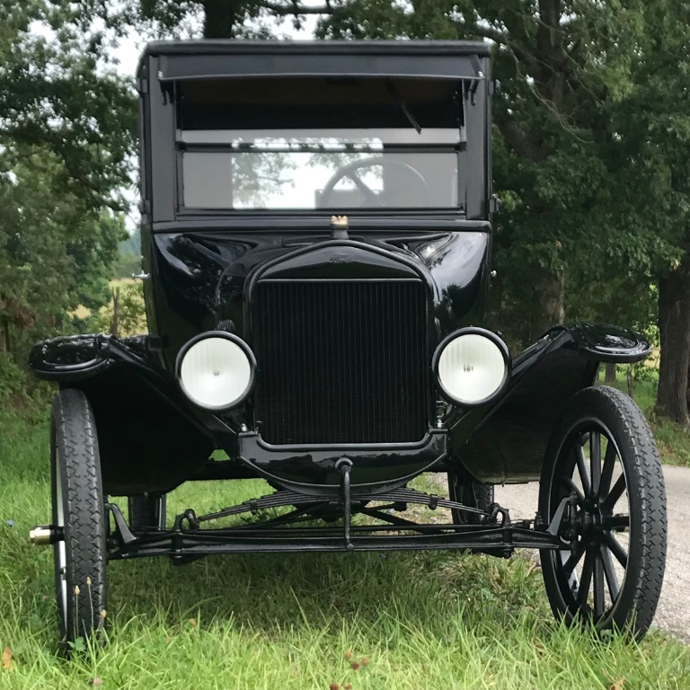

I'm running an original round-tube in my '19. No troubles. Lots of Tours, both National, Regional and local. Never a problem (though for an original, that is a shockingly unusual circumstance). My point is, if mine still cools, you will most certainly do just fine with a new, original style round tube radiator. It will also look correct.
Nice looking car - Are you overheating or just looking to spend a lot of $$$ for grins?

But in all seriousness, thank you kindly. This coupe has been my baby and she is almost, dare I say, “restored”. Or at least my take on it.

Steve, in his profile, he has a ‘25 coupe. Jim Patrick
- Posts: 7413
Re: Tall Radiator Question
Yes, there's a picture of it. I would go with a Berg's if it's still available, or a recore if it's not....in his profile, he has a ‘25 coupe.
