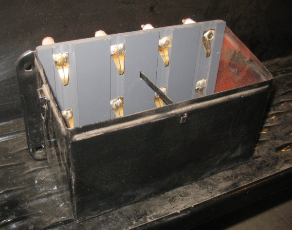

Posts: 7411
Re: Advise needed on ignition problem
Post by Steve Jelf » Fri Mar 25, 2022 9:48 pm
The bolts were sheathed in shrink tube...
I gather the coil box still has its old wooden back panel. Especially if it has gotten wet at some time, you can have carbon tracking that grounds a circuit. I expect the shrink tube is insulating the bolt from a carbon track in the wood. This is why I always install John Regan's FP kit in a coil box.
