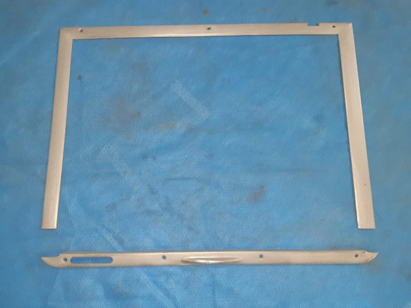

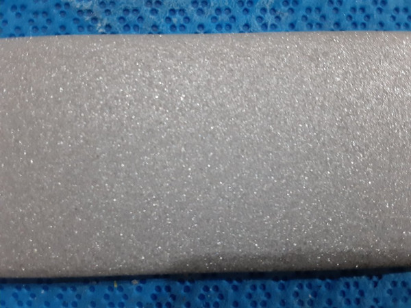

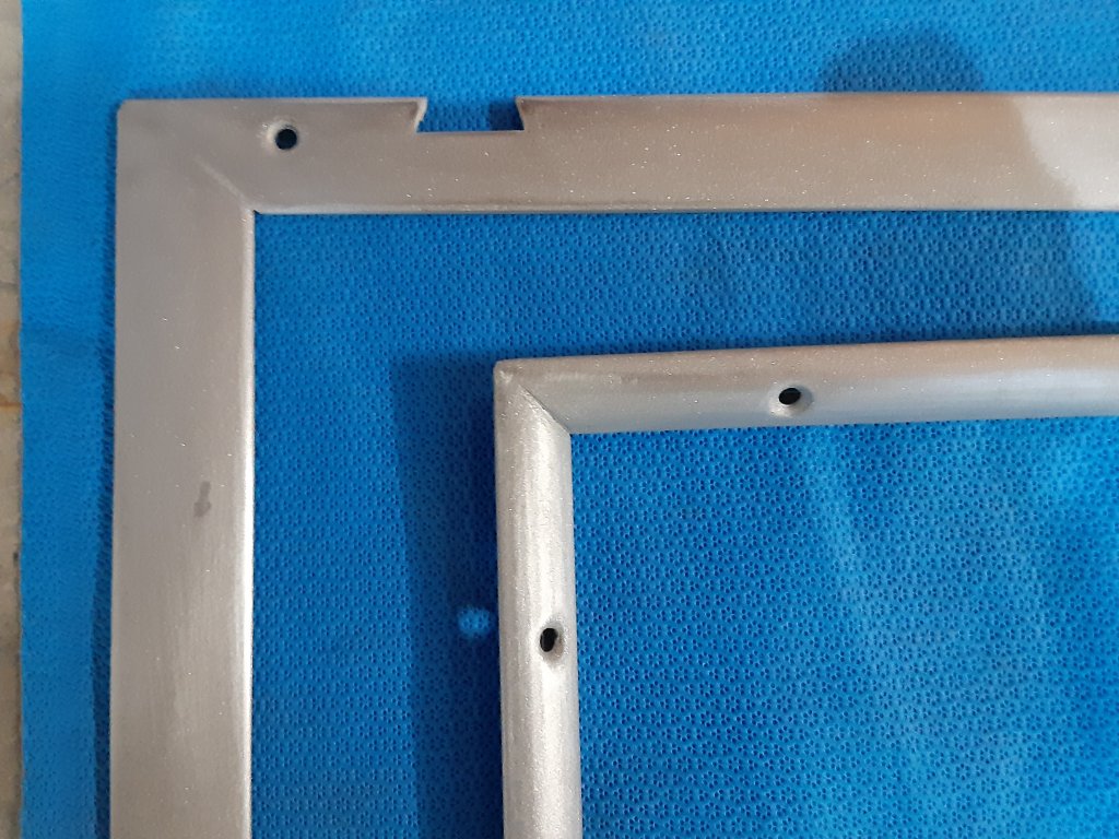

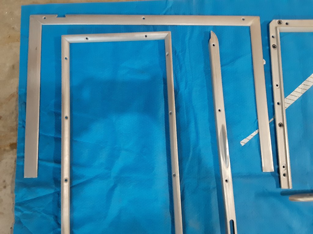

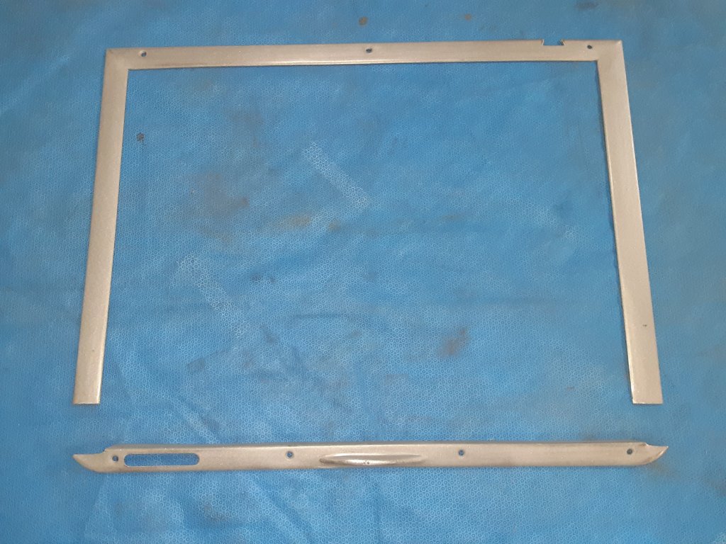

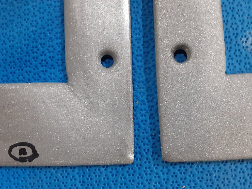

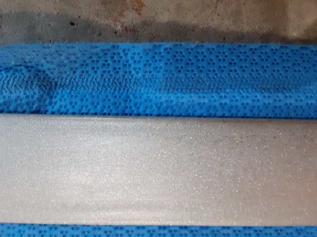

These window trim pieces, for my 1927 coupe, have been blast cleaned by crushed glass. I intend to paint them by foam brush using Rust-Oleum Protective Enamel in gloss black. Do I need to prime them? I have Rust-Oleum Rusty Metal Primer that I could use. I am thinking that the advantage of using just one coat would reduce the chance of showing brush strokes.

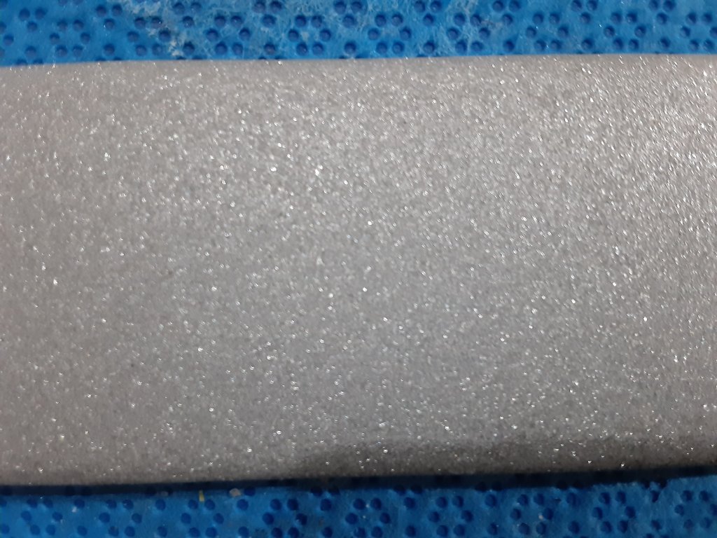

The pieces have been hand sanded using 220 grit paper, except for the one on the right in the third photo and the last photo.

That looks like a rough finish needing some build up & smoothing. If it were not rough, I would give it a coat of flat black spray paint as a base to help adhesion & finish coverage.

John, The 220 sanded areas are not rough.

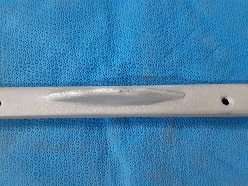

The last pix looks rough to me. If you determine its smooth, then no need for a "thickness" primer. A thin adhesion coat would still be a positive move.

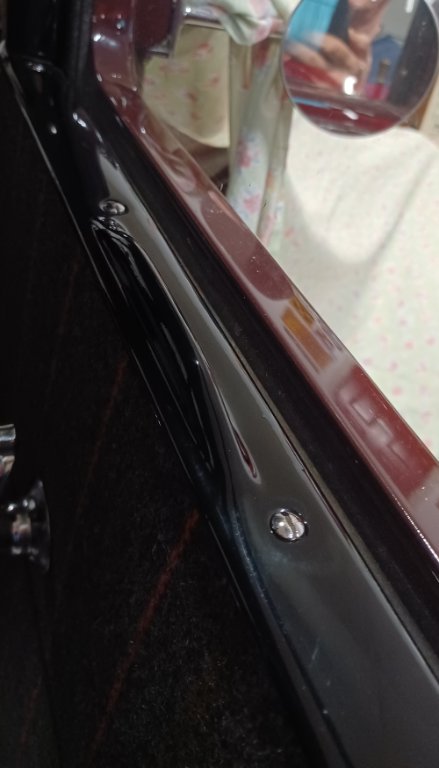

Those pieces look kinda rough in the pics. Here's one of the interior trim pieces on my '25/'26 Fordor that were restored probably better than from factory new. The pic doesn't do them justice. Smooth as a baby's behind and shine like a mirror. Someone did an outstanding job on this entire car.

The piece on the right in the third photo has not been sanded and piece in the last photo has not been sanded.

Typical sandblast damage. You could sand a board with that rough surface! Awful!

Yes, prime them. Use a very dark primer, like black, for the reason John mentioned. Sand with a fine grit (at least 800), and finish with your gloss black. I would use spray rather than brush.

Pieces hand sanded with 220 grit and ready to prime. Smooth as a baby's behind. Can't sand wood with them now. Nice.
