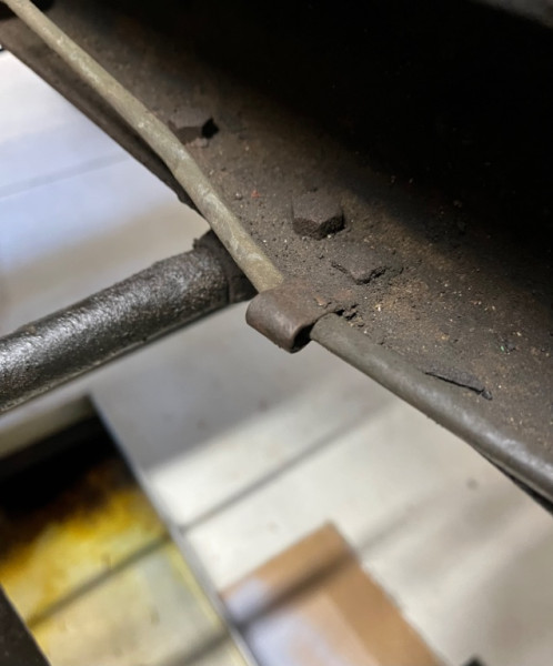

Guys, my 12 is a Aug date. I'm assembling the carbide gas line. I have read on other posts that there was a gas line strap the fastened just forward of the handbrake to hold the line. I've read the posts with having the strap for 13's. Did 12's have this strap? Any of you with a 12 summer build (June-Aug) confirm this?
This is the strap I'm referring to.
Thanks Mike

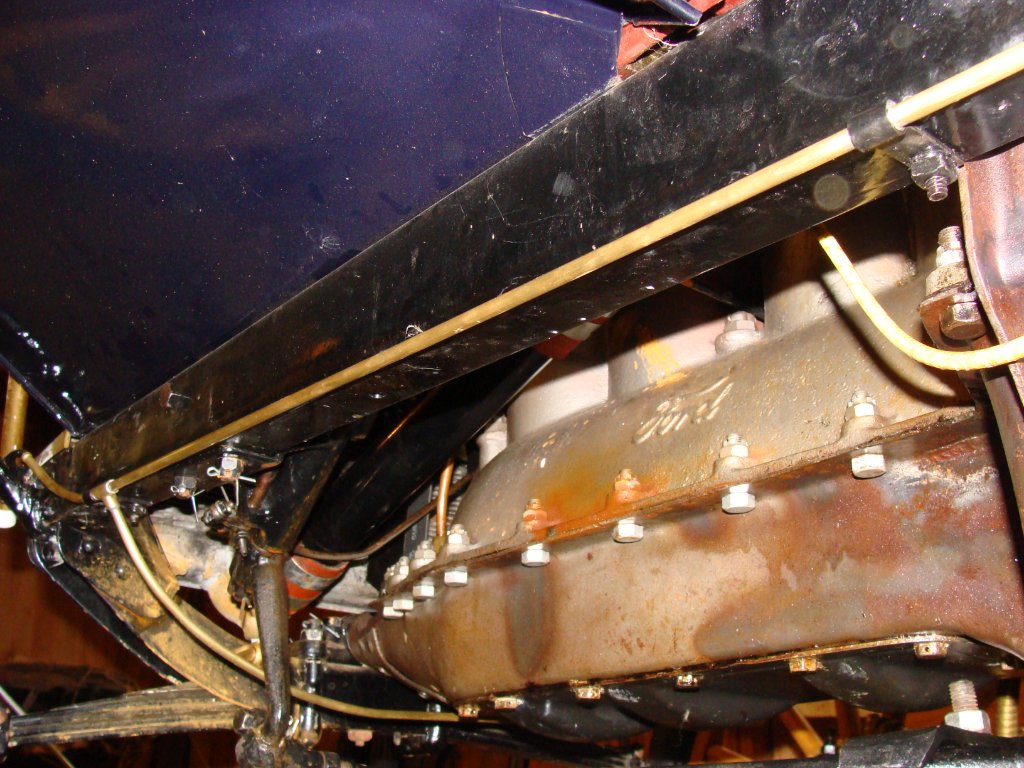

I'm not sure about specifics for 1912, but here is the piping and clamps I did for my November-ish 1911.
-Keith

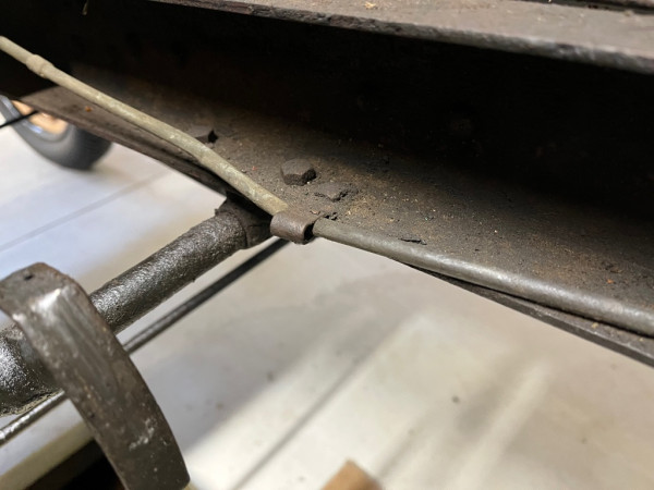

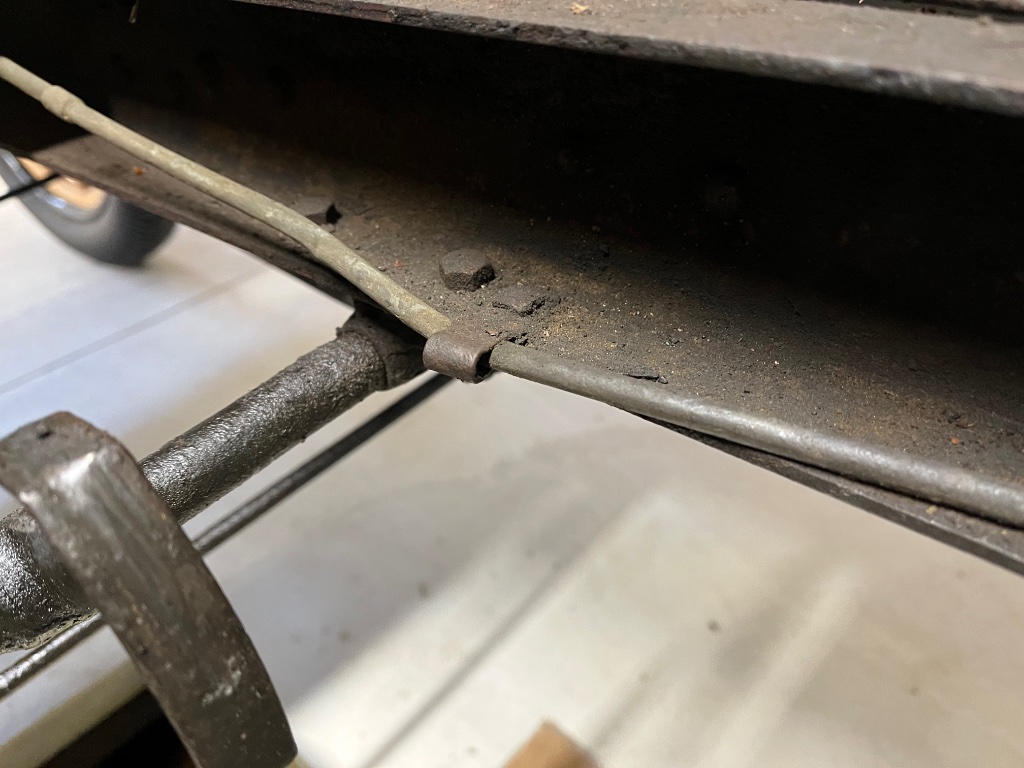

Here are a couple shots of the clamp on my June 1913 Touring.

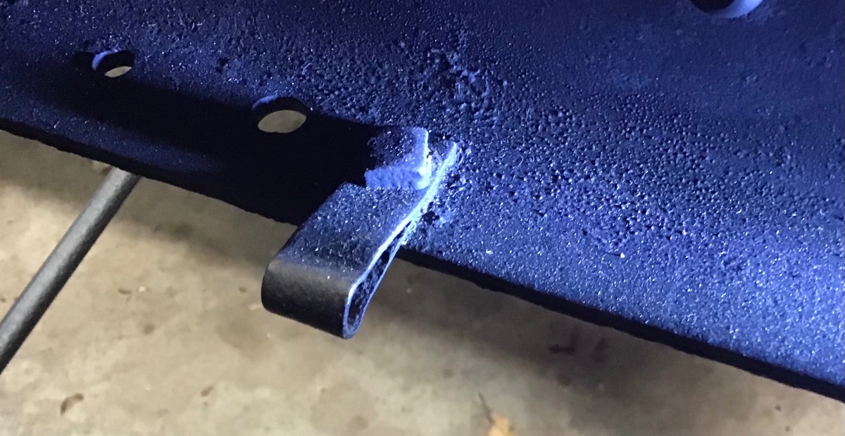

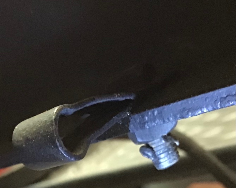

Gas line clip on my ‘13 frame. Square head bolt, square head nut under, bolt shank has cotter.

Dan and Ed,
Are those square head bolts and nuts 3/8" across the flats? With a 1/4x28 thread?

Keith,
Yes, the bolt is 1/4”-28, 3/4” overall length, and the head is 3/8”across the flats.
It is the same type of bolt that bolts the engine pans to the frame rails on my car.
