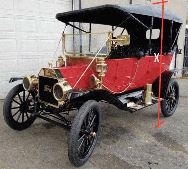

Can someone please tell me the approximate height of an early T touring (1912 in my case) from where the rubber hits the road to the top of the top when it is up. Thanks!

I would like an approximate overall height of an early T touring. I doubt there is a big height difference in a US vs a Canadian one. I don't have my Canadian '12 in my possession to measure it at the present time. It is going to be shipped to my home in Florida and I was wondering if it'll clear a garage door with the top up. I also don't have a measurement on my garage door either at this time but it's what would be considered a standard height garage door from circa 1996.

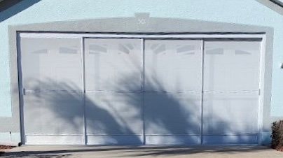

I also have the sliding screens on the garage and lose some height there.

The 'X' measurement I have tried to show on the picture is what I'm looking for. It's sometimes bad to assume, but a 1911 touring probably has about the same height!? Again, I'm only looking for an approximation. Thanks, John

Just got over to my storage space and measured the height on my late, slab side '12. It is 7' 2" at the highest point.

Thanks a million for that! Very much appreciated. In the meantime I'll get my neighbor to measure my garage door height. When the car is delivered the top will be down but if it will fit through the door with it up I will get the transport driver to help me put it up. Again thank you so much for that measurement!Russ T Fender wrote: ↑Sat Mar 05, 2022 12:15 pmJust got over to my storage space and measured the height on my late, slab side '12. It is 7' 2" at the highest point.

My neighbor informed me I have a 7'-0" high garage door, actually less with the screen sliders. The measurement of 7'-2" that Val gave me indicates that the top will have to be in the down position. I do not have land enough to put an addition on the house so I'll work with what I have.

In the home we had before moving to Florida I had a 7' garage door but if I pushed the door further up and blocked it in place I could get the '12 in the garage with the top up. Your screens may preclude that but you might try doing that and measuring the opening. I would also caution you to measure your car with the top up to confirm the height before driving in with the top up even if you think you have the clearance as the height can vary depending on how the top was installed. Yours might be slightly lower or it could be higher, unfortunately it ain't a precise science.

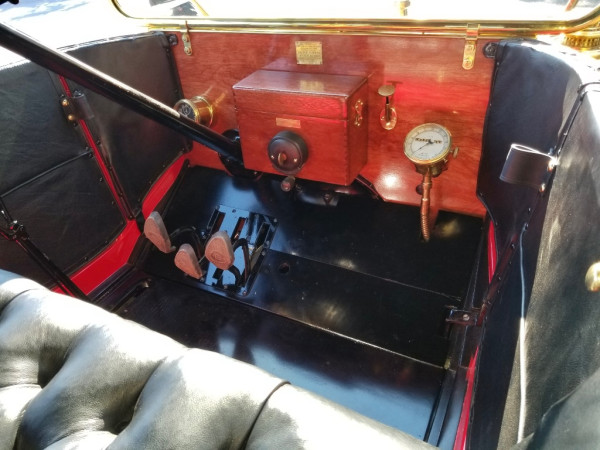

Hap, I do have a question about the picture you posted of the two lever, two pedal T, where would the carbide generator be mounted? Thank you for all of your suggestions, and well wishes!

Good question "Where would the carbide generator be mounted?" Normally I recall seeing them on the left side running board of the USA produced Model Ts in the old photos I have seen. And when they have an acetylene tank instead of the carbide generator, that also is often seen on the left side running board of the USA produced Model Ts.
(Note early English T photos show the generator on the right running board most of the time. At least a few early Ts that were imported as Left Hand Drive had the gas generator on the Left side running board see pages 21, 30 & 31 of "The English Model T Ford" by Riley, Lilleker & Tuckett. But the photos of the RHD cars appear to usually have te gas generator on the Right Hand running board. And in some photos we cannot see the gas generator at all so it may not be on the car or it might be on the other side? )
Note some of the early Ts were apparently sold without headlamps. Ref page 480 of Bruce McCalley's "Model T Ford." Serial number 1,774 manufactured Mar 24, 1909 -- it also did not have a windshield. Serial number 2110 manufactured Apr 2, 1909 was also a touring and also did not come from the factory with gas headlamps or a windshield. Serial number 2,200 manufactured Apr 7 also did not have gas lamps or a windshield. So in those cases the owners could have purchased them later from a dealer or an aftermarket seller. If from the dealer I would have thought they would be installed with the "gas generator" on the left running board. But if an aftermarket supplier then perhaps they put it on the other side? Perhaps someone else has another thought or even the real answer on why it is not located on the left side running board on the photo that was posted?

Hello John to the top of the rear bow on my Canadian 12 Touring is 6 foot 10 inches and the centre bowes are a little taller so I would say you need 6 feet 11 inches clear .
