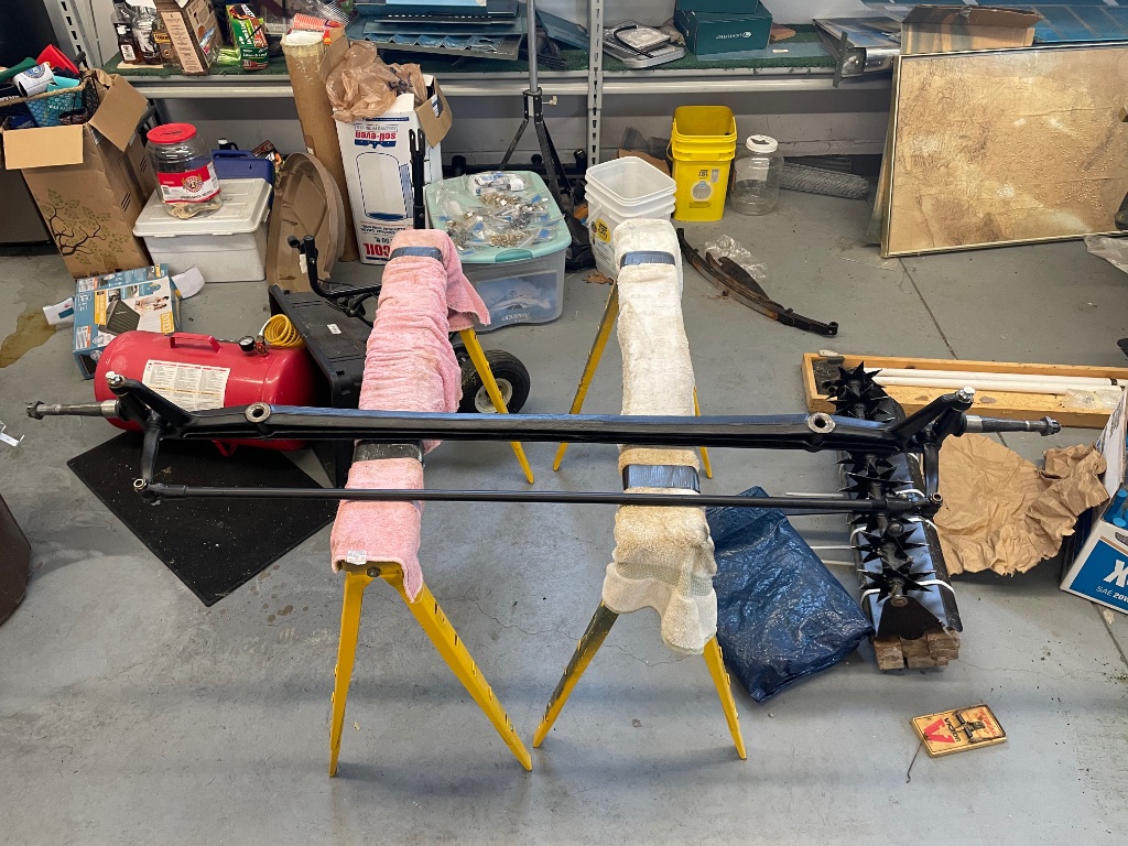

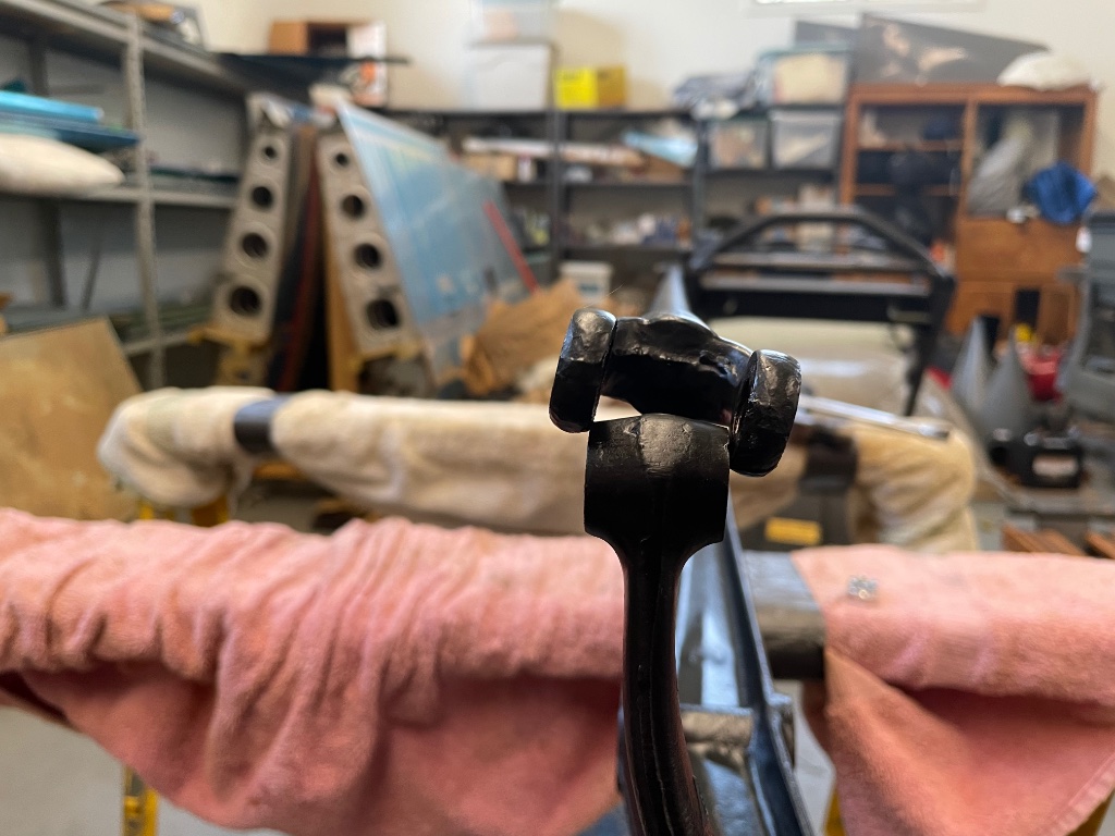

I had the front axle and steering components from my ‘24 touring car straightened and rebushed a couple of months ago, got them cleaned up and painted a couple weeks ago, and am finally getting around to getting them reassembled. When I was reinstalling the tie rod I thought it was interesting to see how much the axle had been twisted. :shock: It was an easy job to loosen the adjustable clevis/ball-end and make the correction. The spindles appear parallel to the naked eye, but I’m going to leave the bolts finger tight until I get the axle and wheels reinstalled and check the toe-in.
Earlier this week I got all the spring components cleaned up and have started the painting process. I’m using Rustoleum Rust Reformer on all the parts except the perches, which had good paint on them before. They cleaned up nice and bright so I’m using Rustoleum self-etching zinc oxide primer on them. I’ll be topcoating the bottom surfaces of all the spring leaves except the main with EZ-Slide graphite paint, which seems to be doing it’s job on the front spring of my ‘25 express wagon. I’ll topcoat everything else with Rustoleum black satin enamel. That’s what’s on the axle, and it looks good without being too glossy.
The last job before reinstalling the axle will be cleaning up and painting the radius rod. In the meantime I have an airplane whose brakes need attention…

Lookin good on front axle. I just went through the front axle on my TT. By the way, are those "air brakes" on your plane?😁

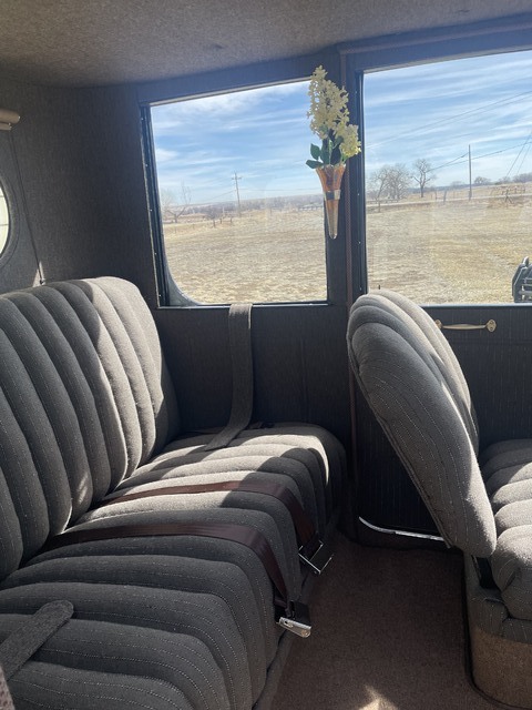

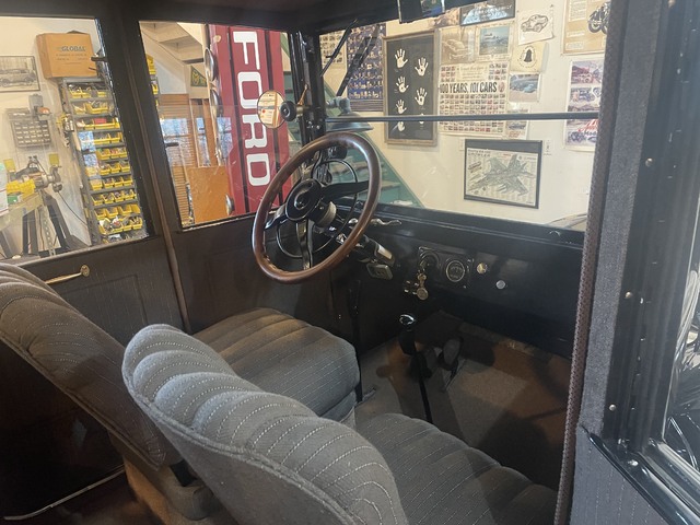

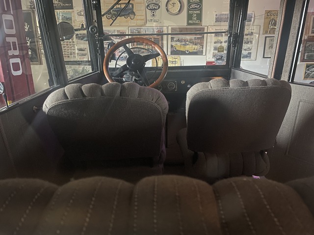

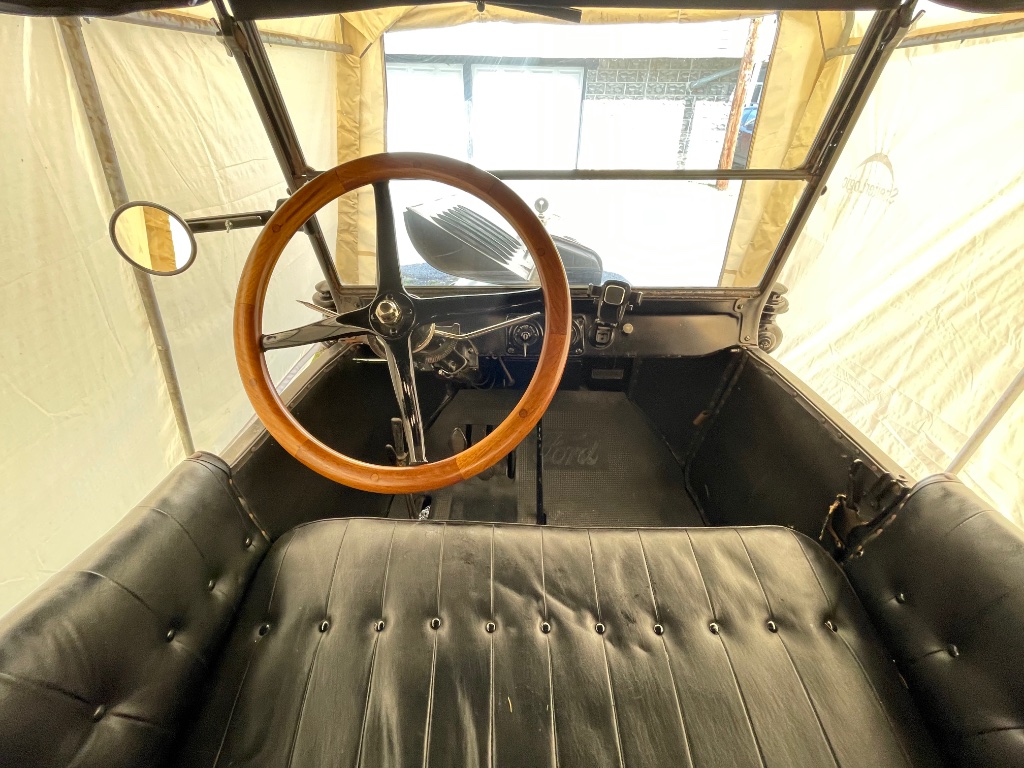

Finally finished installing the interior kit in the '22 Center Door.

That looks fantastic. Nice work.

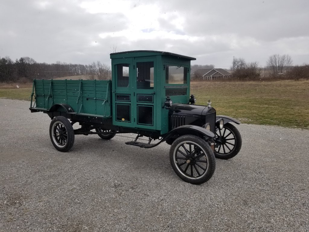

Nothing but the grandkids put hundreds of miles on the TT
in my shop yesterday.

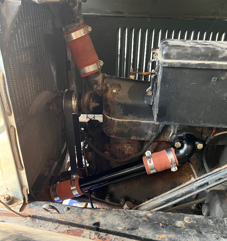

Water pump removed, hoses and pipe installed. Just got to fill it with coolant, and hopefully starting next time.

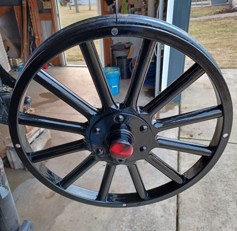

Lucky you Dallas! Glad you got out with 'em. Cute kids. I just started painting my new spoked wheels for the Fordor.

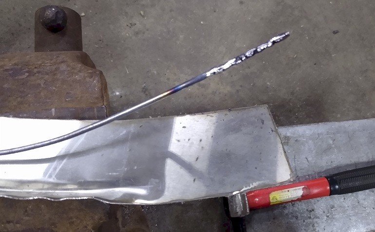

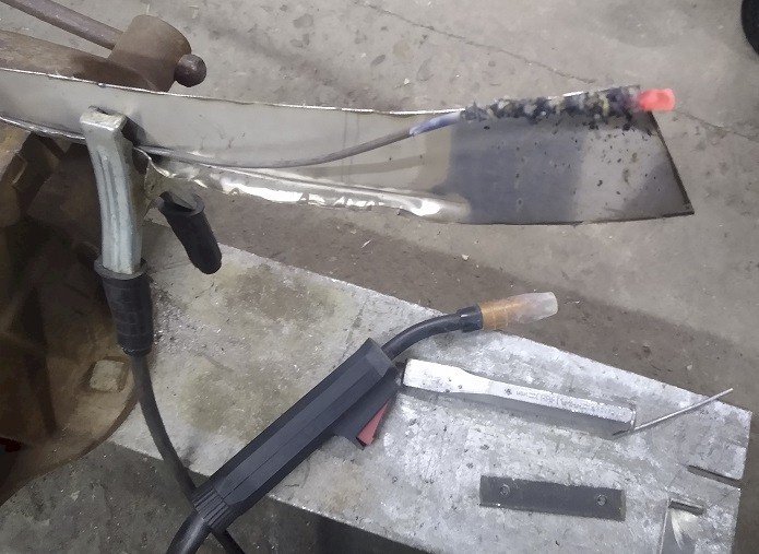

The lip of the fender on the '26 coupe is sheet metal wrapped around about a 1/8" steel rod.
While making a patch panel which included the rod, I found that the rod was one inch too short to reach the end.
In this experiment I used stainless steel wire welding and extended it 2-1/2" (more than I needed). I suppose I was having too much fun.
I then hit it with a grinder to the correct diameter and finished rolling it into the sheet steel with a hammer and punch.
The punch is the dark grey homemade tool (not the cold chisel).

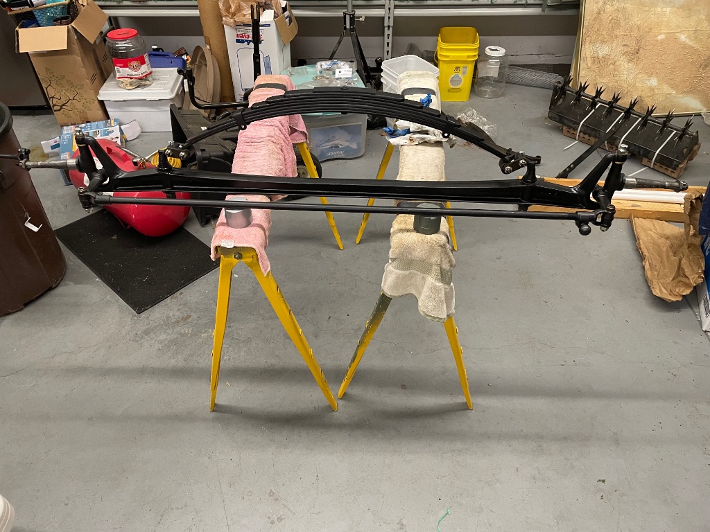

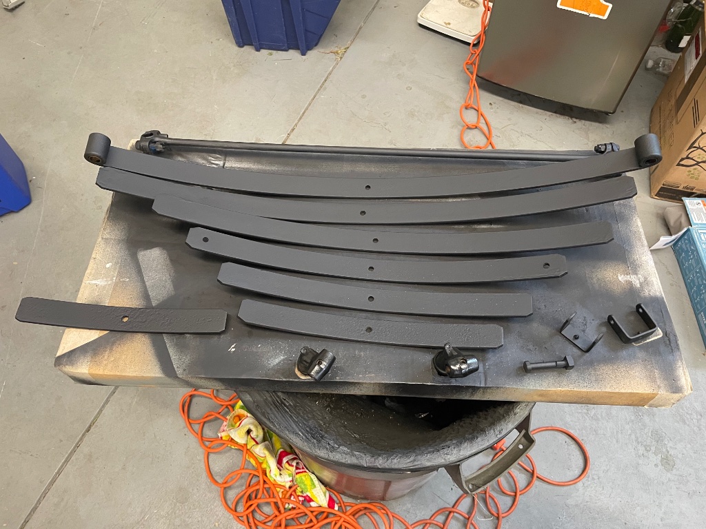

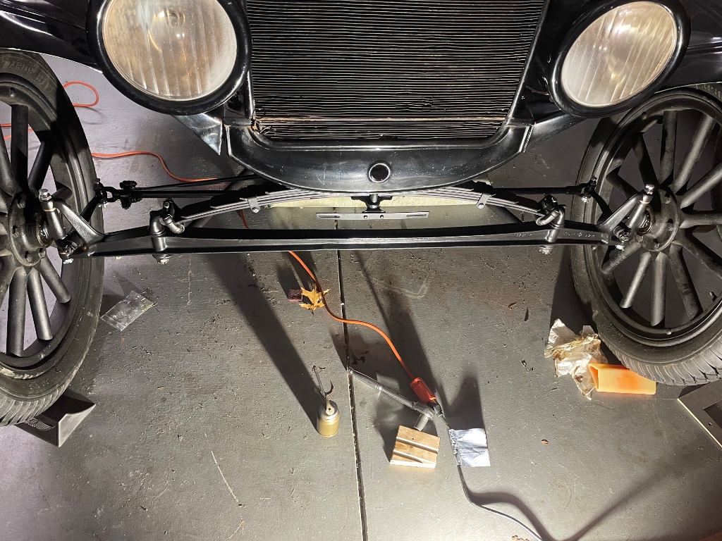

Getting closer to getting the front axle back under my ‘24 touring car. Today I got the spring reassembled, and hung it with new forged shackles. I still need to clean up and paint the radius rod, spring hanger, and license plate bracket. Also found out today that the tie rod bolts take larger oilers than the rest of the axle, and that I inadvertently ordered spring clamp bolts for the rear spring instead of the front. It’s always something…

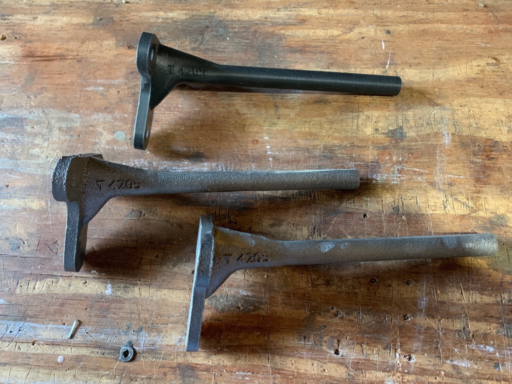

Finally got my rear fender irons casted for my delivery car project. Going from original Ford prints to 3D Modeling and 3D printing one for the metal casters to finished casting. I still need to do some finish work on them and get the holes drilled. What took the longest was finding a place willing to do them and in a small run.

Very nice Mike. Thanks for showing them.

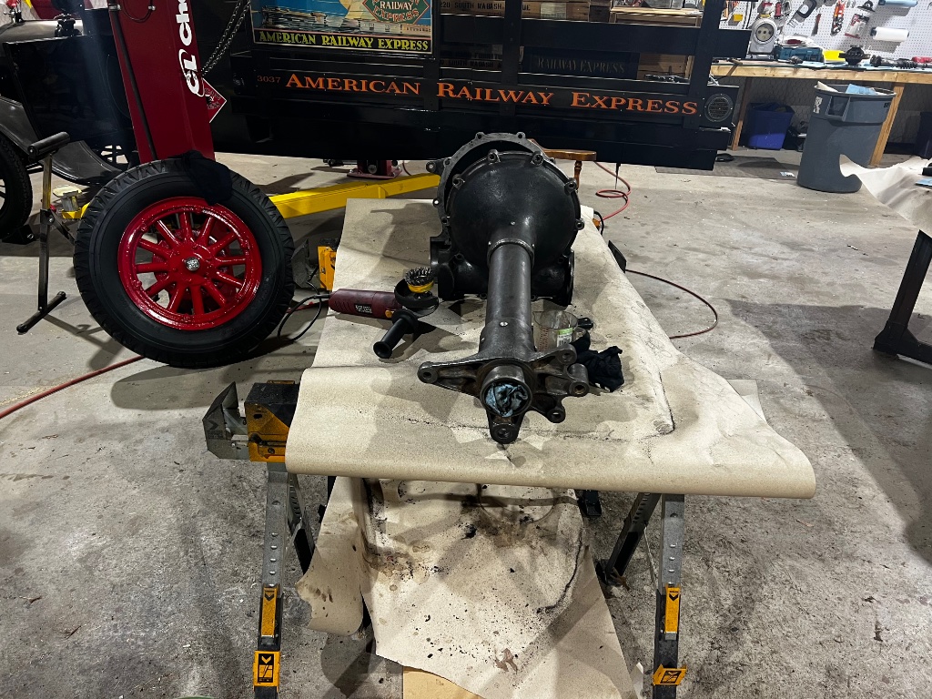

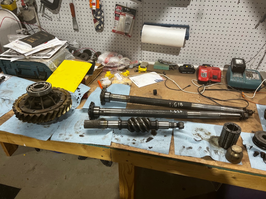

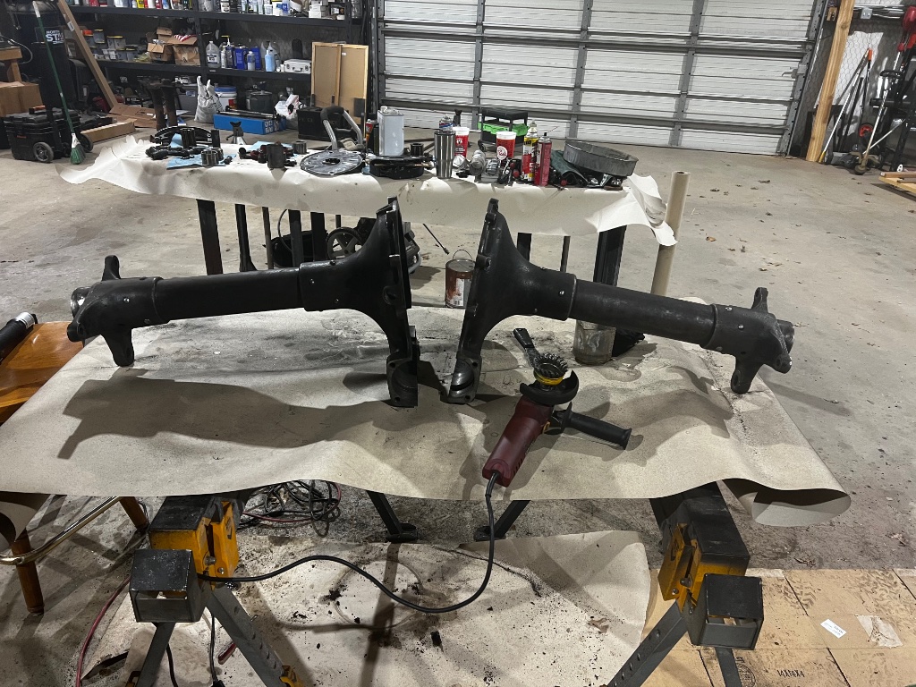

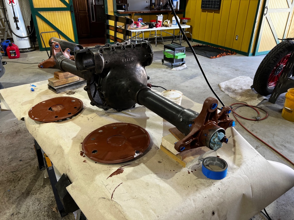

Rear end going together on Clarabelle the TT. Got all the parts sourced and now just time for reassembly and painting.

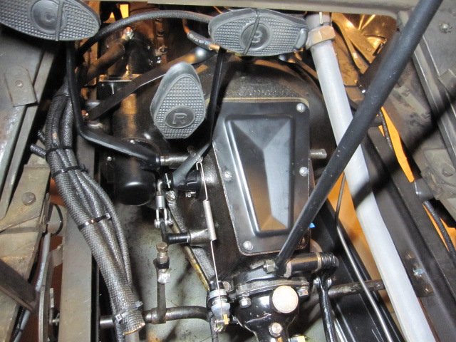

Removed the front mat and floorboards to adjust clutch linkage. I found some sloppy linkage and ordered new from Lang's. As soon as the parts arrive I will install them and finally get the linkage properly adjusted.
Update: Ya win one once in a while! The slop was where the linkage end goes through the pedal. I envisioned having to remove the pedal and have a bushing pressed into the oversize hole for the linkage. Surprise! The wear was almost entirely on the linkage end, so all that I have to do is install the new linkage that just arrived from Lang's. Yesss!
Update: Finished installing the clutch linkage and the slop is gone! Unfortunately even with adjusting the brake/clutch lever to the max I still don't have a "free" clutch. I'm going to have to go into the transmission and do the internal adjustment. Rats!

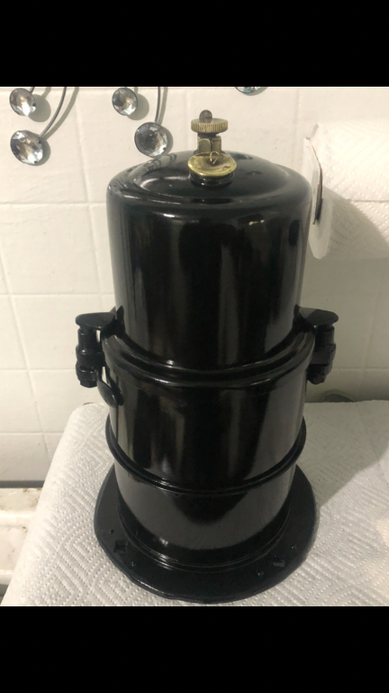

Took my carbide generator off and restored it. It looked bad compared to the rest of the car, now the rest of the car will look bad compared to it.

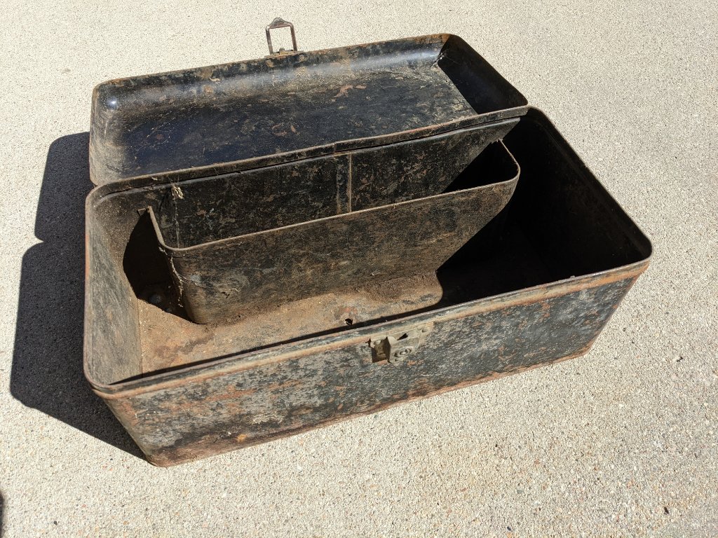

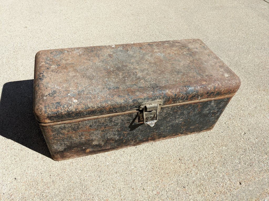

My neighbor recently opened an antique store near my home. This running board toolbox was on the porch. It's mine now. 😀

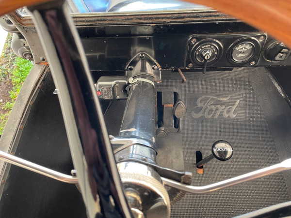

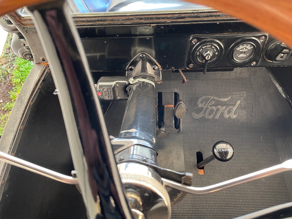

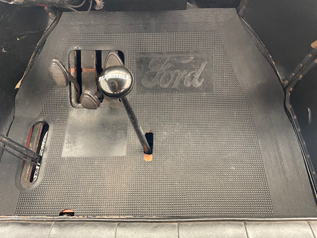

We finally got some nice weather this week, so I finally got around to installing the Ruckstell shifter and wooden steering wheel I picked up at the Marietta swap meet. The shifter replaced the one that came with the car because someone in its past cut it off Code to the floor.

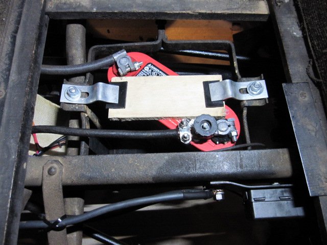

Replaced the old tired battery with an Optima....what a huge difference when cranking.
Cleaned up the spark plugs, checked and re-torqued the head and mounted the NH after checking the float level and replacing the bowl gasket.
Pulled and cleaned the trans oil screen and magnet, and topping off the oil level.

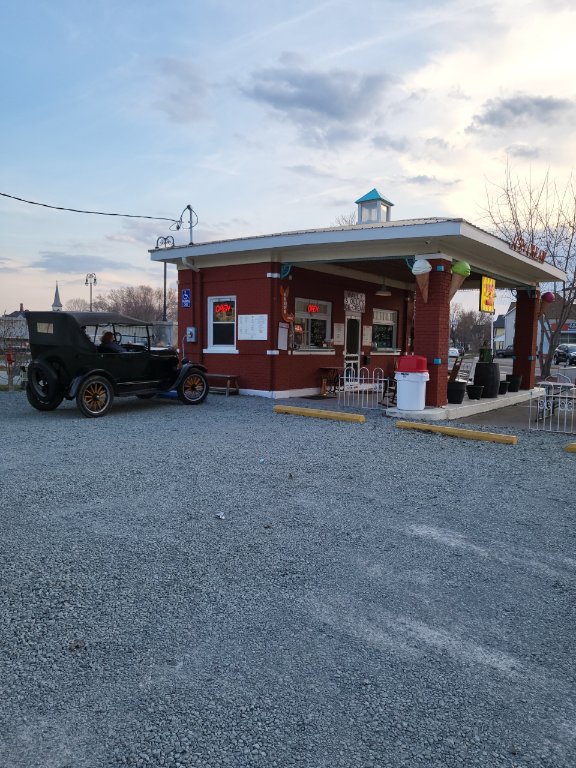

Second time out this year. Ice cream run.

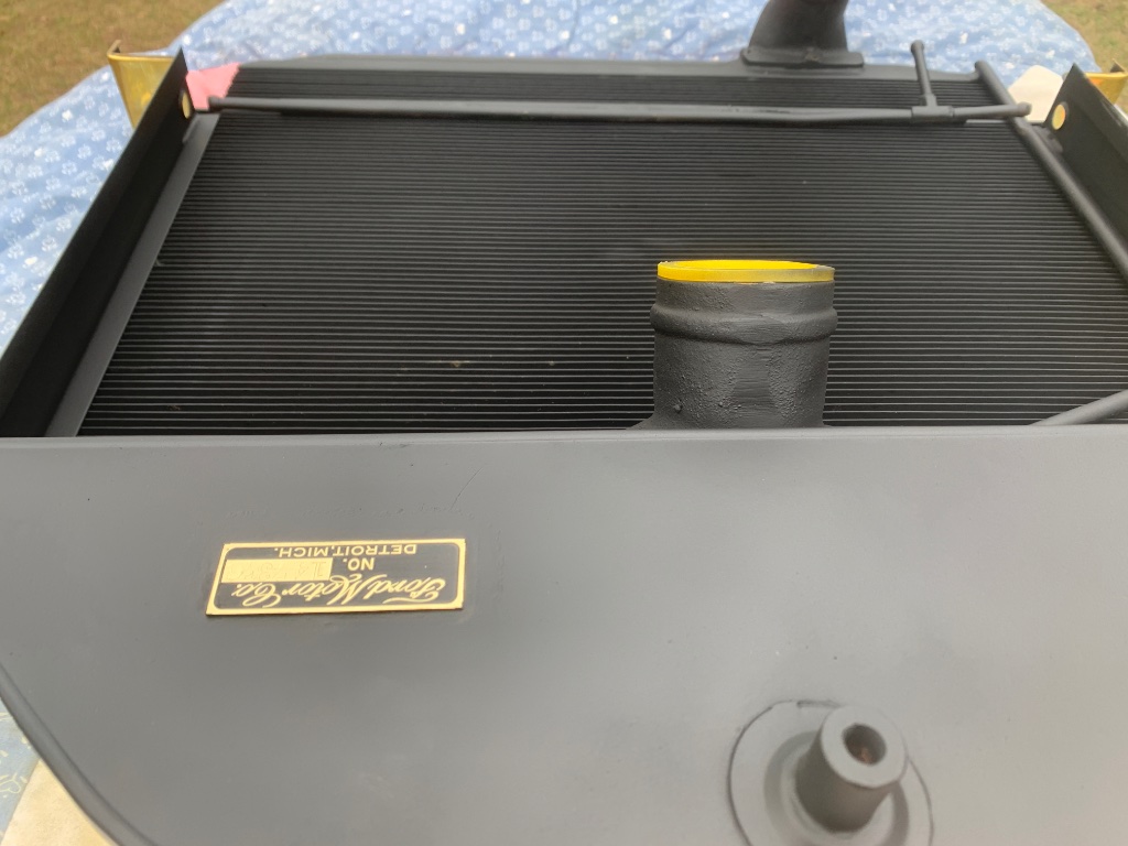

I cleaned up a new brass radiator that was in storage for a long time from someone else’s project. I unsoldered the wrong repo radiator tag and put on a authentic repo tag made by RV Anderson and soldered on the correct radiator gas crossover tube.

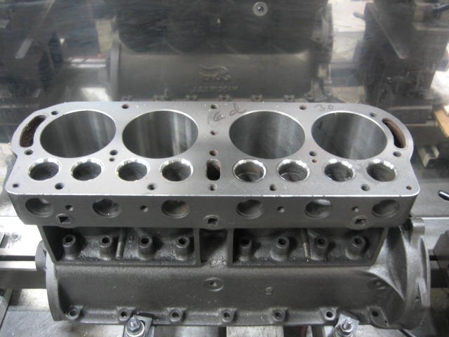

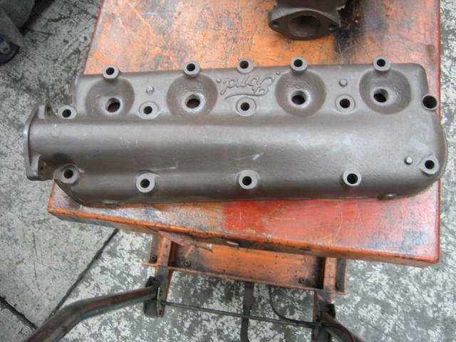

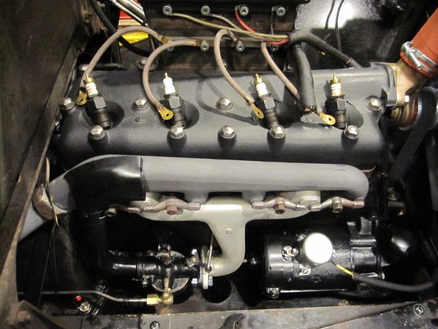

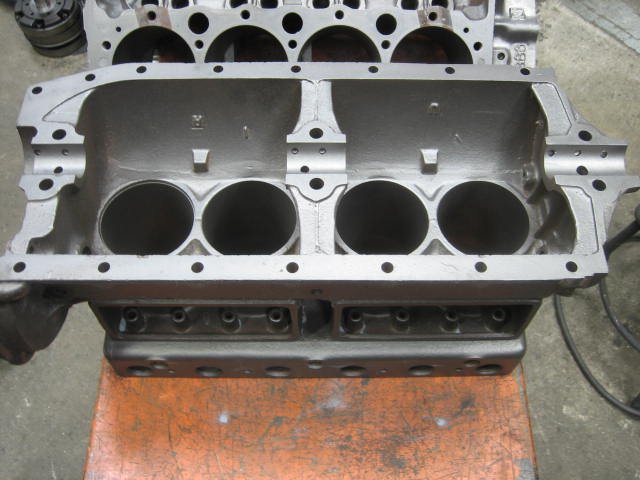

rebuilding a 1913 ,1915 and a 1925. Model T Hobby is alive and well around us.

Boy John, that block looks pretty pretty. Baked and peened?

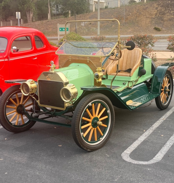

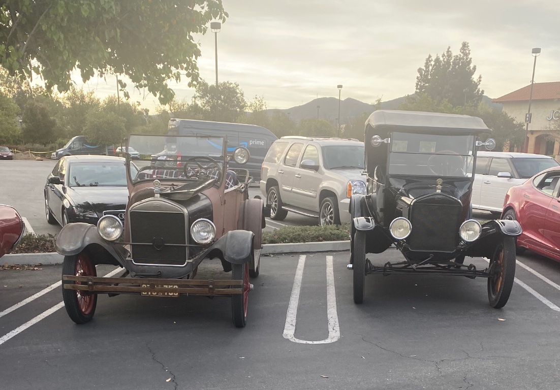

Model T’s representing at Conejo Valley Cars & Coffee this morning!

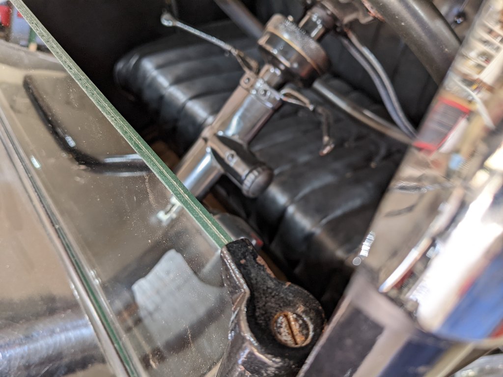

I reinstalled the windshields on my Runabout. A local shop cut and installed safety glass. My old glass was plate! That was my final must-do safety project. Now we can toodle without fear.

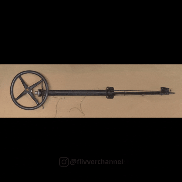

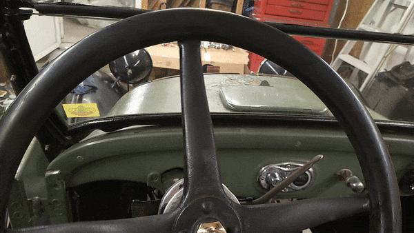

Re: What have you done on your Model T in March?
Post by Flivver » Mon Mar 21, 2022 6:30 pm
Overhaul the steering column.

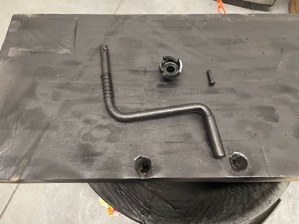

20. Using Blaster, freed up crank frozen handle grip so the hand grip turns n the crank.
21. Primed and painted hand grip gloss black.

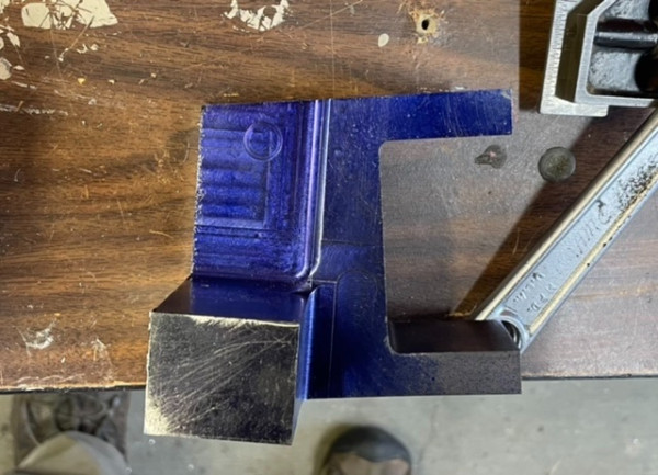

Post by Reno Speedster » Wed Mar 23, 2022 1:29 am

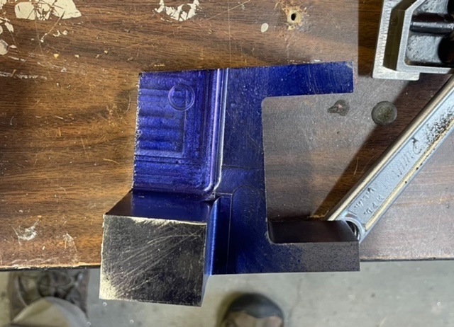

Making progress on the suspension for my 26 Speedster. Cut down and welded the prop shaft to fit my lowering brackets and the Muncie transmission. I am now working on modified rear radius rods to fit my lowering brackets and to drop them down slightly. I have also started in on the front lowering brackets. I am a nut and am cutting/milling them out of a block of 1018 steel. The hope is to get a rolling chassis by spring so I can take it to the DMV to get the bonded title going.
I also am working with the shop to get my Rajo B head rebuilt and ready to go on.
On top of that, I am making arrangements to get the 22 pickup shipped up. Busy month and more to come.
One of the front drop brackets fresh off the mill.

Post by Dallas Landers » Sun Mar 27, 2022 4:16 pm
After installing the Twin Hasslers , I needed to take a drive and see how it drives and rides. Both were fine. About 25 degrees today and windy and if you look close , you can see snow flakes in the photo. My wife rolled her eyes when I asked if she wanted to go for a ride. Dressed for success, I pulled the upper board from floor boards and it was pretty nice.

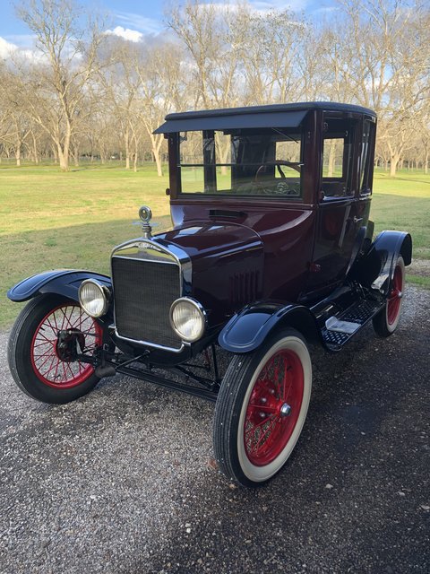

Post by MichaelPawelek » Sun Mar 27, 2022 8:49 pm
83F here today on the Texas Gulf Coast so just took the ‘25 Coupe out around the neighborhood. Was stopped twice and asked to take pictures with the T. Did a bit of educating two under 10 year old boys about Model T’s.
P.S.-Finally decided to take that huge monstrosity off the radiator and replace with something much smaller! :)

Post by mbowen » Wed Mar 30, 2022 9:41 pm
Bonnie’s front axle is DONE! The last thing today was setting the toe-in, and reinstalling and cotter pinning the two nuts that had to be loosened or removed to make that happen.
Before she can be driven I need to install the refurbished cylinder head, new fuel line, and fuel shutoff valve at the carburetor. I also have a hand crank cleaned up, painted and ready to install (the car came to me without one).
