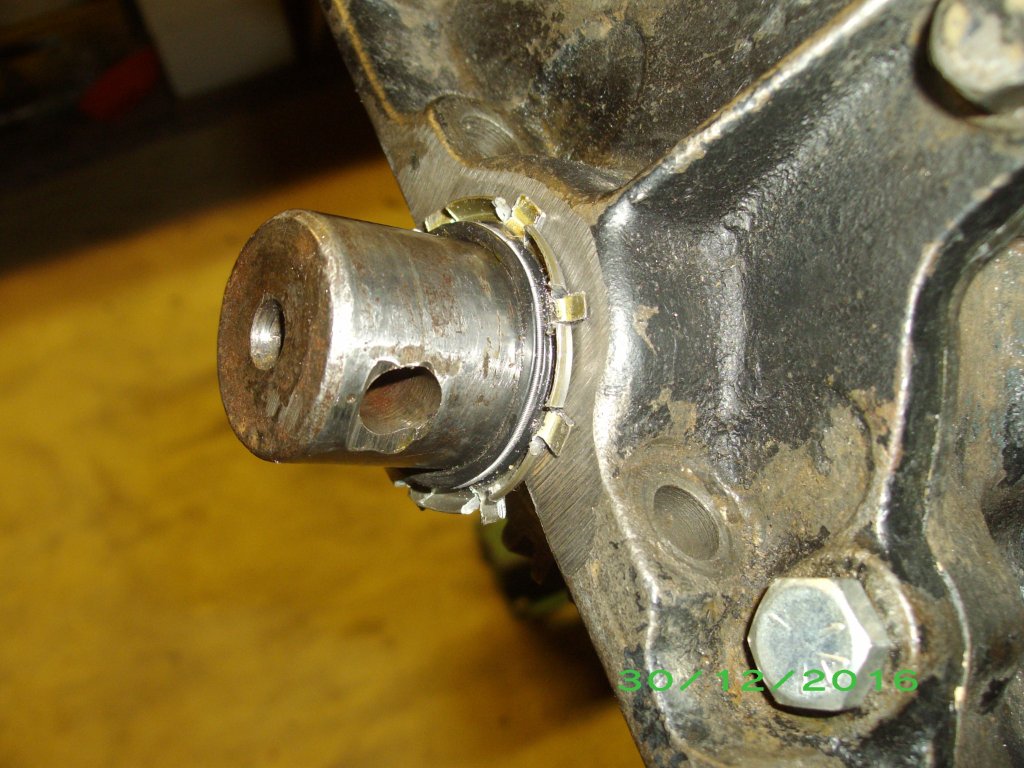

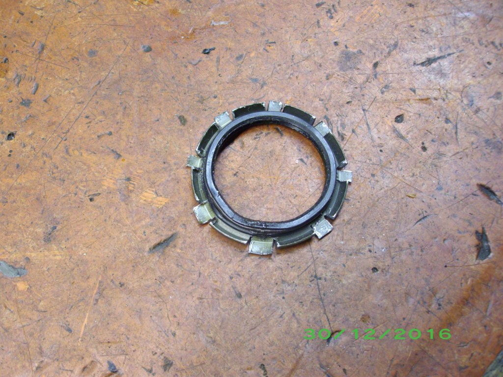

For a long time I use an oilseal for the crankshaft,.and glue them to the engine block and timing cover , with JB weld
And also the normal feld style seal .
Thanks to an Forum user .
