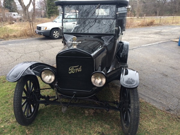

I want to silver solder a couple of mounting bolts to the back of the chrome-plated brass FORD script I bought to mount on my radiator. I'm planning on grinding off the chrome in the spots where I want the bolts and using a micro-torch to do the soldering. My question is, am I likely to discolor the chrome on the opposite side or have others done this with success?
Yes... I know chrome does not belong on a Model T but this is all I could find that came close to the nickle finish used on hubcaps, radiator neck and etc.

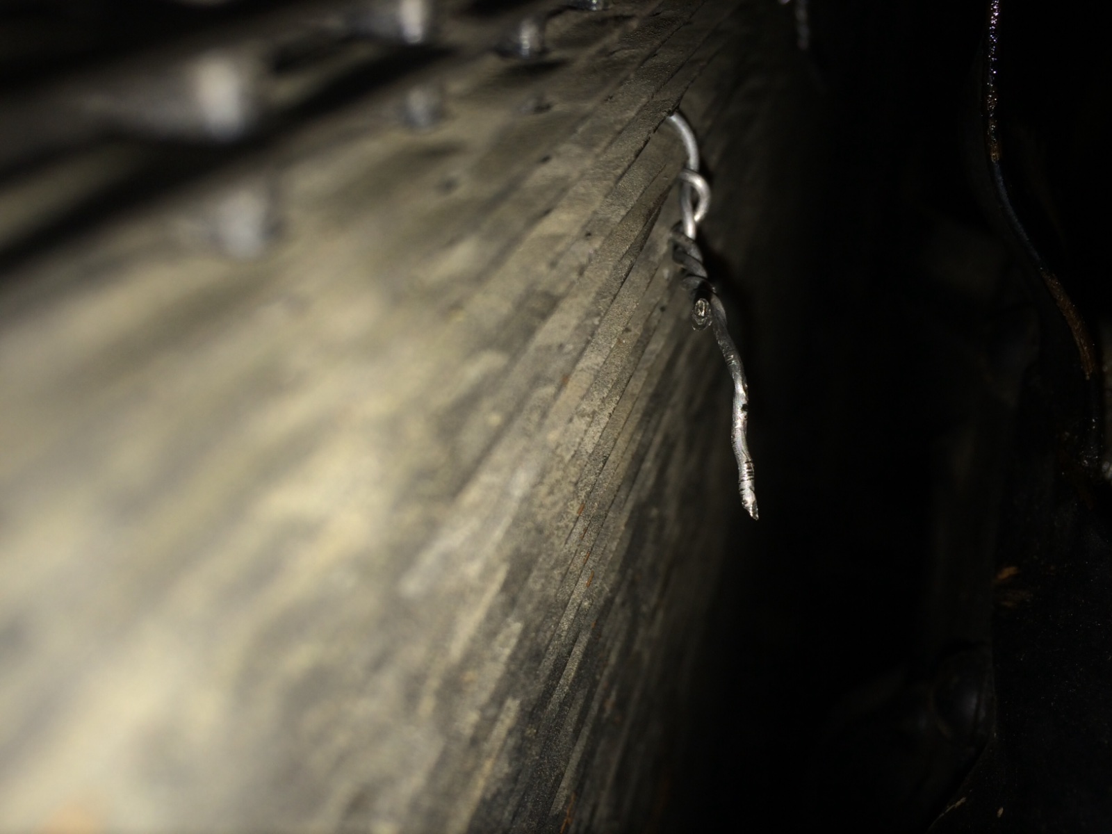

Tim, I just used stainless wire and looped it around between two letters on each side.
Then carefully slide the wire through the fins and twist it on the back side, then bend over away from the fan.

Tim, I attached my Ford script with .025” diameter annealed brass wire as per Ruxtel24 Dave. I used brass wire instead of stainless. (What I had on hand.) No need to solder. Stainless or brass wire your choice.

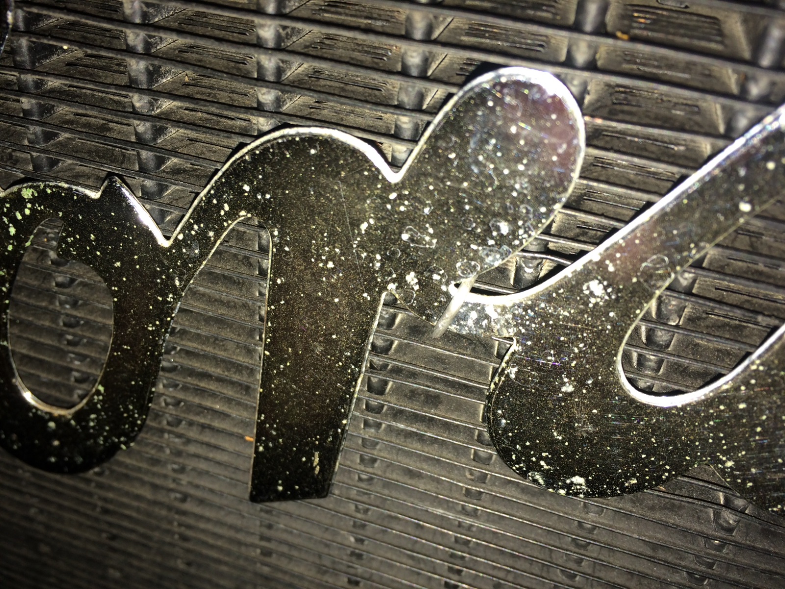

I literally just went thru this exercise and trust me, don’t silver solder it. I had an actual jeweler do the work and it discolored both the Ford script and the year. It was so bad that I bought a new plaques and started over.an expensive lesson. I then experimented on the destroyed ones and used plumbing solder and a good soldering iron with a large tip. It worked fine and no discoloring at all. The silver solder is unnecessary and takes far too much heat which causes the discoloring.
The other trick is to use plumbers flux and solder. There is acid in that VS regular solder and it lets the solder flow easily on bolt heads. Clean the heads of the long bolts really well with fine sandpaper or wire wheel. Burnish the back of the plaques with fine sandpaper, brush the flux on and you’re good to go. Using a stand the holds things in place is a must. Heat both parts together until the solder flows when touched to the parts and not the soldering iron and then stop. You’re done.

I had thought to use SS wire but when asked, Bergs radiator suggested against it. Said over time the wire might cut into a tube. If I use wire I’d probably try to run it thru a small plastic tube or...

I wouldn't worry too much about using stainless wire despite what Bergs says. If you have a original style round tube radiator you can easily space the stainless wire so it is no where near a tube. I have Ford script mounted that way for more than 40 years on an original radiator without a problem. I just check occaisionally to make sure it has not shifted from side to side but so far after many many miles and lots of vibration nothing has shifted.
- Posts: 4456
Re: Soldering chrome script
I use the wire. But, rather than just twisting the wires on the backside, I place a small maple stick on the back, situated vertically, to span many fins, and twist the wire over the stick. Doing that, prevents the wire from working into the fins, thus getting loose enough to rub the water tubes. As long as the wire is tight, there will be no motion and no rubbing on the water tubes.

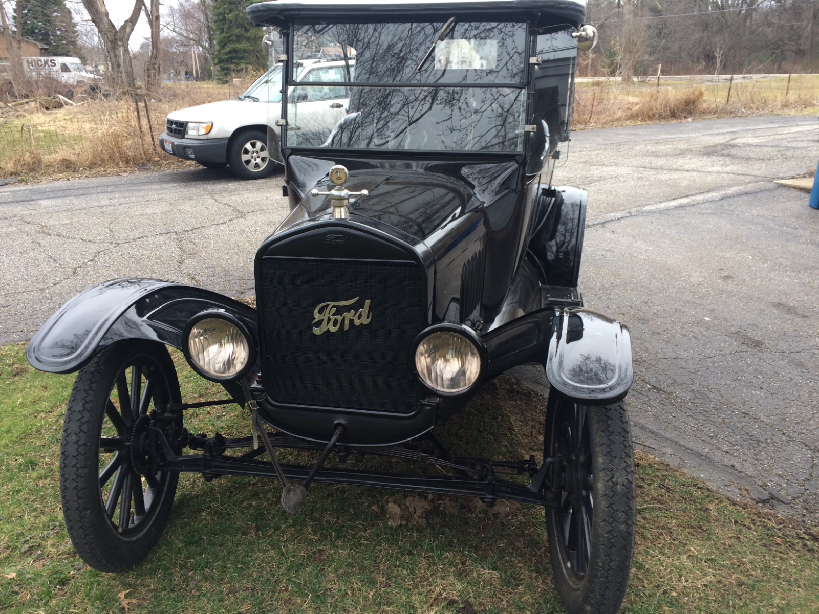

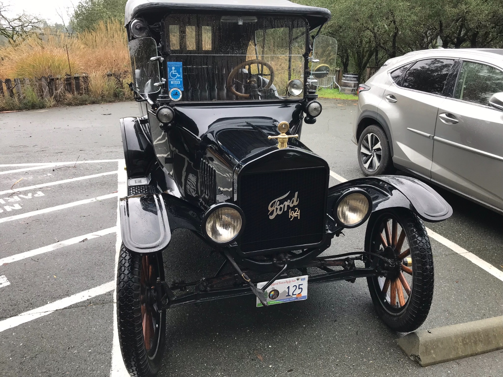

Another question - some install the "Ford" at an angle, others straight across. Historically is there any "right" or "accepted" way of doing this?

I like an angle and it's easier than trying to make it perfectly straight.
