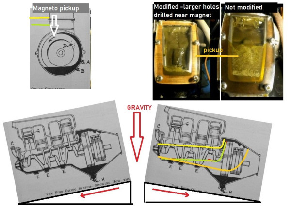

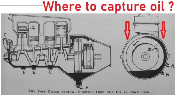

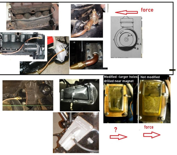

Lots of old discussions about about outside oil lines: types, pickup points and placement locations. There is no question that these can't hurt anything but what is the best setup and what do they rely on to work. The splash lubrication does have flow (dippers or magnets). I do see some issue on their effectiveness on steep grades BUT anything is better than nothing. Pictures open for discussion. There is a YouTube video showing a comparison of oil through the transmission oil filters, its about the only visual of oil movement in a running engine. https://www.youtube.com/watch?v=dXimnKoDPSI
Old image suggesting oil flow around hogshead. 2 o'clock may be most oil but 10 o'clock may provide the most push.
These are showing several different accessories and how they connect to the engine and what they depend on to function.
The image with the the transmission flow was a discussion about modifying the transmission filter. Just a consideration if use a outside oil line connected to the transmission inspection cover. --
Finally, just some thinking about how the oil would flow depending on an incline since the system is pumpless.
