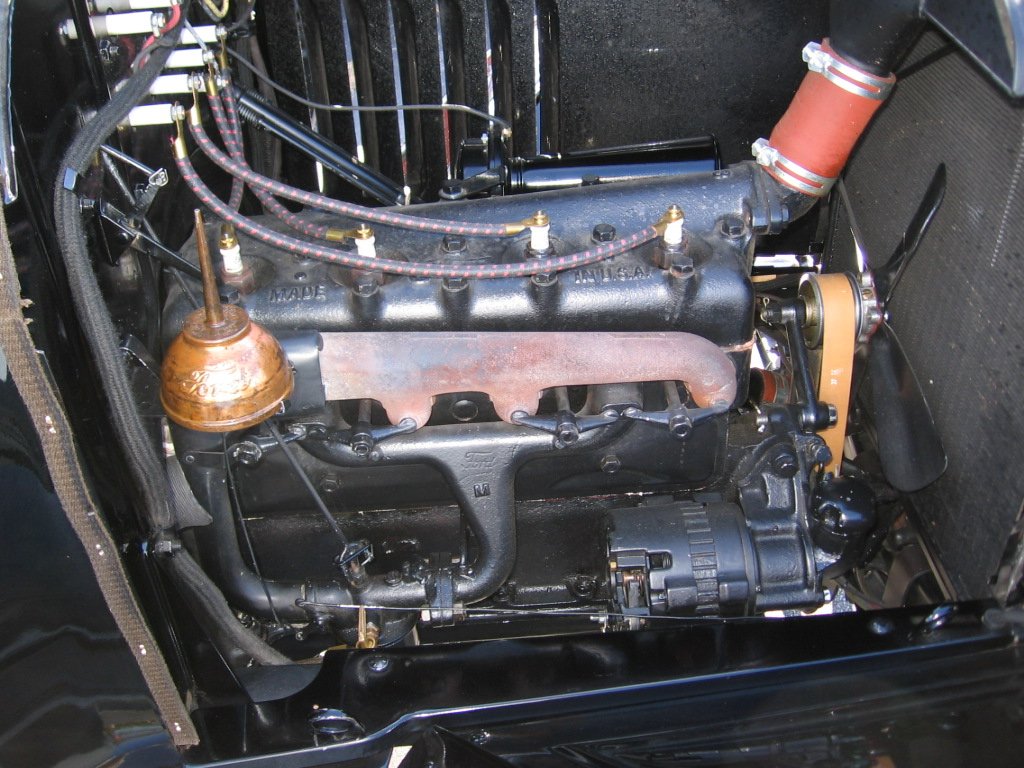

I wonder if the January 1924 engine in Betsy should have the later clamps. It came to me with the longer studs and the older style clamps.
Posts: 7264
Re: The manifold clamp controversy rages on.
Post by Allan » Mon Mar 07, 2022 6:00 pm
Mark, you're worried about the correct manifold clamps and studs and they sit above an alternator. :?: I don't understand. An alternator is a major departure from originality, so having the correct manifold clamps is hardly going to make the engine bay any more authentic.

Post by CudaMan » Mon Mar 07, 2022 9:02 pm
Guilty as charged! The car came to me with the alternator already installed.
I have a Ron Patterson freshly rebuilt generator and a Regan 6V negative ground voltage regulator on the shelf for the day when the 6V alternator dies.
Trouble is, the alternator refuses to die and it works great, it keeps the battery topped off without boiling the water out of it.
