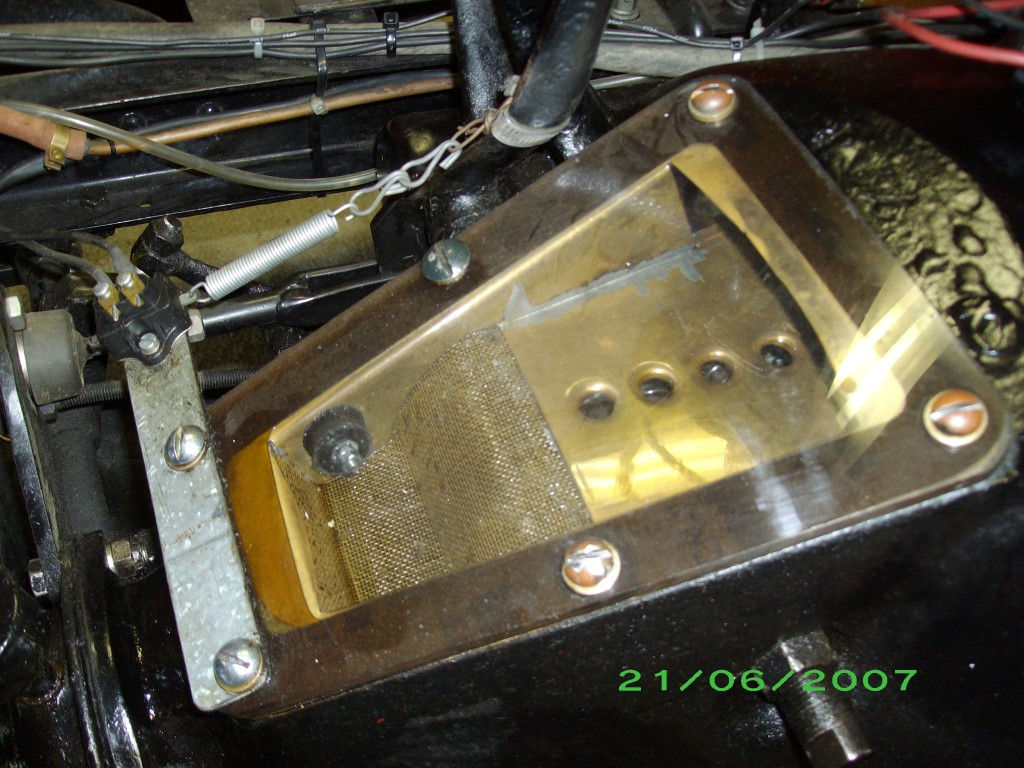

Here are some pictures to help ou see it fit into the transmission housing. Some suggest making the holes larger other not. Most all recommend strapping down the magnet, not sure where it would go even if if broke up but tht might be one a earlier design. This is a good pro/con like http://www.mtfca.com/discus/messages/50 ... 1437749776
The only difference in doing it before or after changing you oil is what is in the oil before you added it. AND be careful not to drop anything into the transmission, so move all screws, nuts washers, keys etc well away . If you drop something in, you must remove it before you can drive again.
This link shows the oil flow without the screen https://www.youtube.com/watch?v=JqW1g0x ... hw&index=1
This video shows side by side comparisons of modified vs stock screen. https://www.youtube.com/watch?v=dXimnKo ... hw&index=6 The holes on t he upper part of filter are over the transmission bands and that's where the oil needs to flow. The buildup in the stock version causes this as its the path of least resistance for the oil to flow other vs the screen. While the modified version appears to allow oil to flow into the holes it is likely less

After watching the 2nd video showing the amount of oil collecting in the in the oil screen, it might be worth tapping a line from the lower section of the cover plate to the front of the engine pan... a combination of the old faithful and Texas T oiling systems.

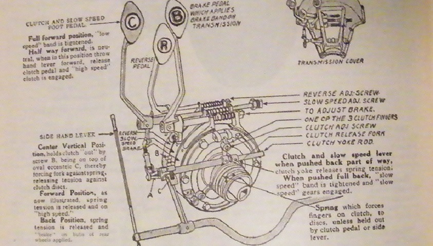

Thought I'd check in this evening with a status update. My '23 Touring does have an oil screen already installed. I cleaned it, which just involved wiping it down with a rag and re-installed. My friend who was helping me suggested putting a good magnet in the screen to pick up any stray metal fragments. Since any magnets I have lying around fall into the "not good" category, I'll add that to my shopping list.
We also checked the rear end oil level and it was very low. I added about half a bottle that just arrived from Lang's along with some other parts. I'll monitor for leaks, have a clean container under the rear.
Something was going on with the linkage between the high-low pedal and transmission. The little part that has a clevis on one end and then a 90 degree bend at the transmission end was well-worn so I ordered that as well. They sell the individual pieces that make up the linkage, so I guess if you want to save a whopping five bucks you can just order the part that looks more worn out and wait for the other part to wear out farther down the road. I bought the whole thing, it's secured with cotter pins at both ends. I just hope there isn't some strange adjustment I should be aware of when installing. Right now I have the pedal at the highest point of travel and that's how I'm installing the linkage.
Thanks again for all the help and suggestions.

Good instructions from Model T Ford Fix. Also a good reference for other solutions
https://modeltfordfix.com/adjusting-the ... nd-clutch/

There is a critical adjustment. If you dont have it already, order the T1 service manual. No T owner should be without it.

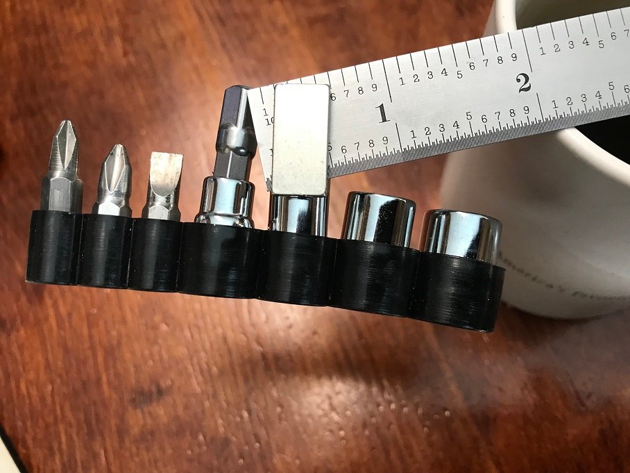

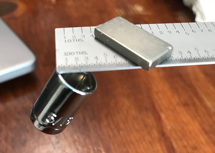

Gerrit - I would install a rare Earth magnet and never worry about it coming loose. You can google K&N magnetics. Don't go too big or you will never get it off the oil screen. If you have never used one of these magnets you will be amazed at how powerful they are. Buy the highest grade that they carry (the higher the number the higher the temperature they will handle).
To give you an idea of the magnet's strength, I bought a few 3/8" discs to try to find an imbalance in a flywheel (not a T) they would remain in place at 1,200 RPM. I did not need to go higher.

Great idea, likely will make the whole tray magnetic in the process. You can't pick the magnet of the ruler in the picture, you need to slide it off to an edge. Since a picture is worth a 1,000 words, just a little demo on how much strength these rare earth magnets have.
This is about how much the magnetic strength from a short distance. That's about the max weight at that point

I went to the store and got the strongest magnets they had. Round, about the size of a quarter. Definitely stronger than the magneto magnets I placed all three on the tranny lid. After a month I checked and nothing under the lid where the magnets are placed. The lid is steel. The magnetism from the magnets was neutralized or disbursed throught the steel lid.
At least it was a good test.
