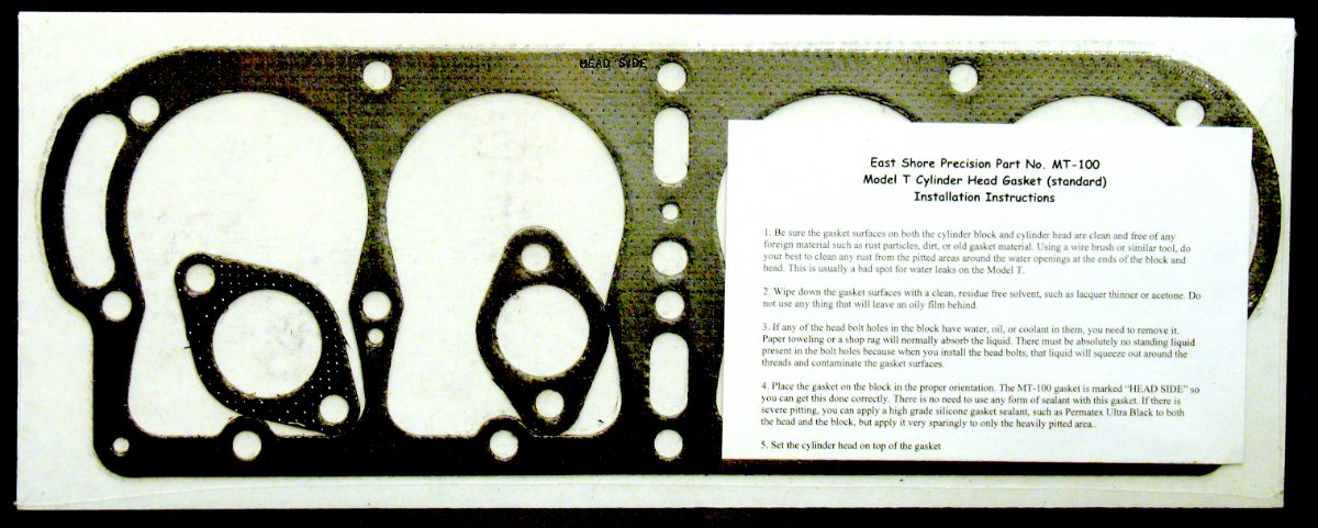

When Adam Doleshal finished my engine work he used one of these to put the head back on. He says they're excellent, and he uses them instead of copper.

Steve, I can't find a website for that company. Do you have contact info?Steve Jelf wrote: ↑Tue Mar 08, 2022 12:04 pmWhen Adam Doleshal finished my engine work he used one of these to put the head back on. He says they're excellent, and he uses them instead of copper.
I bought a couple from Adam. You can contact him through the forum. Go to the top of this page and click on Extra Quick links, then Search for members.
