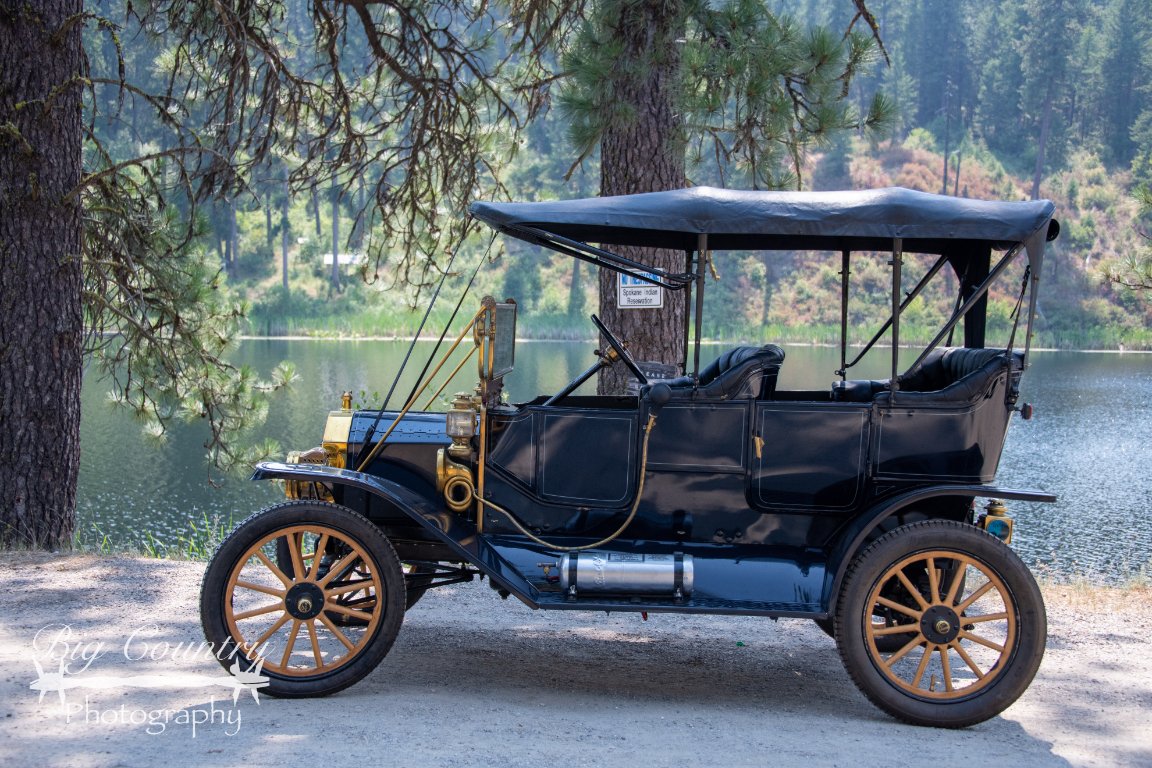

I've seen a couple of Scott Rosenthal's cars at the MTFCA museum here in Indiana. His color on his 1912 Town Car is really dark.
Mike
Mike

A friend of mine owns this 1912, and it is such a dark blue it does indeed look black. The fenders and running boards are black, so as you can see there is not a lot of contrast!

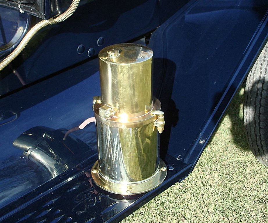

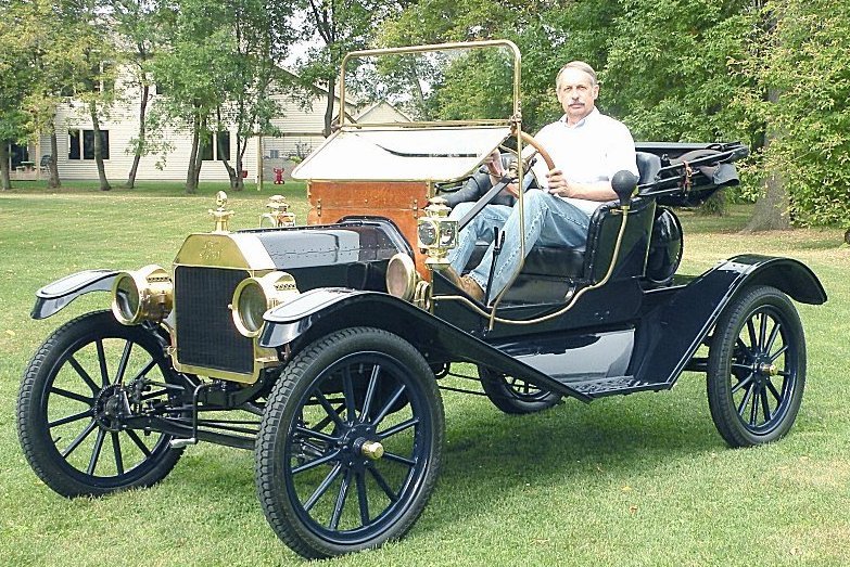

Below are a few photos showing my 1911 Open Runabout in various light conditions. My car was painted using a color code from 1985 Mercedes Benz which was called "Dark Blue" # DB-904. The color is a very deep blue in bright light and looks almost black in low light.
http://www.mtfca.com/discus/messages/118802/125711.html
http://www.mtfca.com/discus/messages/33 ... 1357355430

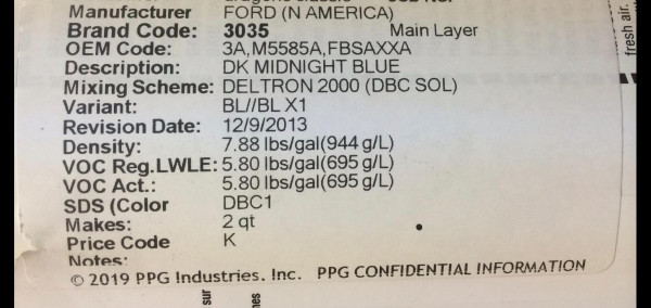

this is the formula for the PPG= Deltron 2000 blue, which is the Mercedes-Benz midnight bluel
The typed numbers are for (1) qt of base color. It mixes 1:1 with reducer for spray application. Apply over G-7 (almost black sealer)

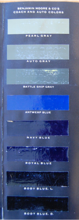

I would be interested to see what color that Benjamin Moore 1911-1913 body blue is. Any idea what year are those color chips were produced?
Though the DB904 makes for a very pretty blue car, I think the DB332 replicates the original color more closely. I chose the Diamont Uno 4635.
The picture file is labeled 1910.

The color chip sample board is certainly not from the year 1910 - I presume it is meant to represent colors used in 1910.Steve Jelf wrote: ↑Wed Mar 09, 2022 2:34 pmAny idea what year are those color chips were produced?

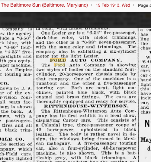

Re: Best blue for 1912, final question at the bottom!
We forget how fashionable Ford cars were in the early years, and that up to through mid 1913 they were very much abreast of the mainstream style trends. Consider Ford's November 1911 literature was showing the latest style of smooth-sided, fore-door bodies. Same thing for the 1911 Torpedos: totally stylish, rakish cars.
Ford doesn't really leave mainstream styling until logistical issues with mass production compel the issue from 1914 on, but by that time their cars are so successful that they essentially generate their own weather.
- Attachments
- 1913 Baltimore Sun Ford blue black color .png (293.33 KiB) Viewed 4862 times
