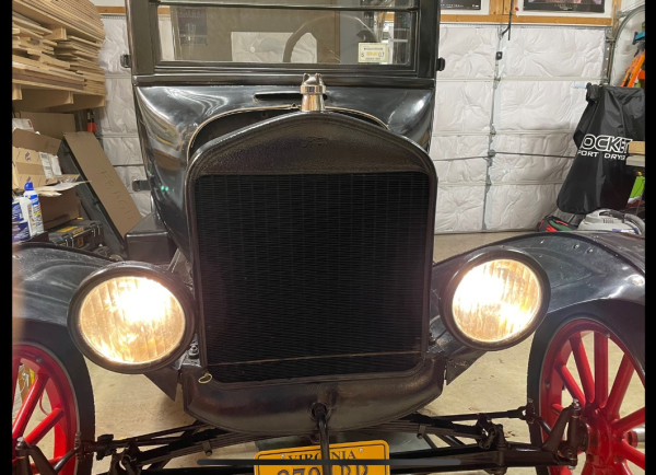

So I repainted my headlights and tail light and now they don’t work. Reading through the forums it is apparent I painted over the location where the light grounds. What I’m still unsure of is where exactly do I need to sand and remove paint to make the ground connections. I’m a visual learner If someone could post a picture of the location. The descriptions in the older posts weren’t clear to me. Thank you!

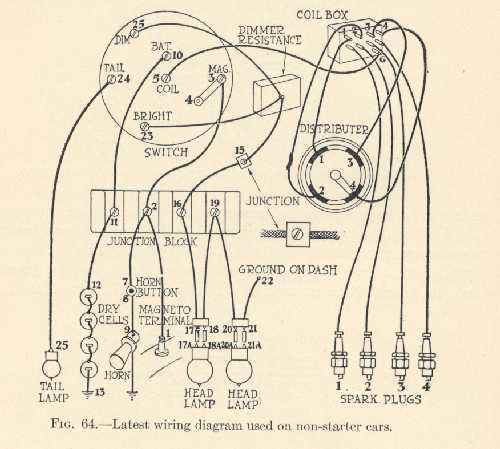

All depends on how your wired (year matters)
non-starter - with dimmer
If you headlights are connected in series (magneto bulbs) then one output wire from the light at the end of the run needs to be grounded. --

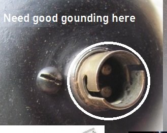

The socket is connected to to the headlight bucket via the hole in the bucket and the adjusting screw.
The headlight bucket itself is grounded via being bolted to the base of the fender support bracket. So do a continuity test to see if the bucket is grounded - once this is resolve then test if the outside of the socket while everything is connected to the car. next check continuity in the bulb (bottom bump to outside bulb shell

There are a dozen places that you can lose the ground-path. Bulb to socket. Socket to bucket's socket sleeve, or between that socket sleeve and the bucket itself (I have found several of those that have failed over the years!). Ground may or may not reroute through the adjusting screw and spring?
Then between the bucket itself and the mounting post (happens fairly often!).
When painting, almost anything in the ground path might not make contact. Between the mounting post and the fender bracket is one of the most common places to lose ground-path. Between the fender bracket an the frame is another place that ground path is often lost. Sometimes ground might find another route through the fender? Or it may not.
Sometimes, just putting good sharp lock washers between the bolts, nuts, fender brackets and frame can restore reliable ground. One of my cars a few years ago, even a shim and a lock washer on the mounting post to fender bracket would not hold ground reliably. I did enough testing to determine that was the spot the ground was not holding, so I found a modern wheel lug-nut with the tapered end? I replaced the proper castle nut and cotter pin along with the added lock washer that wasn't adequate with the tapered lug-nut biting into the underside of the fender bracket. Just so they would match, I did the other side the same way.

if everything else is clean and tight, you might consider soldering a wire between the bulb socket and the lamp body. I bare off one of the rivet heads and solder to that. This provides a solid ground between the two components, bypassing any paint/corrosion/loose fit which may lead to a poor ground.

Dan Treace had an article in the MTFCI Model T Times about grounding a headlight socket internally. He soldered a small islet to a wire, attached it to the socket adusting screw inside the headlight with the other end going to another point inside the headlight. - I added a small machine screw to the bucket with a nut on the inside to connect the other end of the wire. You should also make sure there is a good ground between the socket in the frame and the rod that attaches the headlight to it.

It is common to loose the ground after extensive painting that leaves no bare metal. I have seen this occur after the engine has been completely painted, losing the ground between the engine and the chassis where the main ground is attached to the battery.
If the loss of ground is between the painted bucket attachment brackets and the fender, you can achieve a hidden ground by filing the paint smooth down to the steel inside the fender holes and inside the square bucket attachment bracket holes, so the bare threaded shaft of the bolt completes the connection. This is also useful where protective rubber pads are installed between the fender and the bucket attachment brackets, like on the ‘26 and ‘27’s. Jim Patrick
