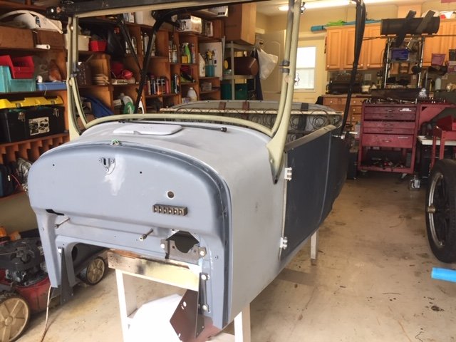

front body to frame mounts were removed does anyone have replacements or a drawing to fabricate from? Thanks for your help

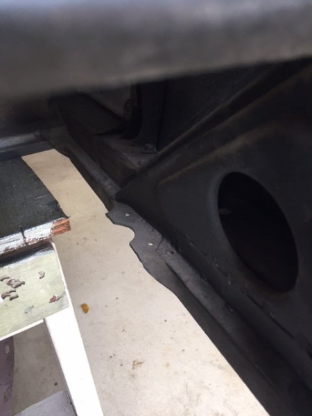

Post by DanTreace » Fri Mar 11, 2022 2:07 pm

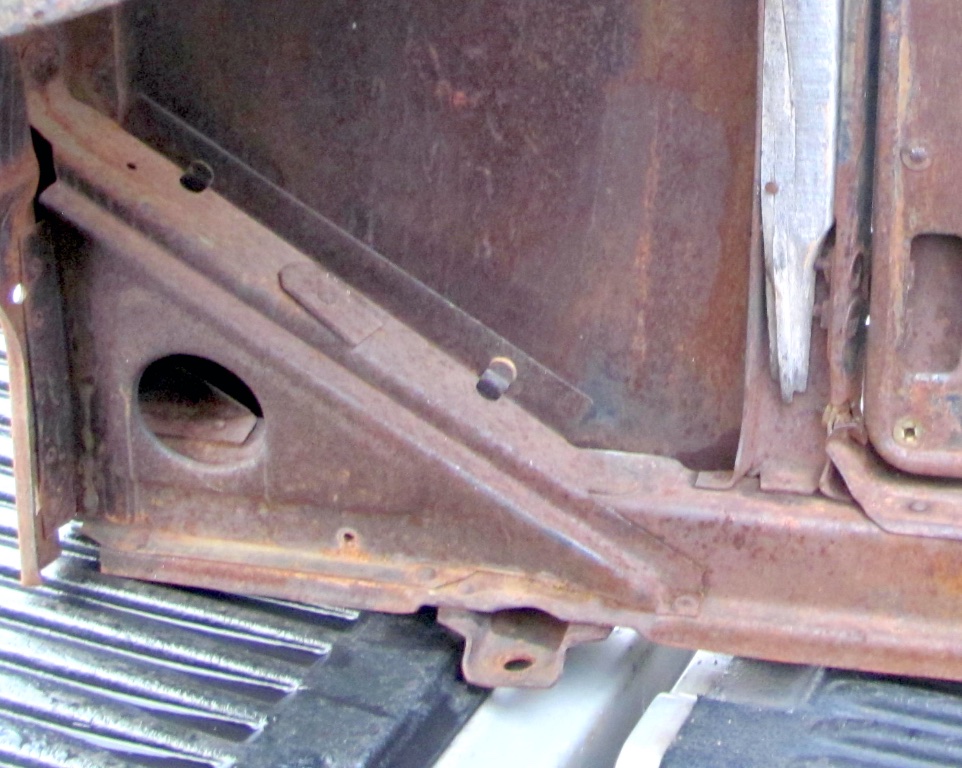

Haven't a drawing or part replacement, but here is a pic of what that front frame mount looks like.

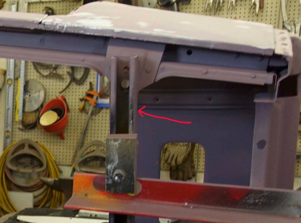

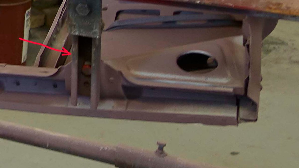

Here is a much-enlarged shot of the brackets in question. The photos are hampered by a metal channel used to support the body when it was on the rotisserie. The metal channel is marked by the red arrow.

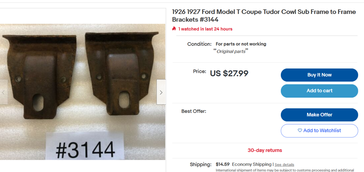

Dave Foley wrote:
Fri Mar 11, 2022 1:43 pm
Are these what you need - recently listed on eBay so Hurry - seller is a good guy will take a reasonable offer - From Canada
https://www.ebay.com/itm/284699164209?h ... 8A&vxp=mtr
Posts: 6799
Re: 26 t front body to frame mount missing
Post by Scott_Conger » Sun Mar 13, 2022 4:20 pm
and there they are, on a silver platter
