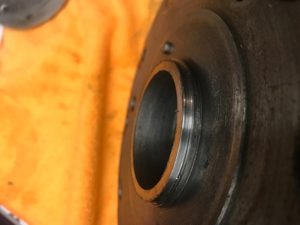

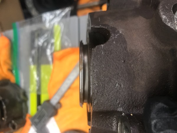

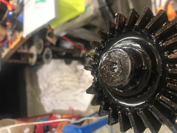

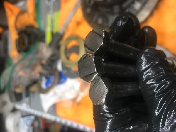

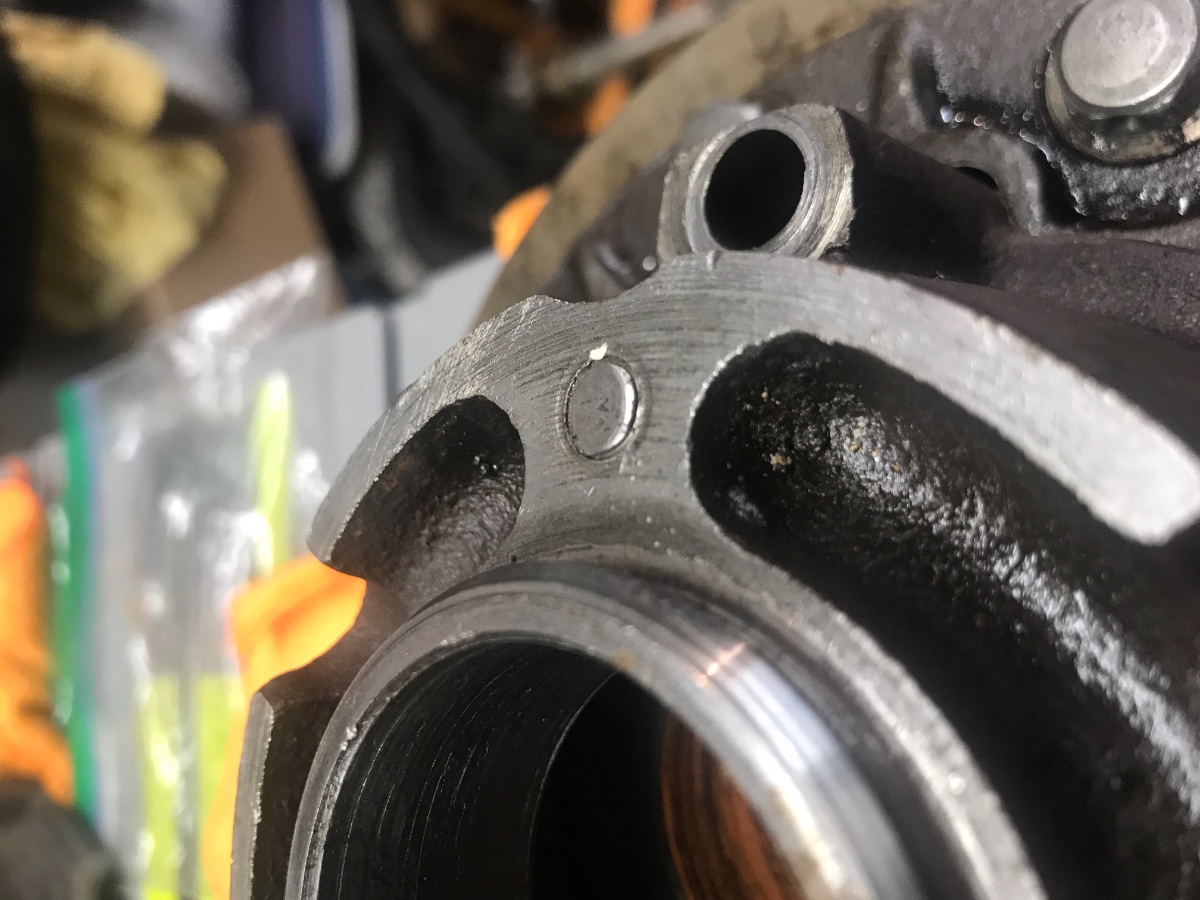

Call me crazy but I think she's TOAST. The differential bolts have more steps carved in them than a stair master, 3 of the six thrust pins sheared off and a broken axel gear tooth.........so much for just swapping thrust washers. On the bright side, the Hyatt bearings are perfect and there's only half a thou wear in the axel shaft bearing surfaces. But the thing that really grinds on me is that when I split it, I came to realize that it had been split at least once semi recently. Why you ask? Because there was one bronze thrust washer AND one flipping Babbitt. I fully understand doing things on a budget but if someone went through the trouble to split the darn thing once why didn't they spend the extra money ( probably no more than $7 at the time) and replace BOTH of the freekin things? Some things never cease to amaze me. I don't think much of the differential housing can be salvaged from this one so it will eventually be fully rebuilt.
