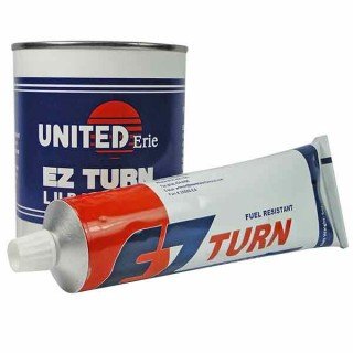

After you do some lapping as suggested above you need some of this. I did get it from one of the T vendors but not sure which one.
EZ Turn is a specialty lubricant/sealant used for fuel and oil line valves & is resistant to high temps. Especially effective where high octane fuels and aromatics are present. EZ Turn is also extremely efficient as a gasket paste & anti-seize agent. EZ Turn will not gum, crack or dry out. Each shipment is independently tested. Excellent for tapered plug valves, aircraft engine manufacturing, and marine applications. EZ Turn is the functional equivalent of fuel lube.

Use E-Z Turn sparingly on petcocks or small orfices as it's tenacity can partially block or block off small passages.

Seems the sediment bulb can often be "weepy" without leaking enough to drip. From the fitting soldered and riveted to the tank, to the sediment bulb threads, the shut-off valve and finally the drain petcock, all in turn need to be fitted to avoid leakage. I may be wrong, but I believe modern gasoline is a bit harder to contain than what we were using 40-50 years ago. It's not uncommon to find that even a brand-new petcock may "weep", and can be improved by lapping. E-Z Turn is great stuff that keeps valves in the fuel line . . . well, easy to turn !

I will try EZ Turn. I just ordered a tube from Langs.

I replaced the sediment bowl petcock today using Easy Turn. So far so good. No leaks. Thanks Chris for the Easy Turn suggestion and thanks to all you other guys for the suggestions and comments.
