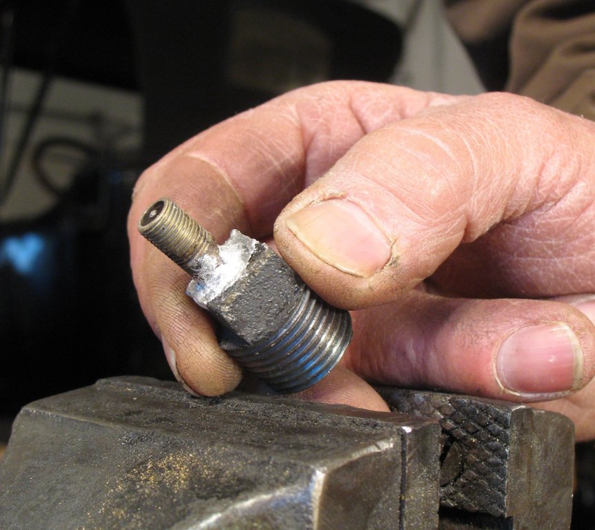

Most of today's compression testers are made for today's higher compression engines and have a 300 psi scale. For a Model T a 100 psi gauge is better.
You will also need an adapter with ½" pipe thread. I used a valve stem on this one, but for a compression tester I soldered in a bit of tubing that would clamp into the tester hose.
With all spark plugs out maybe you will be able to "spin" the engine fast enough to get a valid test.
