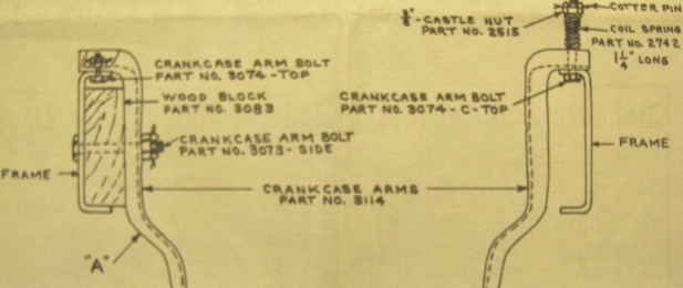

A long number of years ago I remember the late great Ted Aschman had a hint about replacing the mounting blocks on the oil pan ears with springs. I did this on my 22 center door and it worked very well, but that car is long gone to Ron Kipling and then from his estate on to others. I looked in my copies of Ted's Tinkerin Tips(both volumes) and in my Vintage Ford on CD and can't find the reference. Can't remember which T springs(valve, wishbone socket, radiator ?) were used for this. Does anyone know which volume of VF this was in. Want to use it in my 1919 roadster build.
Thanks Jim

Wish bone & radiator are the same spring. Thats the ones to use. I do the same upper pan ear mount.

Thanks John, as I remember now that you jogged me, it was the radiator setup so you could adjust from above. Wish someone would reprint Ted's works there was a lot of info that I have long forgotten contained in them, every time I pick them up.

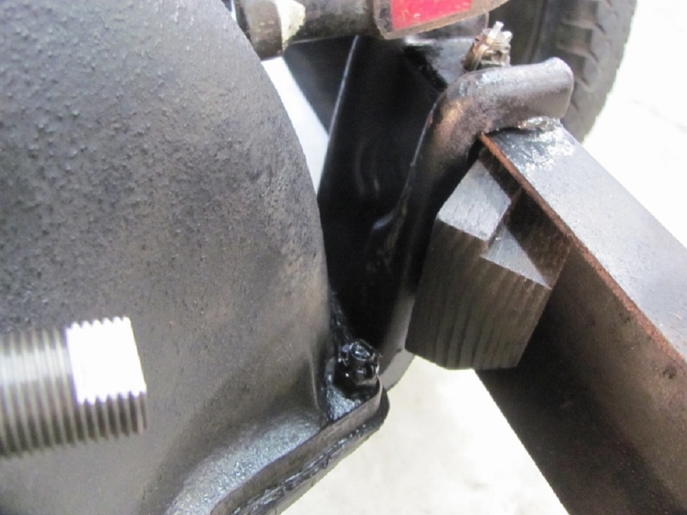

Haven't used another system other than the Ford wood blocks and proper bolts to secure the top flange and the long bolt to keep the ear from spreading.....but if you want to re-engineer Henry, here is a sketch.
Ford way....

I think the idea is to prevent broken pan ears. The horizontal bolts are pinned loose & the top bolts get tight & pinned per stock. Using the spring on the top bolt takes out the rigidness. The spring makes a snug, but not tight attachment allowing for some flex. On the roads we drive today, it probably makes no difference.
