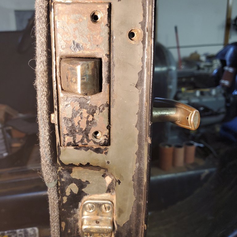

More pictures would help of the open door, the sill area it butts up to, the edges of the door and he column it latches to. JimPatrick

Post by pron022020 » Fri Mar 18, 2022 10:24 am

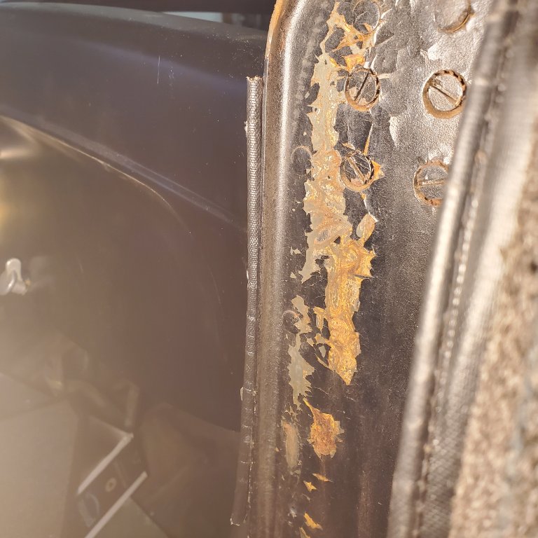

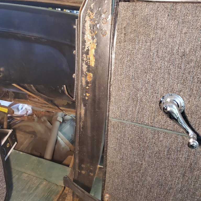

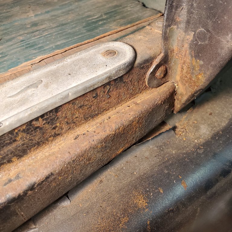

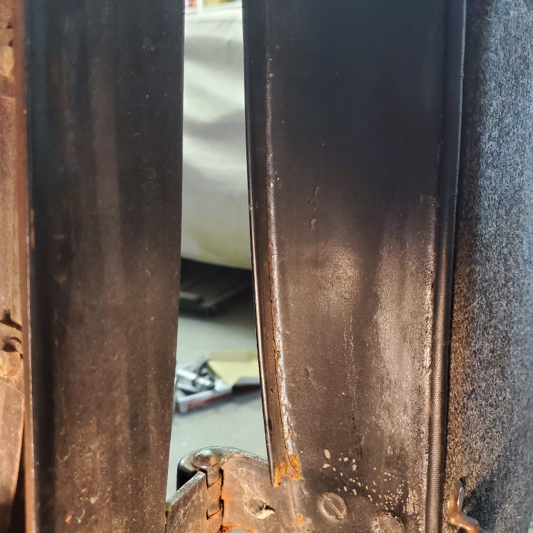

Here are some more pics. The door closed fine before the new upholstery and welting.

The welting may be larger that the original. The fact that the problem started after the new installation is telling.

The Carter’s cut and cover upholstery kit I used to upholster my ‘26 coupe had no welting. Has anyone else had welting come with your Model T upholstery? I thought welting was first used on Model A’s. If the door closed before upholstering, there lies your problem. Your upholstery and welting may be getting in the way of the door properly seating. Jim Patrick

Well the interesting thing is I took the welting off and it made no difference. And by welting I mean the stuff on the inside of the door that seals to the cowl. The windlace on the other side makes no difference. My vote is on the door panel but it doesn't make sense that I am having trouble with it now when the old upholstery was about just as thick?

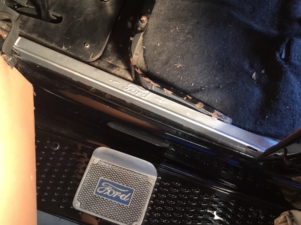

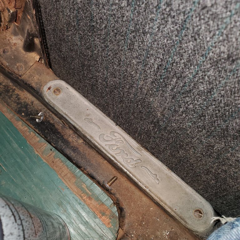

My 1926 coupe has a different sill plate than yours. It goes all the way across the sill from front to back and is held in place by several tabs that fit into slots at the base of the sill. If your has the slots, you may have the wrong plate on your sill, but it may not make a difference. I don’t think you can get original sills like mine for it was a very thin sheet metal part that was one of the first things to wear out, and are probably very hard to get. If yours does not have the slots, then perhaps Ford changed the sill plates in 1927. Lang’s says your sill plate is for a Model A, but, again, it may have been carried over from the 1927 Model T to the 1928 Model A. Jim Patrick

There were at least 3 different sill plates used during 26-27 coupe production.
