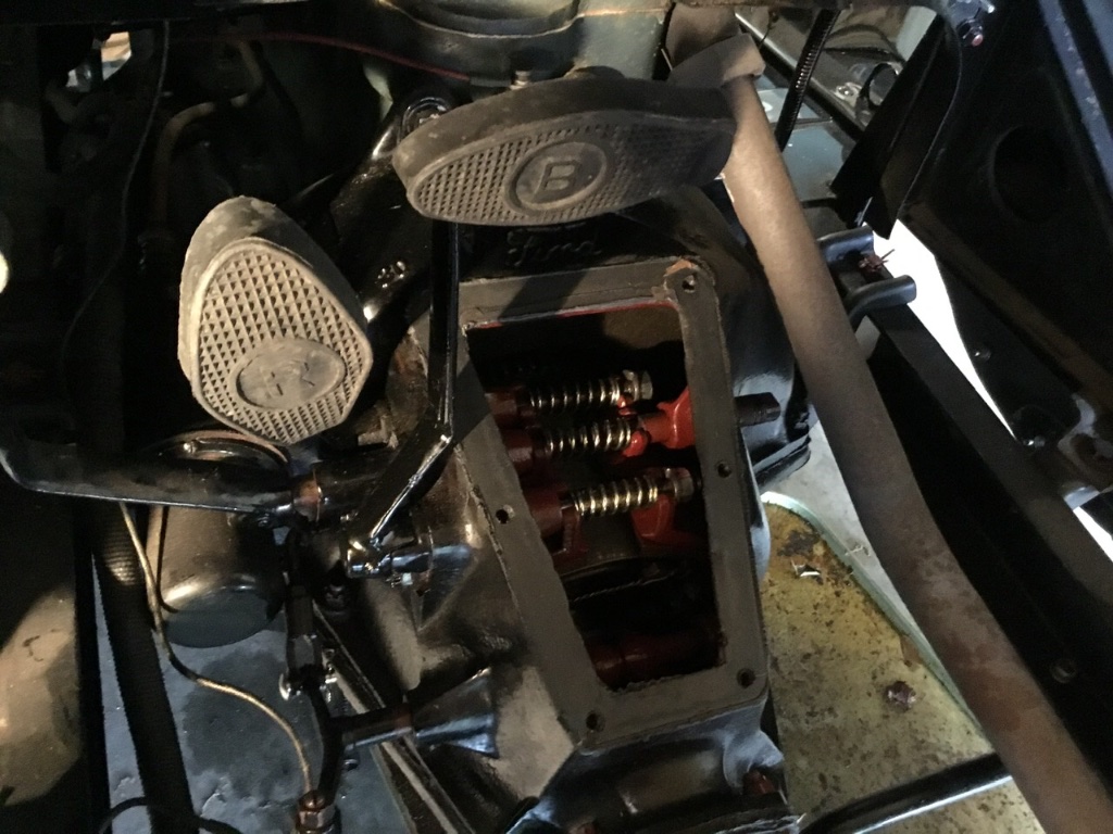

When I installed my Guinn wood bands, I installed them with the engine out of the car and the hogshead off and made sure the bands were perfectly round before carefully sliding them onto the drums so, the bands being out of round and causing drag is not a factor in this instance. Jim Patrick
