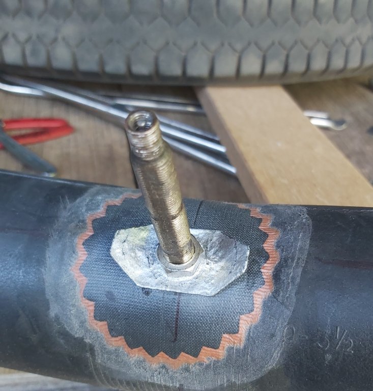

This is a legendary Olympic butyl rubber tube. These hold air! This one had the rubber valve stem torn off. It had been replaced with a stick-on rubber stem which was too short and had let go again on one side where the glue had not cured as it should.

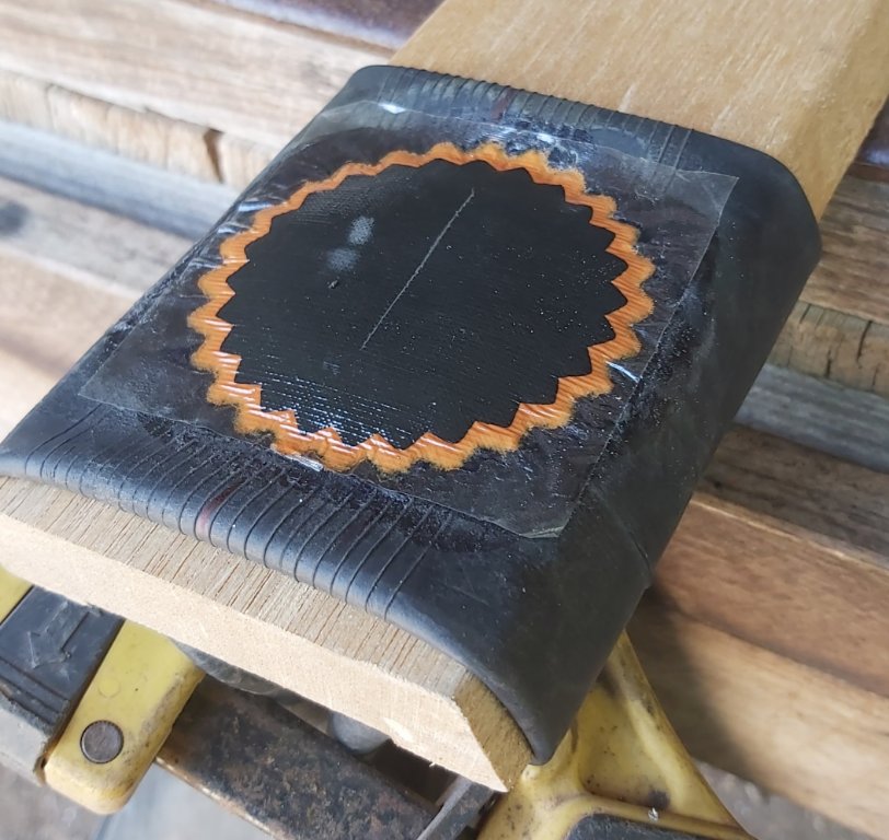

I carefully removed all traces of the replacement stem and applied this thick truck tube puncture patch.
Then I installed a Schraeder 777 stem . The thickness of the puncture patch and it's wide footprint means there is plenty of rubber to clamp on and the stem has a nice wide foot.
I hope it works out. These tubes are worth the effort and I like a challenge. I even got all the photos to post, just out of sequence.
