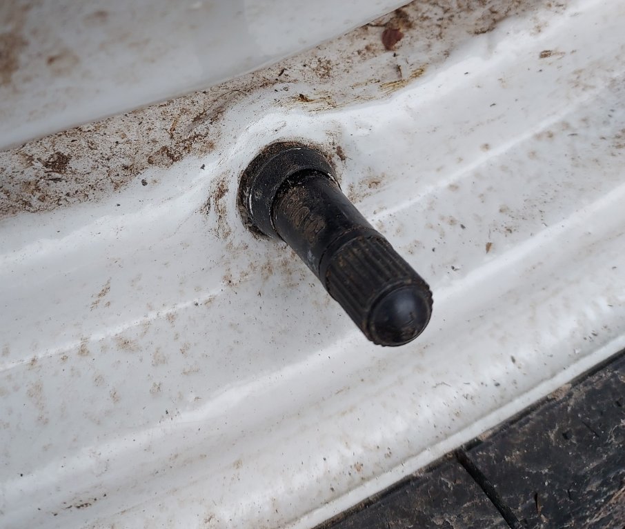

My local agriculture tire shop uses plastic bushings to protect the tube stem when the wheel stem hole is sharp or oversize from decades of rusting. Bushings are not needed for a steel wheel in good shape, so if your steel wheel stem hole is not rusted away leaving a sharp edge or oversize opening you do not need them, and if you are using metal stem tubes you will not need them.
This is a stem bushing on my tractor wheel.
