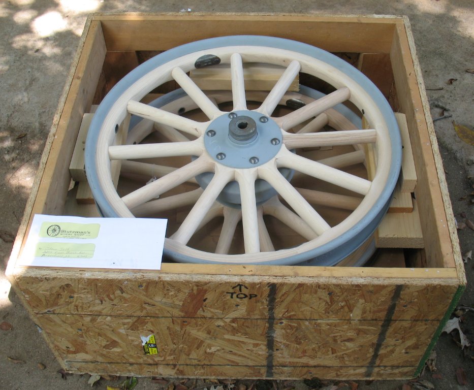

I only needed three wheels, so I made a box to hold three completed wheels and sent the metal parts to Noah Stutzman in it. I supplied all the metal parts except the tubing he installed for the valve stem holes. The box was made of particle board and 1 x 4 boards. I believe I sent it by Fedex and he returned it by UPS. No problems either way, but I think Fedex cost less. The gray primer was a big mistake. After the wheels were painted you could see the least little nick or scratch (as from mounting tires) from twenty feet away. If I have any more wheels made I'll use black primer or a primerless black paint.

When I had a set of wheels redone by Johnson’s wood wheels in Oklahoma the wood box container he shipped them in was super sturdy and really nice. The wheels were very nicely done and balanced.
They were shipped by UPS at the time and arrived OK.

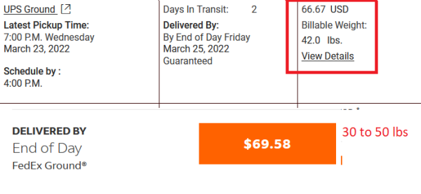

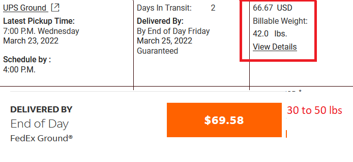

I thought I do the math. I have accounts with all three.

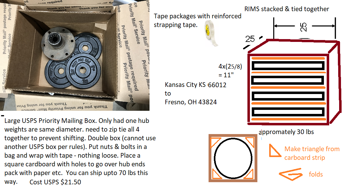

Usually better to condense the heavy smaller items in one shipment and the large lighter in its own. I used the repecive shippers online shipment calculators. Extra charges for additional insurance over their respective defaults. I have shipped wire wheels before, the total for 2 to a box was a lot less than shipping 4 and much less if a pallet was needed.
Shipping the hubs in a USPS Large Priority Mailing box (box is free at the post office and you need there's for this cost) $21.50 (might be more tomorrow). The rims shipped separately with - can get a box 24 x 24 and cut it down should work and is available most Home Improvement or Office supply stores for about $5. Shipping it USPS Priority mail from KCity to Ohio calculated at $45.85
So Total not counting the box $67.35 + more insurance
Did UPS & FedEX below - you could but a box with the hubs in it inside the rim box and ship for the same amount 50 lbs is their cut off for the box size before the price jumps. I weighed a rim an 7lbs did not do the hub. FedEX provides a higher insurance default.
If it were me, because of splitting the weight (less changes of broken box), I would do USPS
