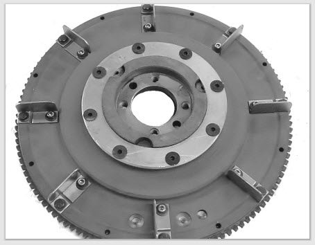

Joe- not sure what style slingers you are using but, these will certainly clear the pump. Also, retapping to 1/4-28 will work.

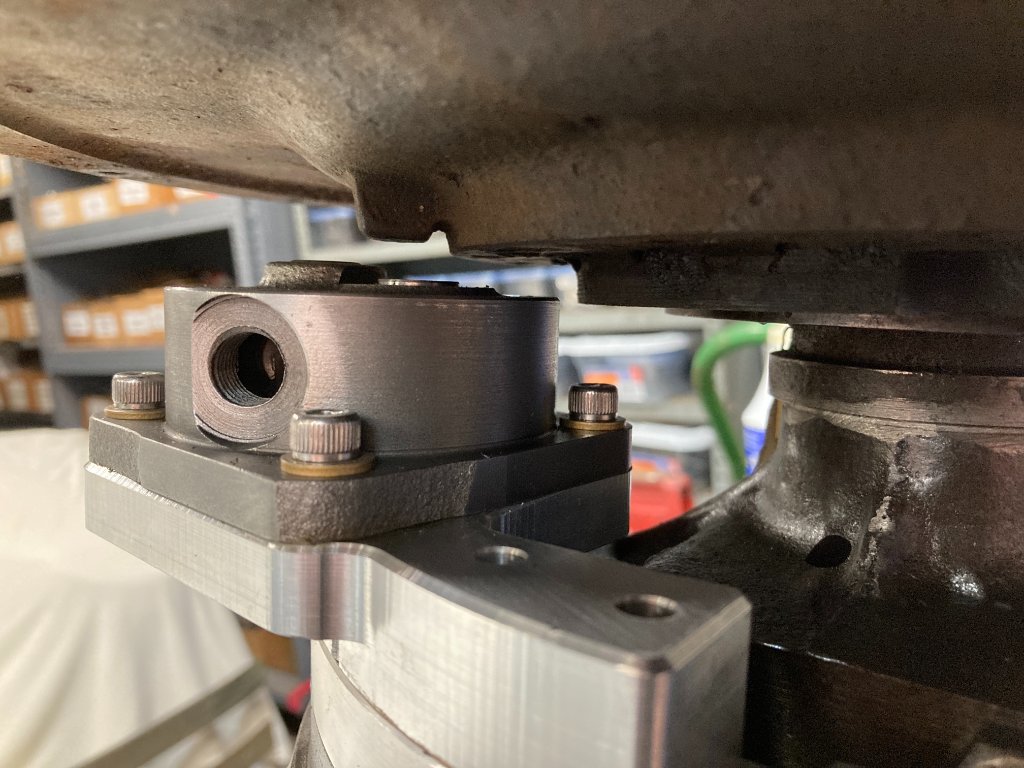

Post by henryford2 » Fri Mar 25, 2022 7:21 am
Yes, your style slingers will clear the pump, hoping the triple gear retaining plate does, what size mounting bolts are you using for the slingers? I've retapped an original #14-24 threaded gear for 1/4"-28 but not a new 1/4"-24 one. Thanks, Joe
