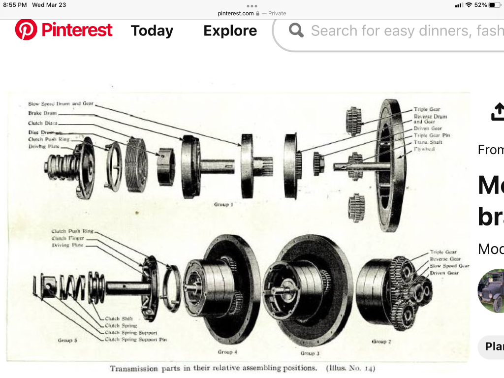

Can the flywheel be removed from transmission without dissasembly of trans?

No, everything builds on the flywheel.

You can remove as a unit & replace/remove the magnets without tearing down the transmission.

Yes. You can just lift the transmission off the flywheel. If you plan on putting it back together make note of which triple gear goes where so they are not mixed up. You do not need slingers. Just install new spools and they will stir up the oil sufficiently to lubricate the engine.

The transmission will not just lift off the flywheel. The output plate must be removed to get to the clutch hub. Hub needs to be pulled & woodruff key removed. Then drum pack can be removed.
It would be interesting to see how much oil spools only move comparatively. No personal experience here. Oil needs to be slung around to saturate the transmission & get oil into the internal funnel to the motor front. Part of the field coil function directs oil into the internal funnel.

I would disassemble the transmission. After the transmission is removed from the flywheel, it only requires the driven gear be removed to complete the disassembly This does take a substantial puller.
When I rebuilt my engine, I thought about not disassembling, the transmission but glad I did take it apart.. The reverse drum was cracked. And, I replaced the worn bushings.

The transmission shaft goes through from the front (magnet side) of the flywheel. How in the cornbread he!!— that’s when one gets a bit of cornbread stuck in their wind pipe and start’s coughing— can you remove the transmission from the flywheel without disassembling the transmission?

As I mentioned previously, The drive plate 6 bolts must be removed, the center clutch hub pulled, woodruff key removed, Then the center shaft can be slid out & drum pack loose to be lifted off with the trpple gears.

You are correct. The transmission must be disassembled to remove it from the fly wheel. The center shaft locks it all together.
There must have been some editing. Wasnt the original question about removing the magnets without disassembling the transmission?

There is two steps to disassemble the transmission. First remove the transmission from the flywheel as mentioned above. This requires a puller. Next, to complete the transmission disassembly, the driven gear must be removed by using another puller. I don't understand the confusion

Your procedure is correct to remove the transmission from the flywheel. This involves partial transmission disassembly. I am recommending that the transmission be totally disassembled in order to inspect the drums and bushings.

I would agree. You got it torn down that far, go all the way & do a full inspection. Check drums for cracks & bushing wear.
