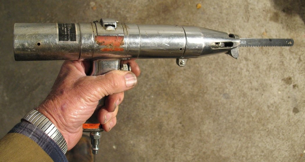

I didn't remove my radiator before trying to replace my worn sleeve. I now have a new Brassworks radiator because of that decision. I tried using threaded rod with washers and nuts to press the sleeve out. I could only move it a little bit. The good news was that I had a Sawzall bit that fit into the hole and I cut a kerf. Driving the new sleeve in took a really big hammer.

The easy way to remove the old bushing is with a saw blade. A saws all or a hacksaw blade in a handle.(mini hacksaw) Make the cut about 3/8-1/2" from the split. Cut thru 90% & collapse it.

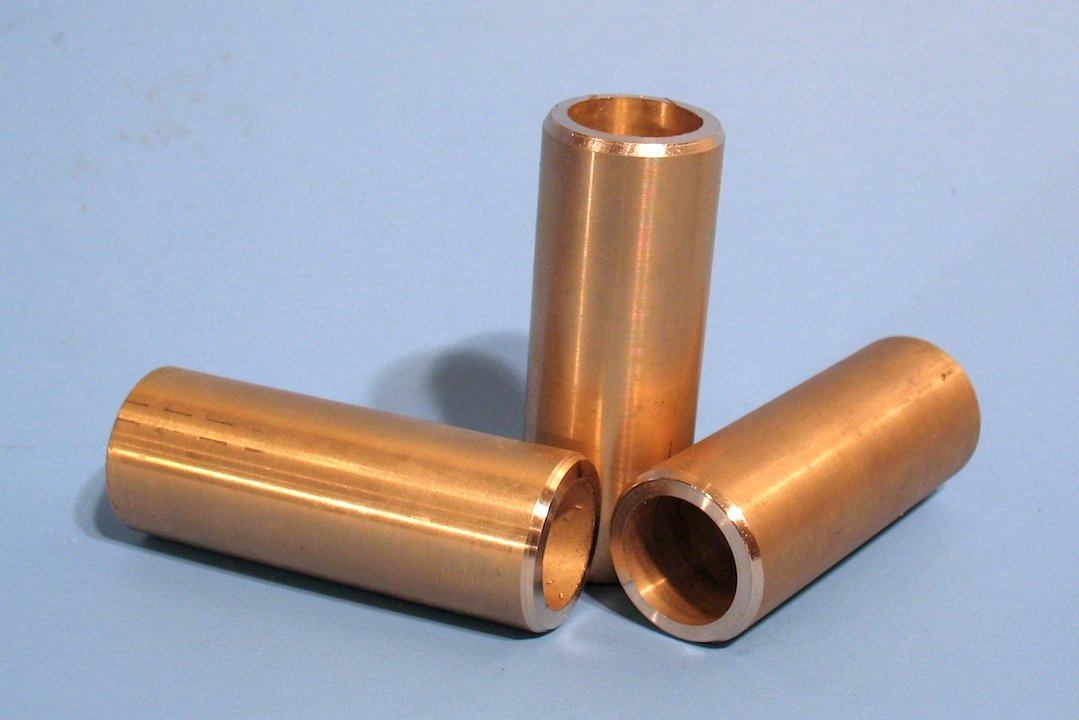

A bronze bushing would be easier for the more average guy for the proper fit in theory. I dont have experience with bronze.

Even the stock bronze bushing from a bearing house can be a very tight fit. The pan noses seem to vary a bit. I use a bronze bush on a crank handle which has had a new bit of 3/4" shaft welded on to get around wear in the old shaft. I custom turn down the OD of the new bronze bush, so it is a firm tap-in fit. A little Loctite helps. Once done, I have never had to touch it again.

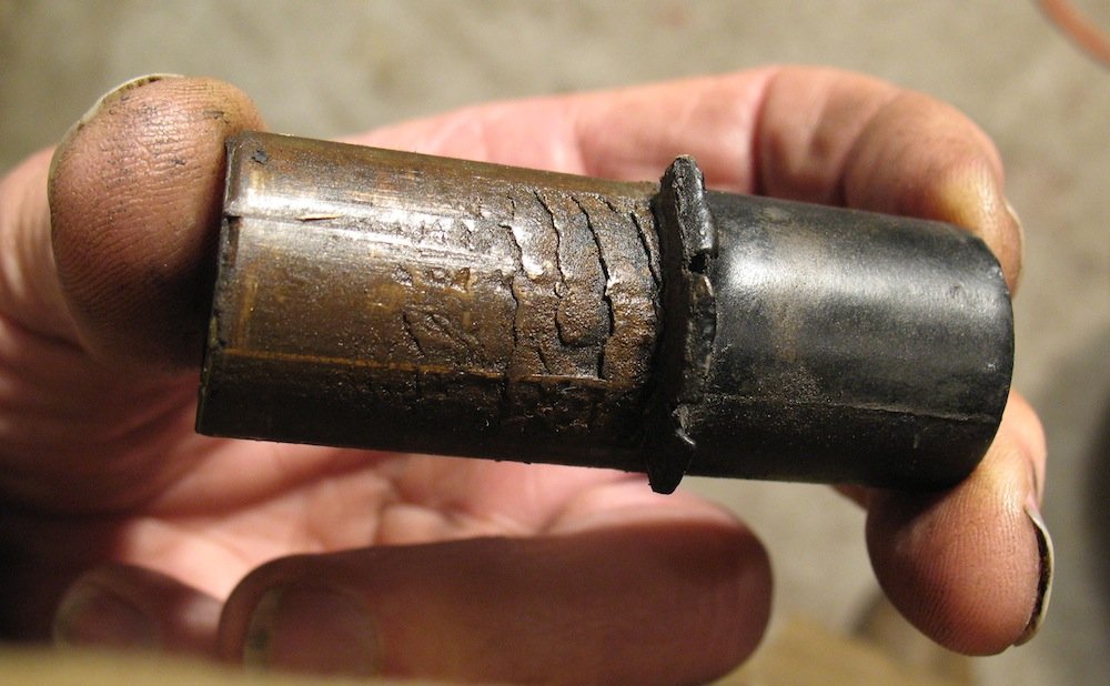

I agree that a hacksaw is handy for removing the old bushing.
I thought the way the old bushing peeled when it was installed was rather remarkable.
I like bronze bushings

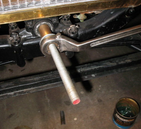

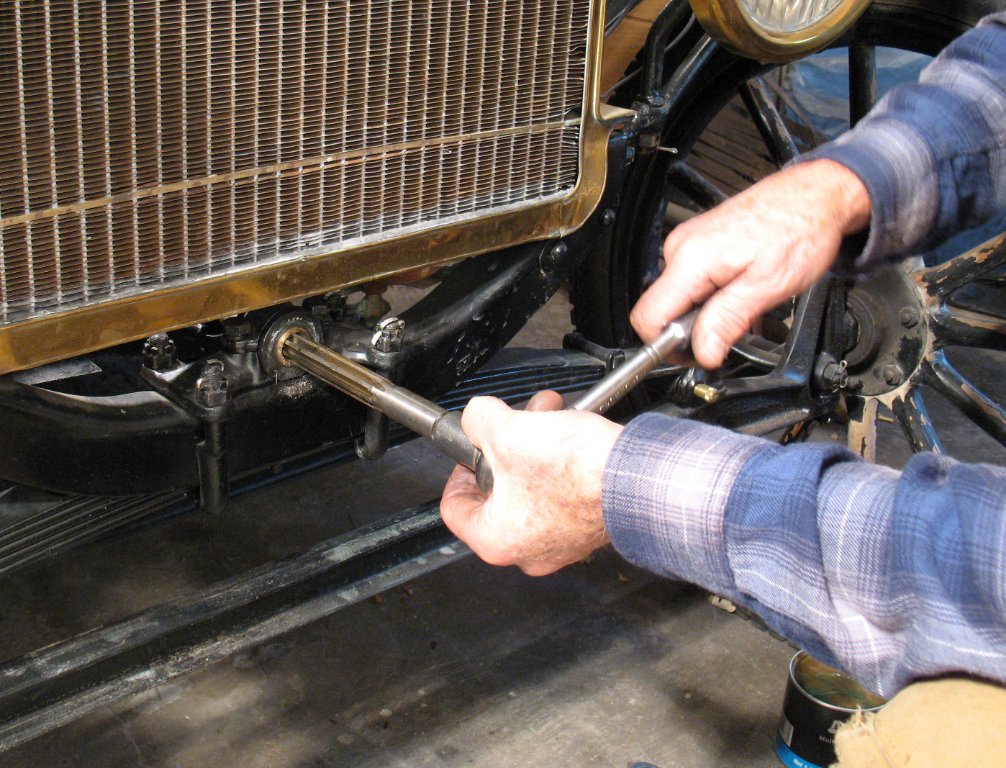

There's no need to bang away with a BFH if you press the bushing in with all thread. Note the can of grease to help the bushing slide.
I didn't have to turn down the OD, but I did need to hit the ID with a ¾" reamer to get the crank in.
