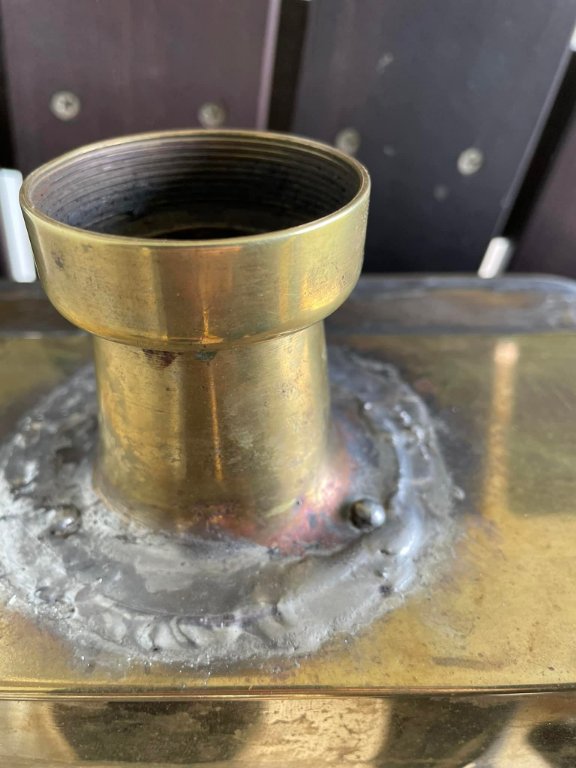

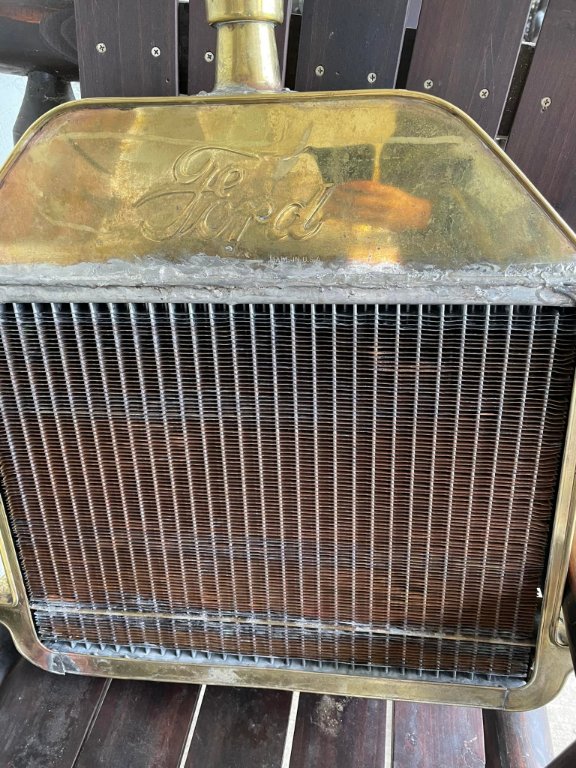

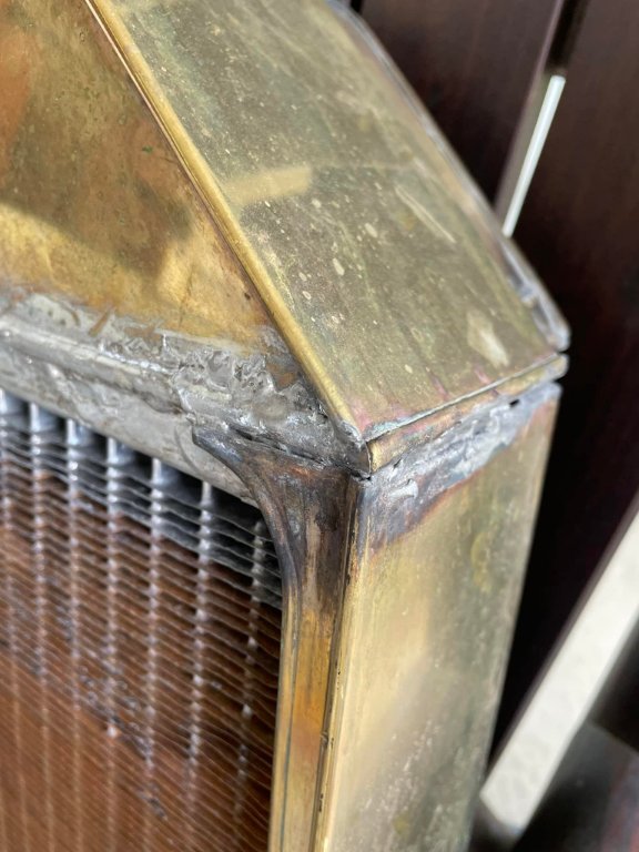

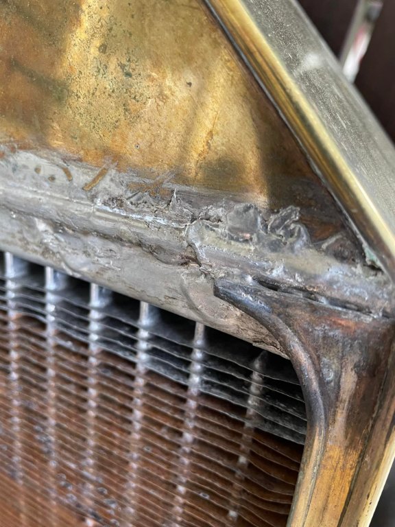

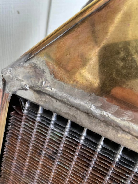

I would Google "vintage car radiator repairs in sarasota florida" and ask shops that advertise as "old school" for references from satisfied customers. These photos from one of the FB Model T groups show why that part about references is important. If you don't find a satisfactory shop locally, extend the search to Florida.

Whoever did the soldering job got the brass way to hot! Check out the solder running down the front tank of the radiator. It ran down an inch. It probably won’t leak but all I can say is WOW. :shock:
