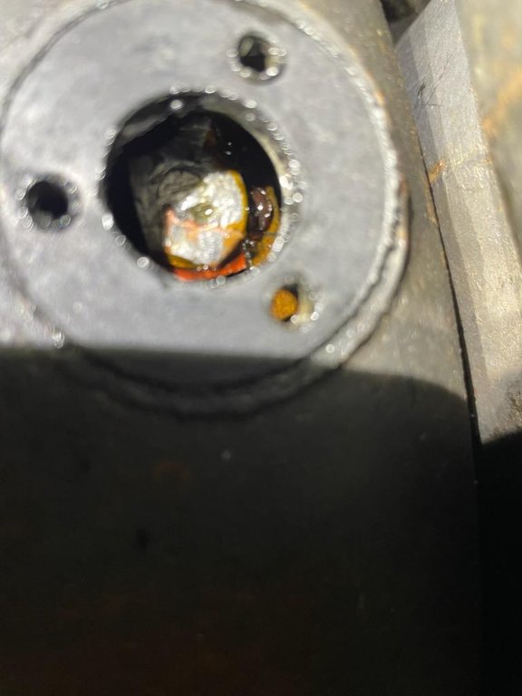

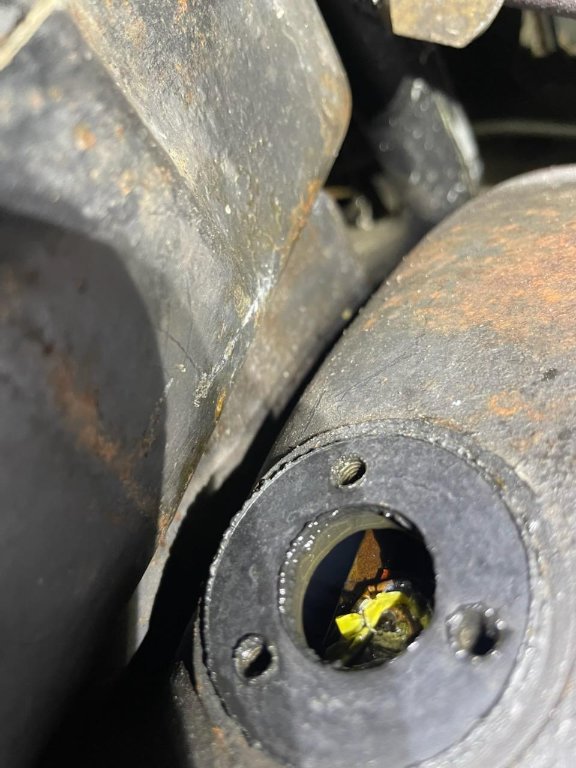

Hello and thank you for your help. I have a 1925 Coupe that I purchased in 1974, and completed the restoration 8 years later. No problems with the magneto until recently, when it shut down when I switched from Bat to Mag. My ignition switch is very worn. The original key was worn so thin when I got the car, that I could bend it. I was lucky enough to find what appeared to be a new key in about 2 pounds of grease and dirt that covered the starter, when I began the restoration. Today, I removed the Mag contact on top of the hogshead. A photo taken through the opening showed some yellow teflon tape that must have escaped from the oil drain plug. I used a hemostat to retrieve it, and it runs on mag again. The contact point on the coil ring appears to be pretty rough (photo No. 2). Should I be concerned that this will be a problem, or as long as there is contact being made it is OK?

It shouldn’t be a problem, but if you are worried you can grab it with a long tweezers and pull it out. Being yellow, it is possible that it is a piece of Kevlar, which if it got under the band lining, could be a problem. Best to try and get it out. Jim Patrick

Jim, Thanks for the prompt reply. I was able to retrieve the piece of Teflon tape. Mag now works. I was concerned about the irregular wear of the contact point, and the looseness of the ignition. Looking for comments about the available replacement switch Thanks, Bob

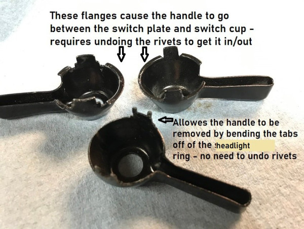

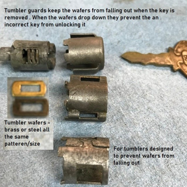

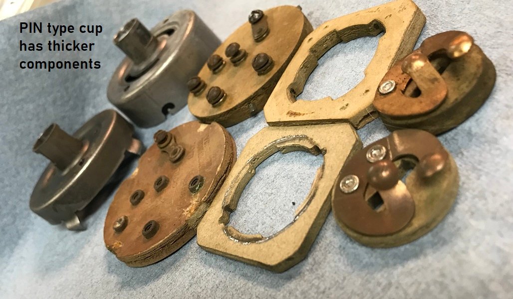

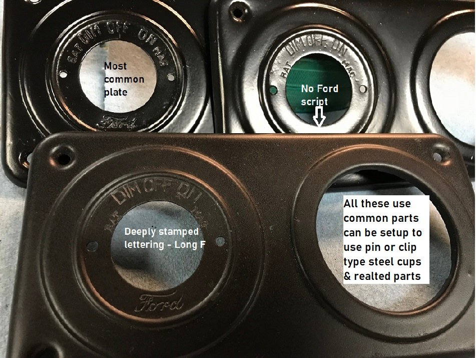

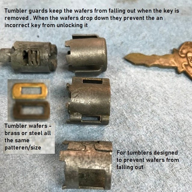

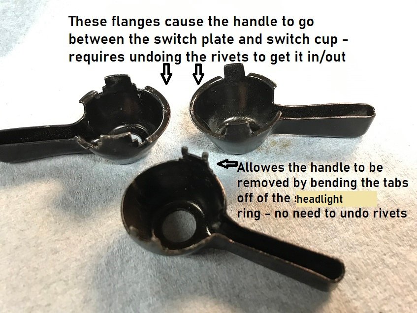

I have repaired several ignition switches. A "loose key" and a "bit touchy to mag" are slightly vague and represent two different problems. A loose key: The face of the cylinder should have a number on it and that should match the one on the key. Its possible that the lock (cylinder made of pot metal) is cracked or worn. Worn would correspond to the thin key if it was the one always used and numerous turns. It could be cracked because of being "touchy to mag" were some additional force was applied to keep it in position.
To understand the issue better pictures of the front and back would help be cause there were several manufactures and we can't assume which one you have. The two most common ones will have two rivets at the 3 & 9 o'clock position on the front face and the back disk may be either a clip type or pin type. One other question is how does the handle for the lighting work. tight or loose?
There had been some issues mention about the reproduction switches mentioned in the past. That doesn't mean the current ones have the same issues.
Depending on switch you have: The fiber disk ion the back can be replaced easily (pin or clip type) and your are most likely have a common one. Some switch designs require the rivets to be removed in order to replace the lock. This can be identified by the way the handle is secured. The one that does has a flange tucked under the switch plate to keep it in place, the other type has tabs that are bent over on the bottom of the steel cup holding the switch parts. Removal of either needs a bit of skill. Drilling out the rivets may cause them to spin making the hold larger (tool required to put new ones back in), the tab ones need to be pried open and picked closed when done...
