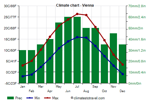

You need to remove your extension if yo u haven't already. As Dan mentioned the Motor-Meter was design to measure vapor not liquid temperature.rainer wrote: ↑Sat Mar 26, 2022 3:39 pmTRDxB2:
Yes, indeed, I didn't mention the kind of coolant. I use antifreeze thinned to -12°C. Perhaps I will have to reduce antifreeze percentage for better cooling.
Air temperature was ~20°C / 68°F
I have no idea what temperature a motometer indicates when it reaches the upper margin of the hole, but this must be very close to 90-100°C / 190-210°F. When I turned off the engine I heard some decent blubber for short time (approx one every 5-10 seconds) so the engine must have been close to the coolant boiling temp.
Need to say that I extended the lower end of the motometer by 1.5-2" by sliding a little copper tube on its end. So it dips now into the coolant. Possibly this makes it show a higher value?
With your coolant at set at -12°C (10°F) it should be Okay if this chart is correct (bars)

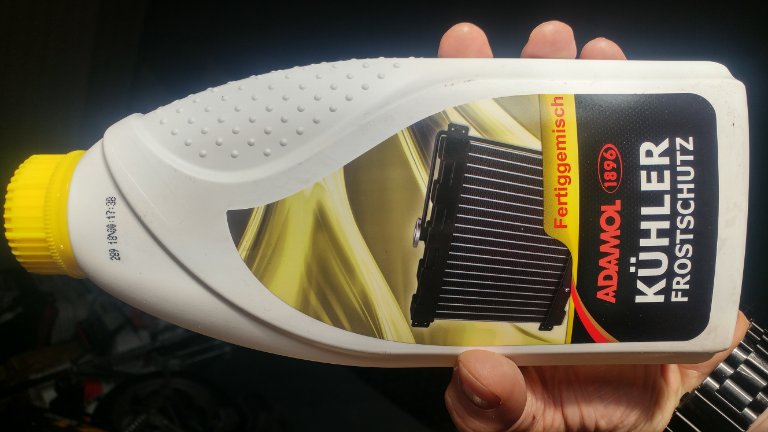

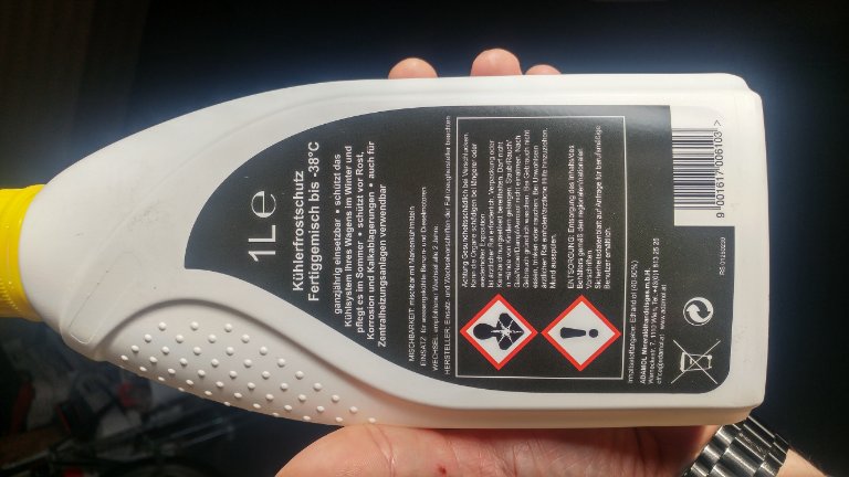

The coolant is new, filled in after finishing my clutch repair last Nov-Dec, but thank you for mentioning.ironhorse wrote: ↑Sat Mar 26, 2022 5:05 pmHow old is the coolant in your system. I know a lot of people never change the coolant unless they have to change a hose or something, but coolant like everything else degrades with time. I replace mine every 2 years and consider it cheap insurance this renews your rust inhibitors and helps keep buildup in your system to a minimum. if you are unsure of the age of your coolant a system flush may be in order. Happy T-ing![]()
My school friend works in a company "Adamol", they are selling oil, coolants, grease, ... for many purposes. He chose coolant for me, especially made for systems with copper and iron inside. It is softer to all the brass in the radiator than some other coolants.
