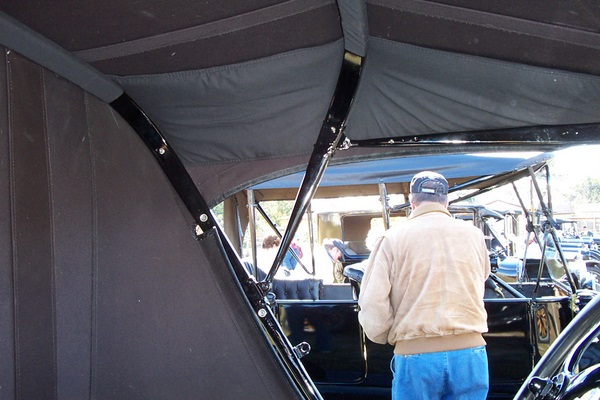

I managed to rip two of the fabric straps under the internal headliner of the 2-man top on my 1915 Touring. So now when I put up the top, it just sags everywhere. To make repairs and properly put it back together, I need a reference photo of what the inside ceiling of the top is supposed to look like. Does anybody happen to have such a photo scanned in? Does a drawing exist?

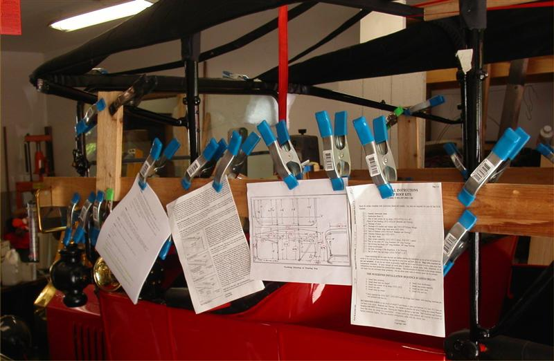

Post by TRDxB2 » Sat Mar 26, 2022 12:52 am
There my be some pictures in this link that might help http://www.mtfca.com/discus/messages/80257/93079.html
another
http://www.mtfca.com/discus/messages/80257/93685.html

Bob, what you are calling the internal headliner is the top padding. The top padding is a sandwich of webbing, cotton padding, and a cloth cover. The purpose of the padding is to keep the top bows from telegraphing thru the top material and making it look like the ribcage of a starving horse. The padding sandwich is assembled inside out on the car top bows, working from the outside of the car, and is one of the first things done during top installation. In my experience, there is no proper way to replace the webbing with the top material on the car, so you will be essentially doing a complete top installation by reusing old components that have nail holes and is already custom cut, not an easy job. I would consider living with it like it is or expect to be installing a complete new top kit.

Look at some restored cars that have good fitting tops. To do a good job, your top needs to be removed. You also may need to put more cotton padding inside your pads while off. Make sure the strap inside the pads is secure too.
