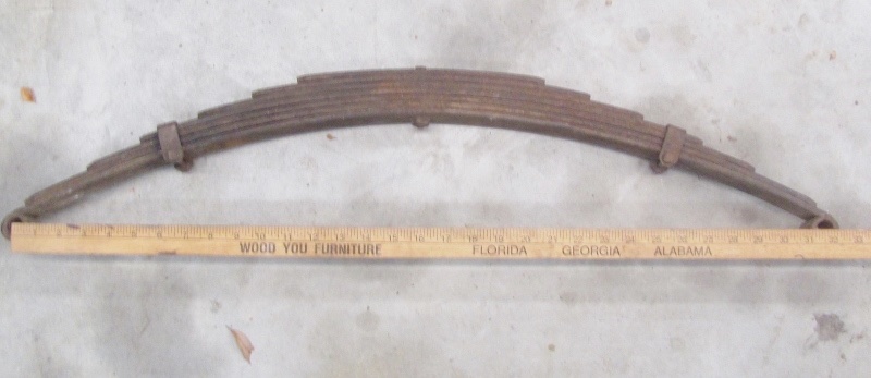

I am rebuilding “the ends” of The Basket Case, found that front end has been, hmm, “customized”! Wondering What is the proper length of each of the individual leaf springs? I believe 7 is the correct number, looking for length/configuration, how many leafs within clips?

7 leaf Model T Front Spring (1920-'25) - Measured Length of Spring Leaf and Overall Height of Leaf lying on flat surface.
L 9-3/4" -- H 3/4"
13-7/16" -- 1-1/8"
17-7/8" -- 1-5/8"
22-5/8" -- 2-7/16"
27-3/16" -- 3-1/8"
32-1/2" -- 3-7/8"
33-1/4" -- 4-11/16"
Bottom 4 leafs are captured by the spring leaf clips.

Thank you ! Just what I was looking for...
