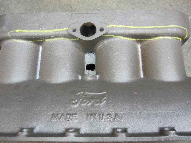

As Joe mentioned, The 26-27 blocks are prone to having cracks between #2 and 3 cylinders. They are usually cracked in the top of the oil galley in the water jacket. Probably due to a change in cores or casting practice.

Common cracks are in center valve seats; due to overheating Ones you've mentioned are caused by freezing and stress.
All of these cracks were repaired by us and engines are back on road.
