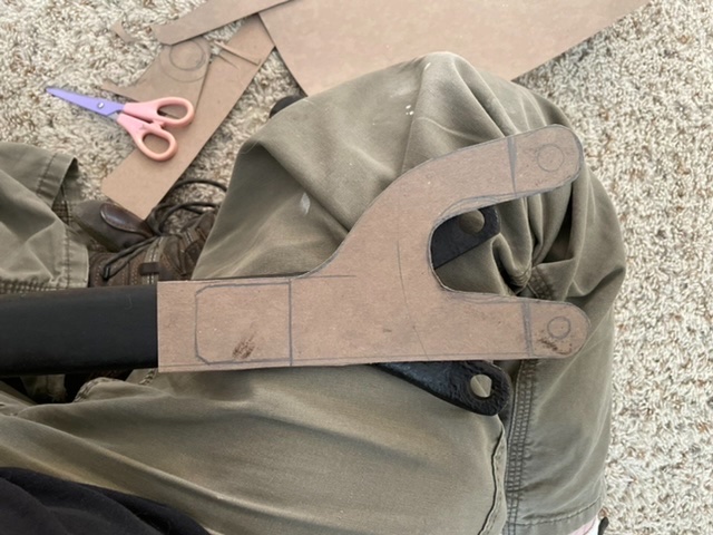

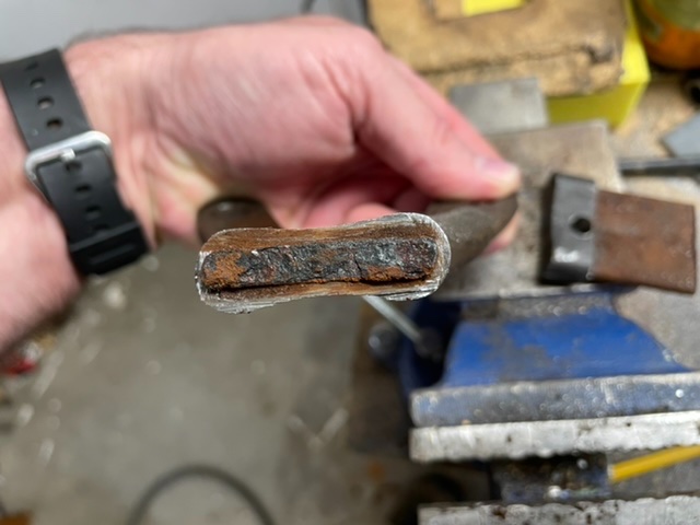

I am making some custom rear radius rods to fit the lowering brackets I made for my speedster project. I could make entirely new ones, but I wanted to modify original ones to make them more period. I needed to shorten the rods and make new “forks” to clear things. I am also taking the opportunity to drop them down slightly to make a bit more frame clearance. Anyway, I was cutting the “forks” off of a set of pre-26 rods and discovered that Ford built these with a 1/4 inch thick plate installed inside the outer tube to reenforce the fork. I cut around the tube then pulled the plates out so I can slip the new plates inside before welding and riveting them to the tube. I discovered that on one of the rods the 1/4 inch plate was rusted clear through but the much thinner tube was in pretty good shape. So, they must have used a much lower quality steel for the reenforcement than for the tube. Just thought how they put them together was interesting.
The pattern for the custom end to the radius rod.
The rusted end of the old insert, just a crumble of rust that snapped in half.

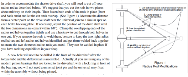

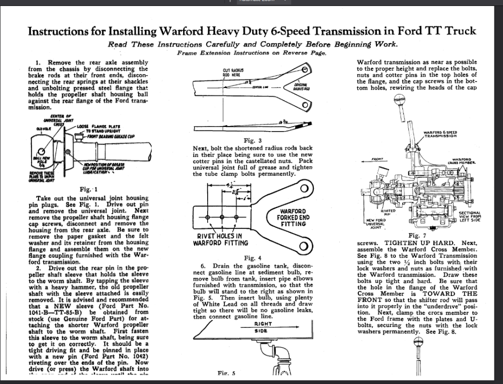

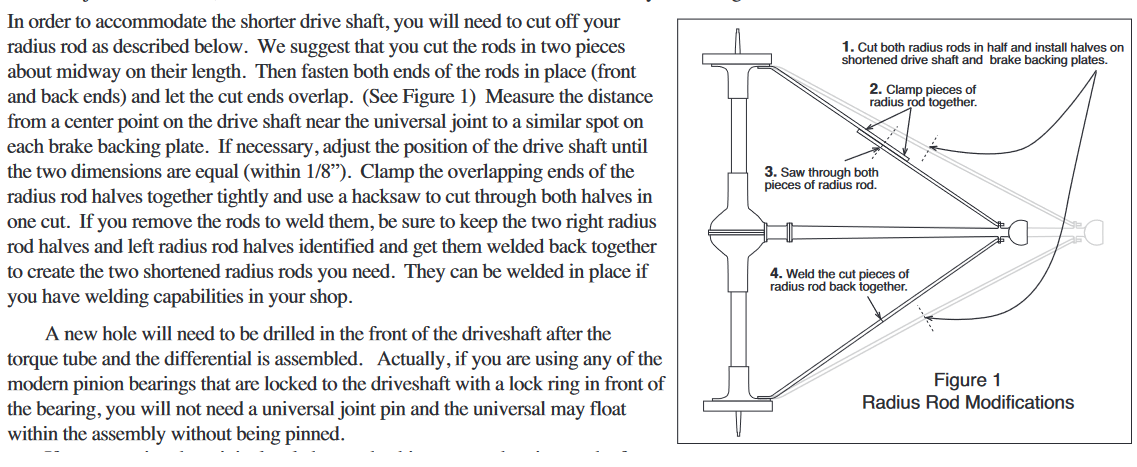

When you got the Warford, it came with ends that had an extension. You cut the radius rods and inserted the piece, then riveted them back together.

I have seen that in the books. I am running a Muncie transmission but my brackets make for a longer wheelbase, which means a custom length for the radius rods.

Texas T instructions http://www.texastparts.com/mm5/manuals/WarfordInst.pdf
From Cimorelli's Digital Library
warford-tt-truck-transmission_002.pdf
(207.79 KiB) Downloaded 91 times

Interesting. I have never seen the one for the TT. Interesting to see that what I am doing has been done before.
