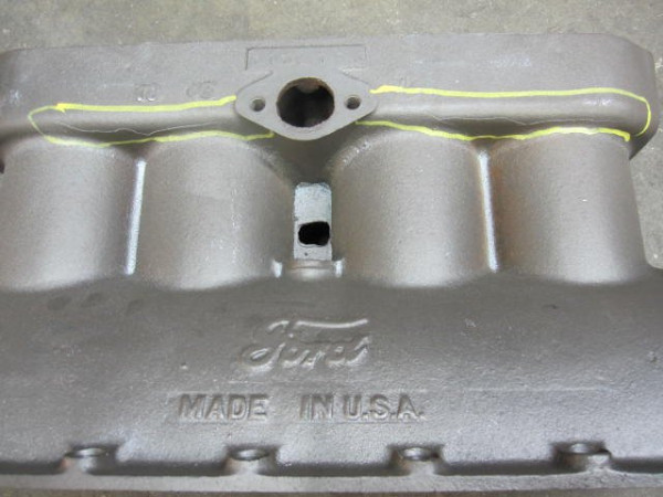

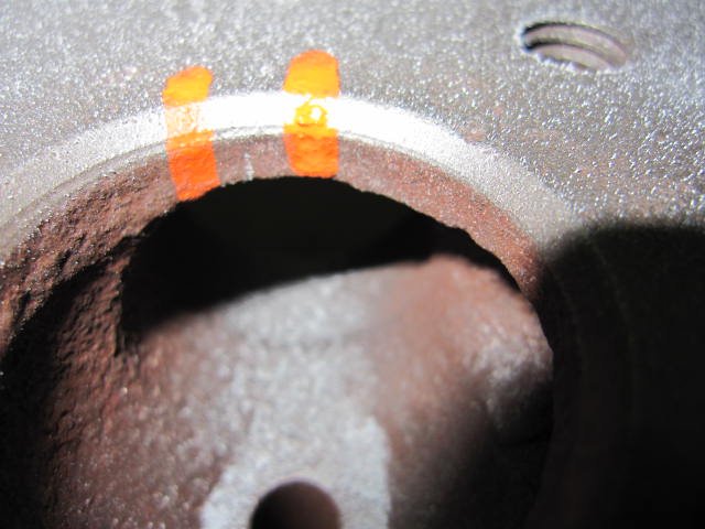

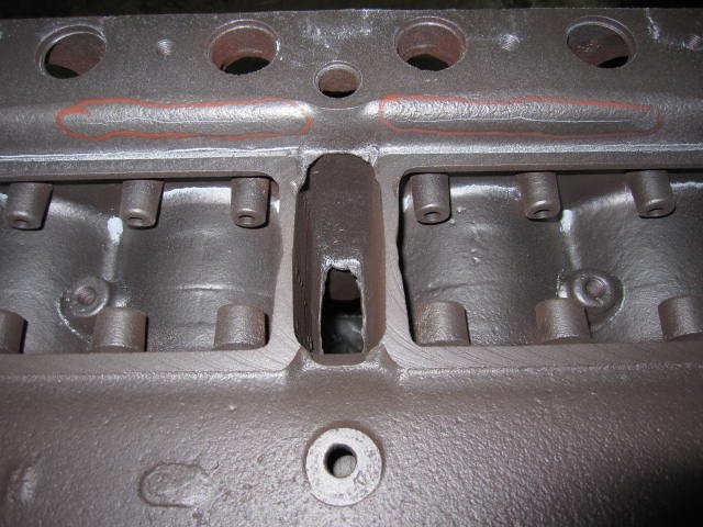

As with any engine over time wear and tear and rust take its toll on the block and iron parts.
We've seen the multitude of cracks on engine blocks/heads and Model T isn't void of those as all engines stress.
Dealing with something that is old and wasn't meant to last this long.
Common cracks are in center valve seats; due to overheating
Ones you've mentioned are caused by freezing and stress.
All of these cracks were repaired by us and engines are back on road.
