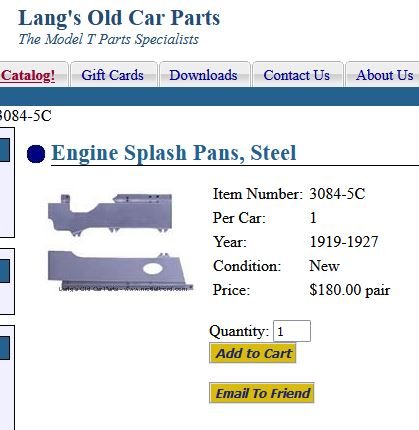

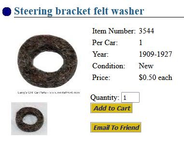

I have a 1927 Touring and was ordering some parts from Langs and saw these, what are they for and where do they go?

First one is dustshields between the crankcase and the frame and the "where do they go" question's answer is: "in the trash the first time someone worked on the engine"
as for the second: the felt goes into the top of the steering bracket mounted to the frame

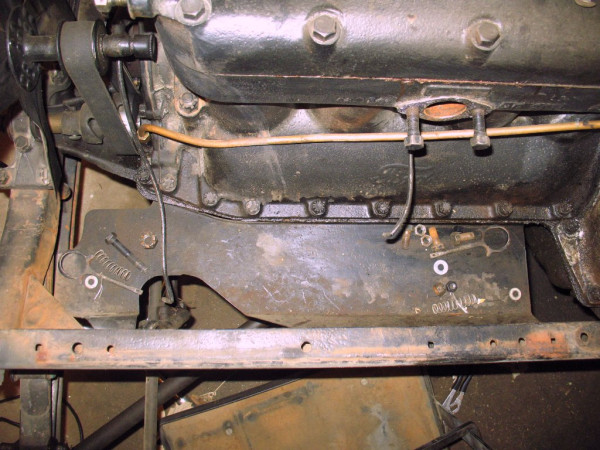

The first ones fill the space between the oil pan and frame, enclosing the bottom of the engine compartment. It attaches to some of the oil pan bolts and the to a couple of bolts on the frame. Some guys run without them....it doesn't seem to make much difference...maybe the engine stays a little cleaner. I bought a pair on this forum a couple of years ago-have yet to install them.

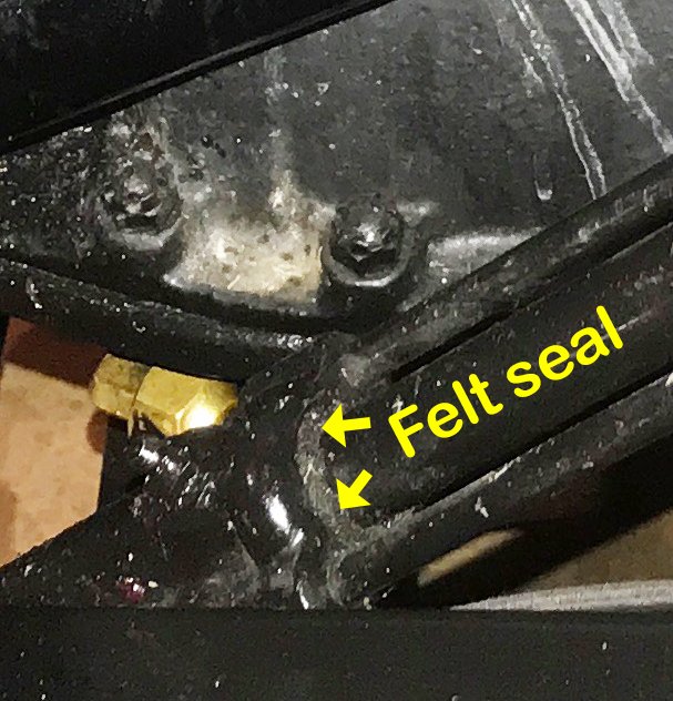

The second one goes into the top of the steering bracket which is attached to the frame. The steering shaft passes thru the hole and you have to tamp it into the bracket. When you pump grease into the bracket it acts as a grease retainer and helps keep dirt out. See photo

My car has them in place. I believe they contribute to good underhood airflow when the car is moving down the road at any significant speed. At idle, with or without a fan, I think that most air that passes through the radiator goes out the hood louvers. They do prevent road splash from reaching the engine and the uppper end of the steering bracket. On a car equipped with a fan, I believe they reduce the amount of road dust that reaches the carburetor intake. They probably increase the amount of radiated engine noise. Covering the underside of the splash shields with a thick coat of undercoating material might reduce this. As mentioned above, they'd have been a very easy item to delete, yet Ford did not do so in spite of the evident cost savings.

Even though those will work, they are not what Ford supplied! The left on is correct, but the right one had two holes. One was for if you had an NH or an L4 carburetor, and the other was for if you had a vaporizer. They show up on ebay occasionally.

Is the 8-5-28 parts book mistaken? It shows the right pan with one hole fitting all years.

Intended Design: The "Engine Splash Pans" are one of the components of the cooling system, along with a louvered hood, and radiator by creating a negative pressure zone in the engine bay when moving by drawing more air through the radiator and out the louvers". You can see how more louvers were added to hoods over time. The fan is intended to draw air through the radiator when stationary or creeping along.
While there are opinions on the effectiveness of this design, there is consensus on them being an inconvenience to remove/replace when working on the engine.
Experiences are dependent on where one lives, ambient conditions, how one drives, radiator condition, engine modifications, coolant, hoods and splash pans etc all have an effect on cooling the engine. Perhaps it would be one of the questions to ask those with over heating problems, if they have splash pans or not.
As Larry noted: The reproductions are to accommodate different configurations. So when installed one needs to further modify them to match there engine configuration. One size fits all is never without modification

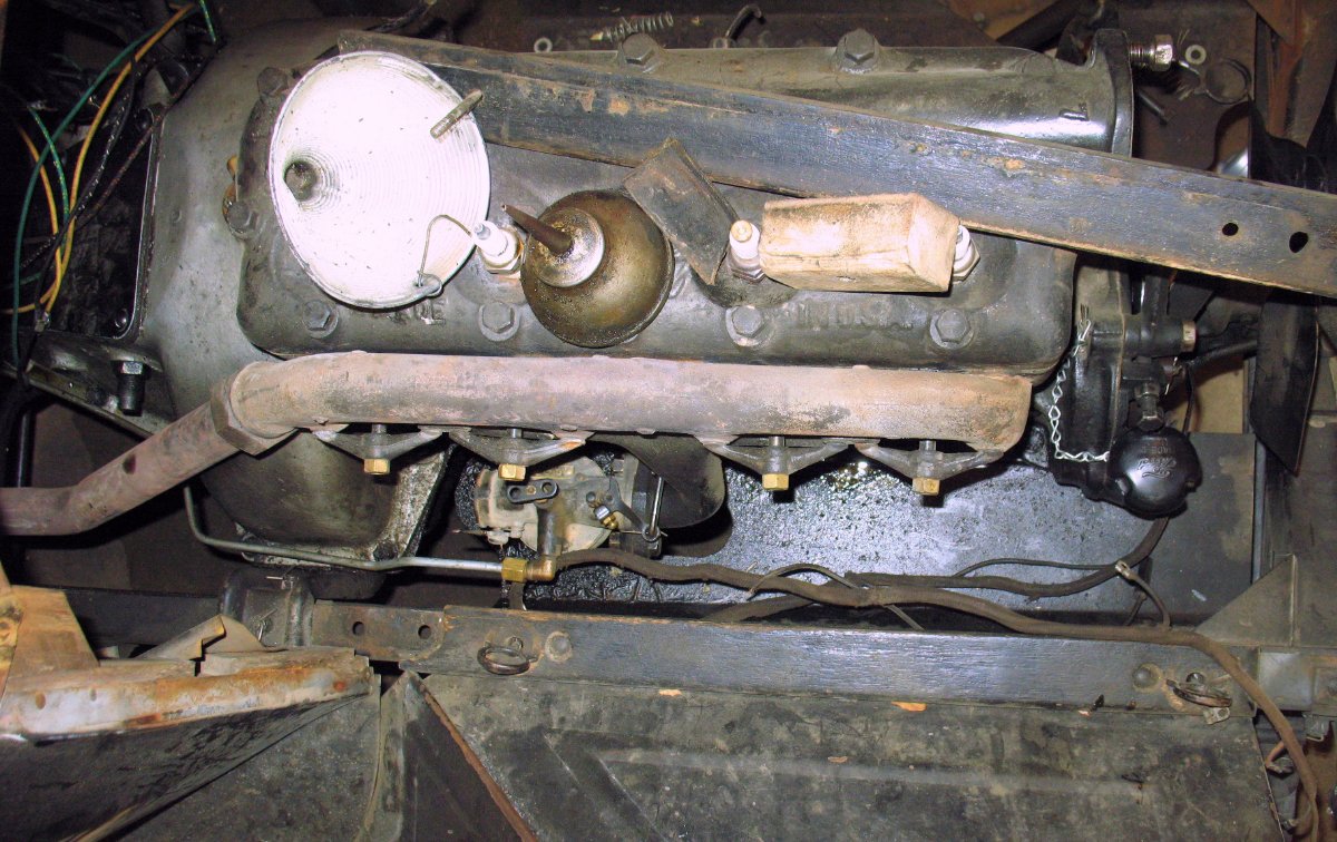

Does anyone have a picture of the engine splash pans installed?

I have my 1915 apart for some work, but the pans are still in.

I was very glad the splash pans were on my '26 the day the top of the coil box came adrift and was caught there , not ending up on the road.
