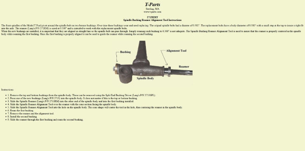

It appears to me to use the Spindle bolt reamer alignment tool I would install one bushing and opposite use the alignment tool to run the reamer through to ream the bushing then install the other bushing and run the reamer through the first bushing and ream the second one, just checking if I have this correct.

You've got it right. That's exactly how you do it.

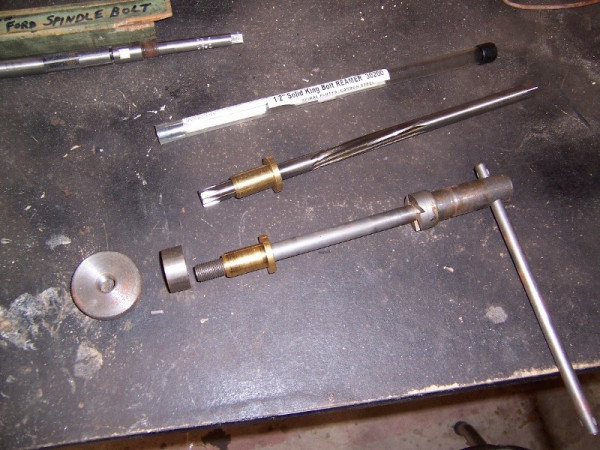

Might want to just have the machine shop do the bushing reaming and the bushing face reaming too to fit the axle yoke.
A facing tool is used to thin the upper surfaces to make sure snug contact with smooth turning in the axle yoke.
Spindle reamer on top, note the narrow pilot end to start into the bushings.
Face reamer on the bottom, tool can be adjusted to just take fine cuts to get the proper clearance between the bushing faces.
