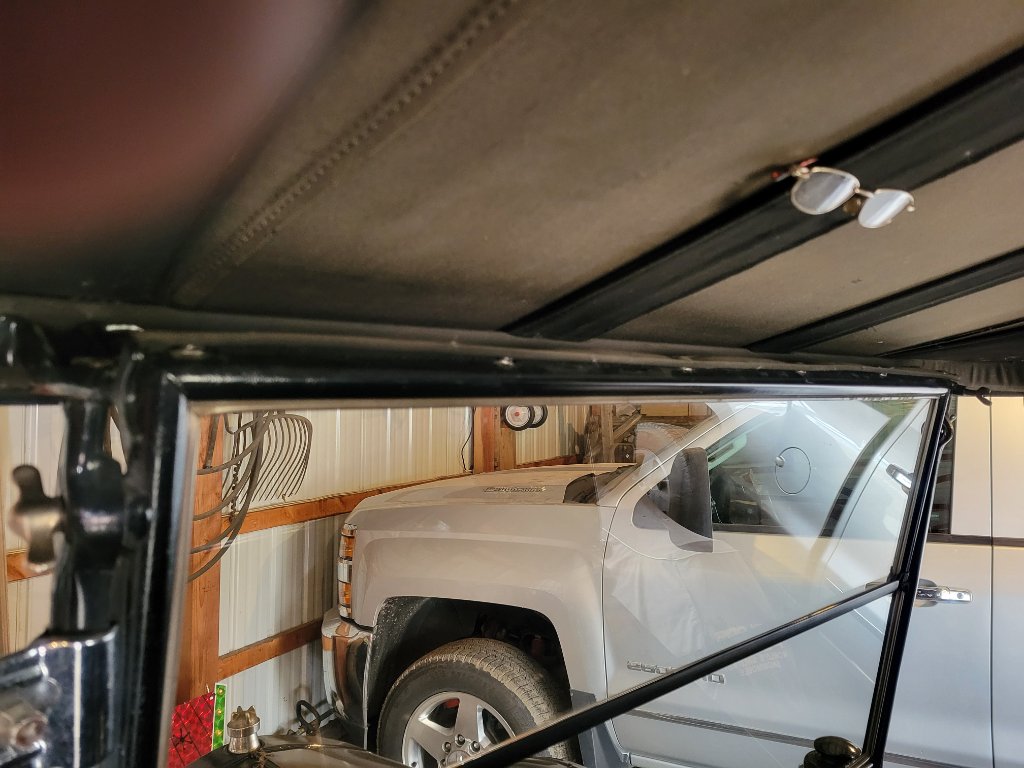

...sorry Jerry; its neither an original weather flap or a 1921 runabout - but it is a Classitique top. Elizabeth builds these with material folded under and sewn. I’ve found that at speeds the flap blows back behind the top windshield. But its easily remedied by inserting a 1/4” or 5/16” cold rolled metal length into the flap for weight

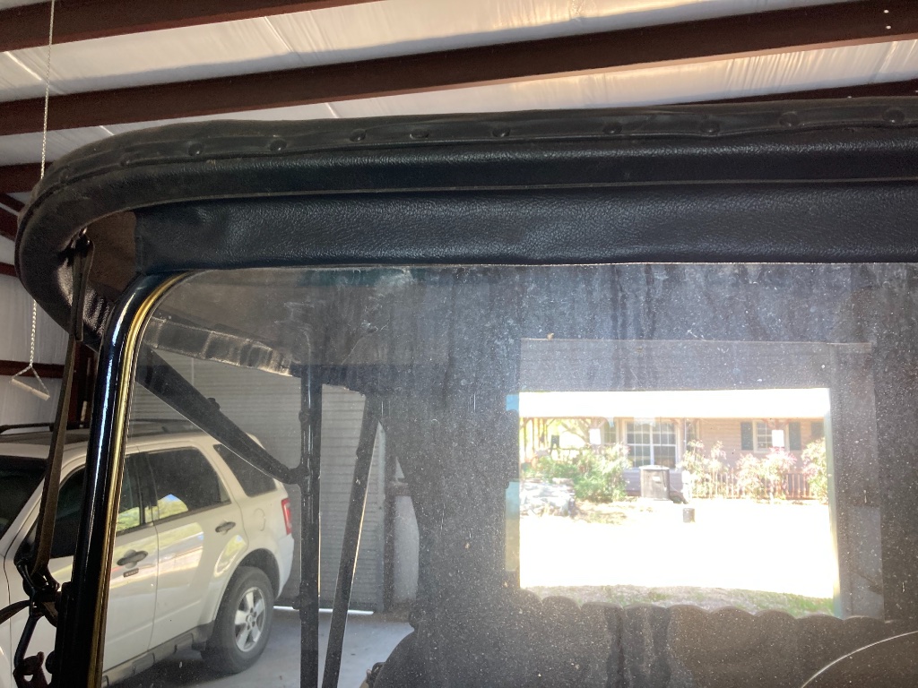

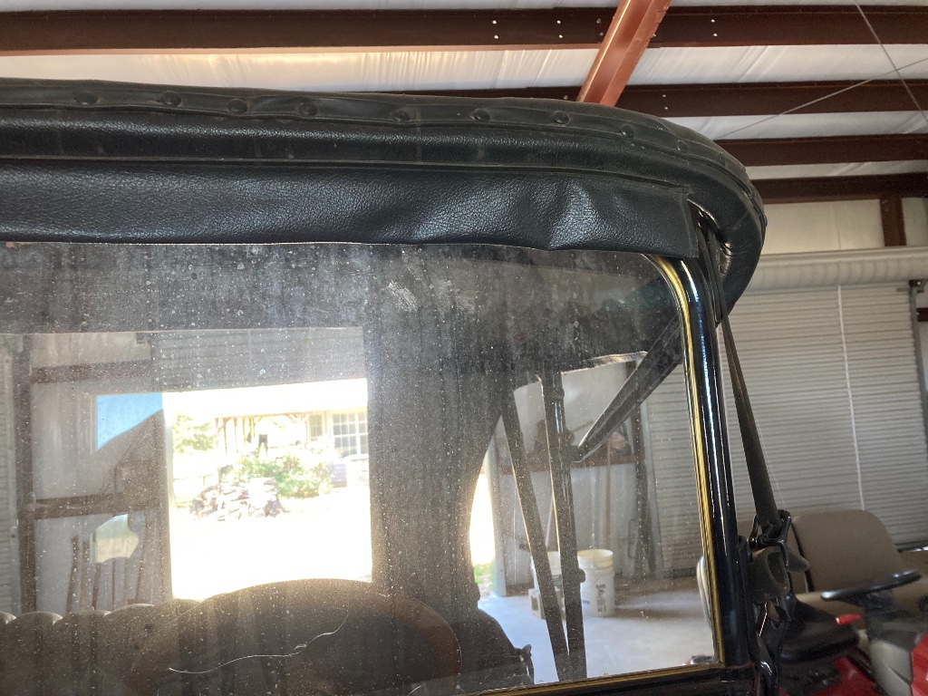

Mine, also wrapped around the front bow, neither a roadster or a 21, but the flap is designed as a V that goes in front of and behind the top glass frame, with a slot for the windshield wiper arm to fit into.

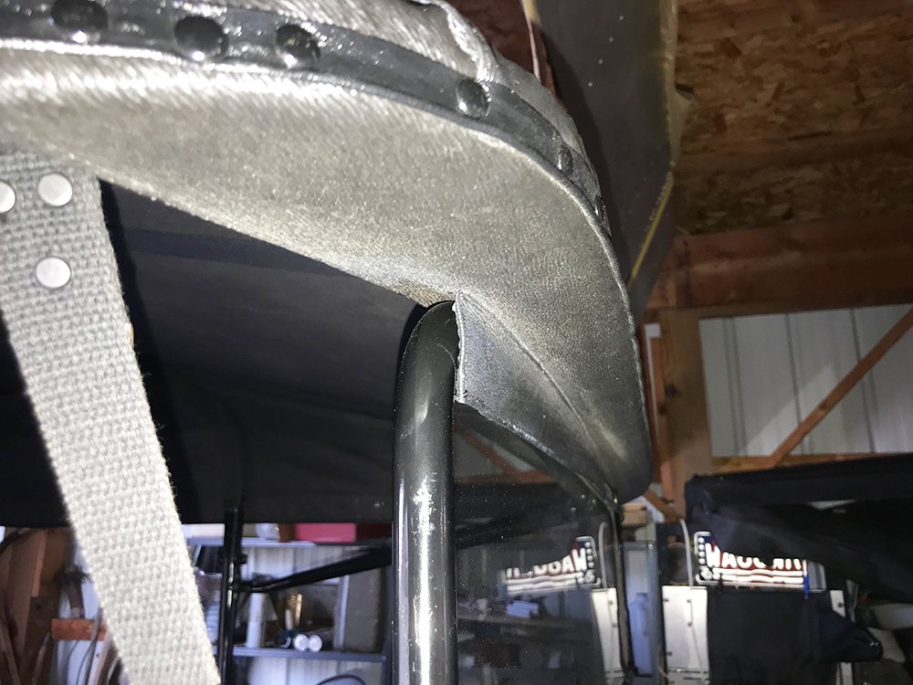

...and here’s the passenger side ( right side to you, Allan ) of the weather flap. Will, I don’t understand what you meant the weather flap “goes in front of and behind the top glass frame.” If it positioned behind the top windshield that would let the rain in..??

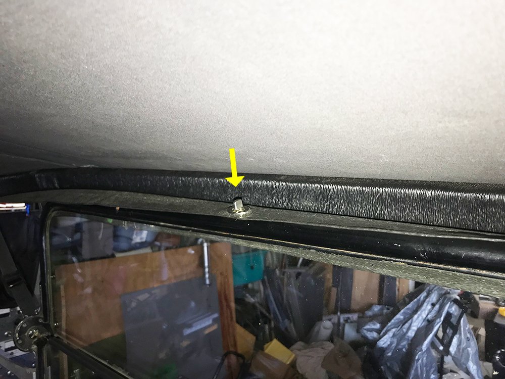

This may not help much,but on my '17 touring we added a piece across the underside of the front bow, with the rear edge extending just a little ways behind the windshield frame. Another strip was sewn to that piece at a right angle so it lay vertically in front of the windshield frame. (A)
It made an effective seal if you didn't go too fast, at which point it started to lift. I corrected that by installing a single twist fastener to the top of the windshield frame in the center and the receptacle in the piece which lay flat atop the frame. (B) Stays put regardless of speed.

Thanks all! These techniques are the same as, or similar to, the top currently on the car. Seeing how the new top is likely to be made is a big help, thanks George!
Tim,
I like your fastener idea! I know it would have helped on the old top. We'll see how the new one behaves...
Tim,

Jerry, the twist fastener does help. It only takes the one to keep the flap from lifting. I attached it to the windshield tube using a couple of small aircraft pop rivets. If you need a couple of rivets let me know - I have a bunch.

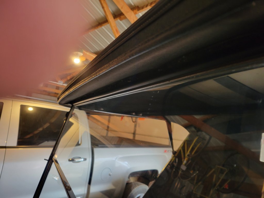

Re: '21 Runabout Weather Flap
Jerry,this is my 23, done at Classtique in about 1974. I feel it works well. I've driven in downpours.
