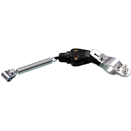

Are these units still being produced? If not who is making a comparable setup?

The last I knew which was several months ago they still were not being produced. Birdhaven is supposed to, but not as yet that I know of. Call them.

I contacted them about a month ago to inquire. I was told they are waiting on parts to make them… much like everyone and everything else the Model T vendors are experiencing back orders, shortages and out of stock due to supply issues.

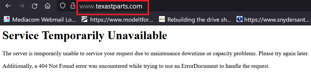

No Birdhaven Website and their Facebook page hasn't seen activity since 9/11/2021 other than my comment Today.

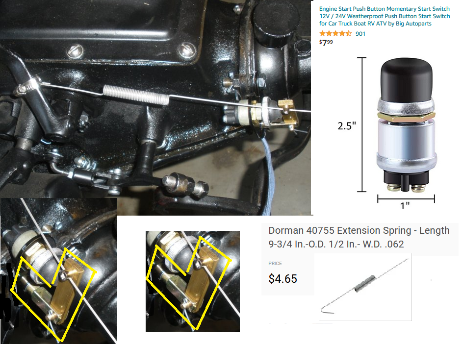

Looks like the brackets need to be made
- Posts: 7403
Re: Fun projects brakelight switch?
Knowing the FP switches are unavailable, I made my own. I spent about $11 for a push button switch and a small eye bolt. The rest was all junk I had on hand. It ain't rocket surgery. Even better than the cheap price is that it actually works.

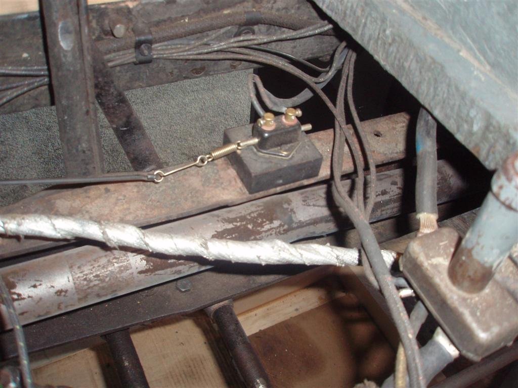

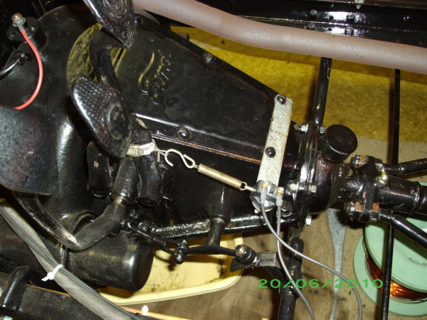

I made mine with an old brake light switch, a spring, a bit of baling wire and a hose clamp.
Cost very little and works.
The switch was mounted on the frame rail.

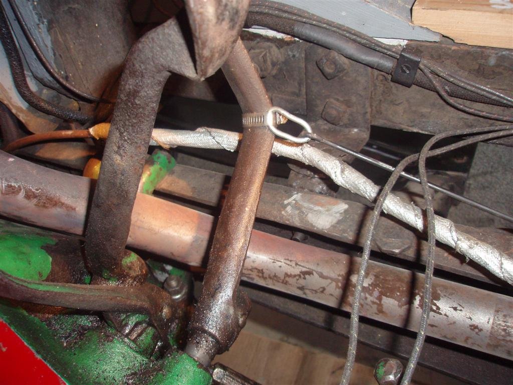

The hose clamp on the brake pedal clamped one end of the baling wire (using a ring for articulation - see picture) with the other end attached to the spring. The spring then attached to switch. It is set to 'rest' when the pedal is in 'normal'. When the pedal is pushed the spring takes up the movement and pulls the switch.
Hope that helps.

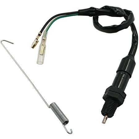

Use a motorcycle brake light switch, some have a spring.

Snyder's sells a model A stop light switch with a pull rod which should work. part # A-13480-B $6.50 in 2021 catalog. similar to one the one Whiteman used in photo mounts to the frame connected to the brake pedal by spring and short rod. photos of motor cycle switch like Dale mentioned.
