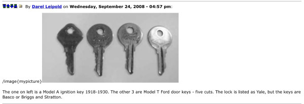

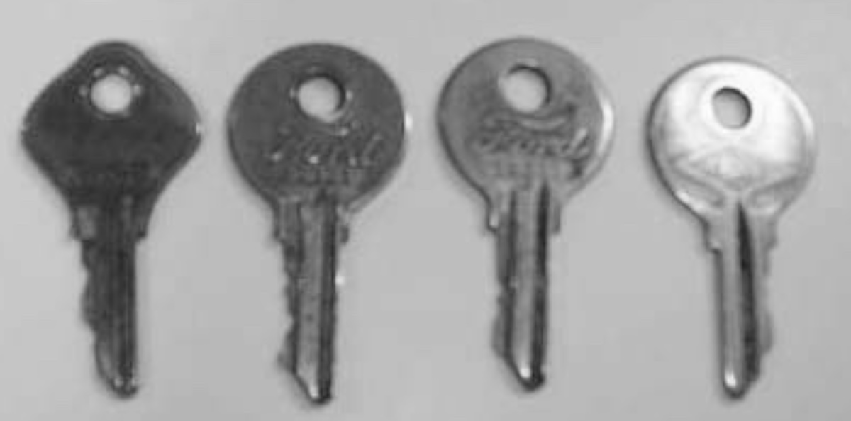

In case you can’t find a locksmith that will have or cut a cut a key Lang’s sells a new reproduction cylinder and key that’s really close to the original.
I have a 24 Coupe and when I restored my car I found out that the 24-27 closed T ‘s used the same type of door key and cylinder. It’s simple to remove the cylinder and replace it. 1 screw holds it in.
https://www.modeltford.com/model-t-part ... oor/latch/

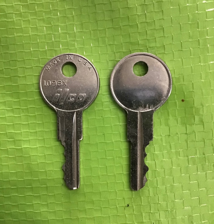

If the vendors are out of stock these on Ebay are the same. You just slide them into the door, mark the shaft to length, then cut to length with a common hack saw.
https://www.ebay.com/itm/350794224732

not correct for a 1930-31 Model A Ford door handle with lock.

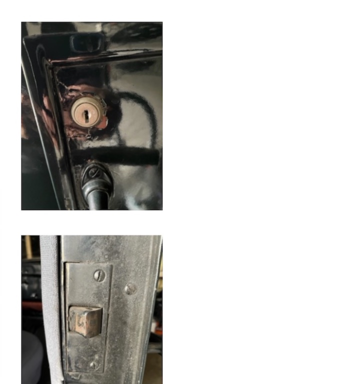

By the way, in case you didn't already know, in your photo that you posted above showing your door striker. The small slotted screw between the striker and the door flange is the screw that holds in the lock assembly. By removing this screw completely will allow you to remove the lock assembly.
By doing this, it will make servicing the lock much more convenient.

FOLKS! I was unable to get the tumbler out. There is something holding it on the back side other than the slotted screw on the door side. I will have to try again after talking with you folks here on the board!!!
Should I take the door panel off?????

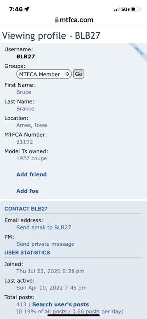

Contact this forum member for details. He had the exact same problem a few months back getting the cylinder out of his door and I cannot remember his solution…..
upload pic
upload pic-

Michael - thank you! I did send Bruce an email....waiting to hear back. I fear the only way to get it out is to cut whatever it is holding it in or to destroy the mechanism....stay tuned

Yes it looks like it! But there is a reference to 'other pictures' or earlier pictures and I can't find the pics.
I did msg the poster. But it does appear that he had to destroy the old lock to get it out.
If I destroy I will have no lock. Any repro are long back ordered. Used are hard to find.

Will do. I will try again this evening. I had an antique locksmith locally look at the pictures.....he actually thinks this unit is one that does have a clip of some sort. Either way will keep trying gently until it is fruitless. And I can always leave it as is and just never lock the door. I do not keep anything in it. And who the heck knows how to drive a t anyway? I don't think car thiefs do...unless they are model t owners.....
And we will go from there. THANK YOU!

I did hear back from BRB27 who had the same problem a few years ago. The only way he got the unit out was to drive through the existing lock unit from the front with a punch, destroying the lock and buying a new one.
I have been lubricating the unit for the past few nights with WD40. I also looked at diagrams of the actual lock mechanism and where the shaft front the lock assembly fits.
Will try again on Saturday. I also have an appointment with a local antique car locksmith on Tuesday who is going to come to the house to see if he can possibly make a key from the lock while it is in the door.....Long shot I know. But he has extensive experience and is a 2nd generation locksmith. He has pictures from all angles of the lock....
Otherwise the option of never locking my door is ok with me. I don't plan on keeping anything in the car. It is just a challenge now of finding a key...more like a treasure hunt than anything.
Stay tuned on Saturday and I will have a better indication if I can gently move the tumbler out with some persuasion or if we go to the tuesday appointment with the local antique car locksmith.
Mr. Golden - I will email you directly later today but I was hoping I could get it out and get it to you to do your magic. I don't think that will happen the way things are going! lisa

Dropacent
I agree. And I will definitely chase a key! It will definitely look like the three on the right....
Hard to find original keys...people want all sorts of crazy amounts for them. Hopefully someone - whether it be Mr. Golden or the guy locally - can make it happen. I will know by tuesday!

Here is a picture of the 2 keys for the 24 Coupe door lock on my car. It’s a picture showing both sides of the same key. Look closely at the pic that dropacent sent and you can see it has the same key way as the originals he shows. Mine probably has different cuts but it’s the same key as his originals.
This key is a Ilco 109SX. Or it could be 1098X. The stamping might not be clear. Most lock shops should have these. I got mine from Ace hardware about 10 years ago. If not they are probably available online and other brands probably make the same type of key.
It’s a fairly common key for different types of locks.

It is funny....I was looking at Ilco keys on line last night. They look like the right size. a few looked a bit thick but the others looked spot on. Let us see what Dan says when he is at the house on Tuesday. I am going to sit down on Saturday and spend a few hrs trying to get the lock out. BY end of day Saturday it will either come out or not. By end of day Tuesday we will know if Dan can finagle it out or if he can make a key from the front of the cylinder...while the lock is in the door.
I will speak with him about Ilco but I suspect that he has already arrived at that as a possibility.
