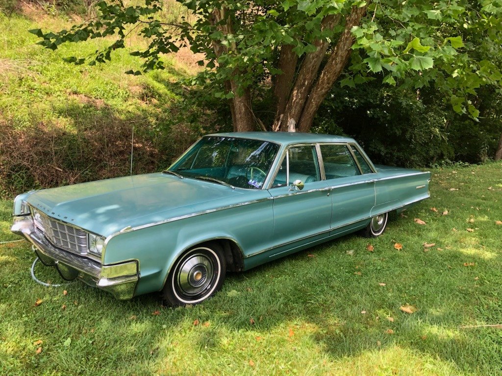

PS, here is my latest project, a 65 New Yorker

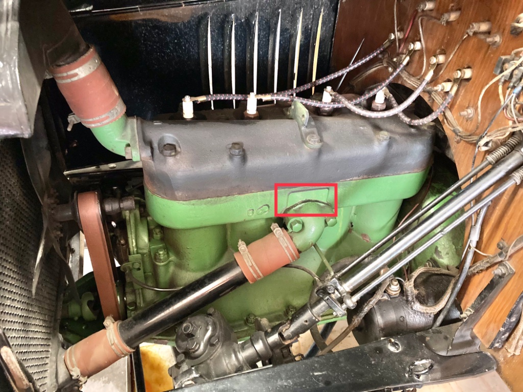

Take close up of engine on the left side above the water inlet - there should be an engine number - need that. Also the other side of the engine. Then a picture of the front and rear axles. That's enough. If it has a descent body & pickup bed too I'll buy it

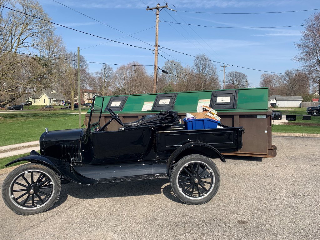

If it a real 1925 Roadster Pickup it it will look like this.
This my 25RPU when new, in the July 4th parade.
This is it now, still working.
Posts: 3960
Location: Lomita, California
Re: 1925 Model T Pickup, should I buy it for 1K?
Post by Original Smith » Mon Apr 04, 2022 11:12 am
The pictures above are of a factory pickup. There are still non factory examples around with all wood beds. Be sure you understand what you are getting. I currently own one authentic 1925 pickup, and used to own one other.

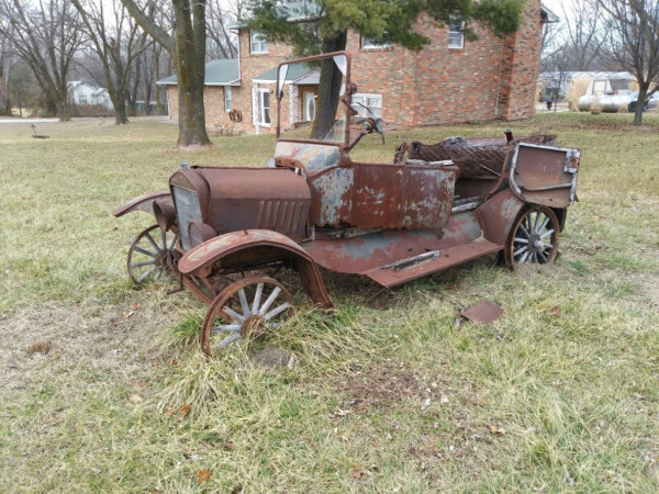

I don't know....based on the limited description, and no pictures, it could look something like this.

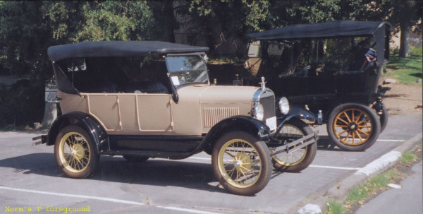

See picture of the car I bought about 30 years ago and the end result of my restoration. It is brought back to original mechanically, and the paint is a color I chose. Might not be exactly the same as Ford made it, in fact I think all the cars in 26 were black, but 27 looks almost the same as the 26 and they came in colors. I put on some extras which were available in the day. I did use chrome on the parts which were originally nickel.

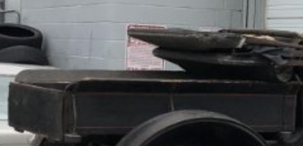

OK, here is a photo I received today of the truck.
Posts: 5559
Last Name: Hatch
Location: Alabama
Post by Dan Hatch » Mon Apr 04, 2022 8:43 pm
Well that is not a 25. But I would be hooking up the trailer RIGHT now.

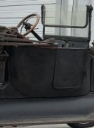

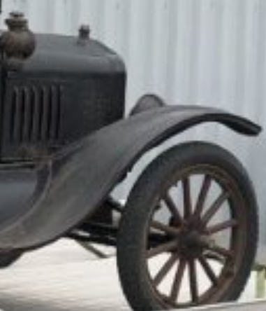

Post by KWTownsend » Mon Apr 04, 2022 8:51 pm
Richard:
Score! But it does not look like a 1925. Straight windshield put it 1917-1922. We'll need more picture to pinpoint it more...
Post by Humblej » Mon Apr 04, 2022 8:58 pm
Wow. I agree 1917-1922. Body type is a runabout with turtle deck removed and replaced by a period correct after market pick-up box. Looks correct and complete. Running or not, title or not, worth at least $4500.
Post by Norman Kling » Mon Apr 04, 2022 9:04 pm
It looks like a 1922. That would make it 100 years old. It looks very good probably worth more than 1,000 just like it is. It should be easy to get it into running condition even if it needs some engine and transmission work. It could also possibly need a new radiator. Sometimes they look good and hold water, but do not cool. Anyway, it is a bargain. See if she still has the trailer and would sell it. If so, all you need is a towing vehicle to drive up there and pick it up. If you join a local club, you might even find someone who would loan you a trailer. Or you could rent a U Haul and bring it home. Or contact Freighter to haul it to you.

Post by TampaT » Mon Apr 04, 2022 9:04 pm
Thank you gents for you kind replies and information. I had recalled that my friend said the car was a 1925, but his wife said 1920. So it sounds like 1920 is probably correct. So, not a factory pickup?

Rich. If you can, get someone to either take a picture of this area (serial number) of the left side of the engine, or tell you what it is.
This chart will give you the year of manufacture of the engine, which may or may not be original for the vehicle, but will give you a lot of info to start with.

Post by Erik Johnson » Mon Apr 04, 2022 10:40 pm
If you provide the motor serial number, we can pinpoint the model year.
It appears to be original/unrestored and in very good condition. If that is the case, it is way too nice to ruin by restoring it.
If I acquired it, I would have it running right away and spend my time cleaning and conserving it.

Post by Steve Jelf » Mon Apr 04, 2022 11:10 pm
That's correct. Ford started selling pickups in the 1925 model year. This is obviously 1922 or earlier. When you're able to post pictures of various details we can sort out the year. 1920 may be correct, or maybe not. Confusion in dating Model T's is very common. Folks misremember what they read or hear.

Post by Wayne Sheldon » Tue Apr 05, 2022 2:37 am
Nice! Just for clarification. Ford did not offer a factory pickup until 1925. And since there were several significant changes for 1926, the 1925 factory pickups are a one year only and significant offering being the first Ford factory pickup offered. Those are rather desirable to a lot of people. Hence all the early interest. This being earlier, is not a factory offering. However, do not let that discourage you! Runabouts like this with the turtle deck/trunk removed, and even cutoff touring cars, with era appropriate pickup boxes were very common way back when, and desirable for many people today. They are an important part of model T and automotive history.
Even model T people with several model Ts often find their favorite T to use is such a pickup. They are great for runs to the store, shopping for Christmas trees, or cruising garage sales.
It looks wonderful! My suggestion? Honor your friend. Offer to pay what you think is fair (consider the travel expense), and that you can afford. If your friend's widow is happy with that? Get it, get it running nice and reasonably safe (check the thrust washers in the rear end!). Name it after your friend, or his wife (might depend on your family situation?), and then honor your friend every time you drive it.

Good find!
The T looks good and especially since it was kept out of the weather.
Might be a 19 up to 21 Roadster looks to me. It does have a aftermarket PU box on it. Since it has the side cowl oil lamps on it it may be a non-starter car or have started out that way. If it’s the original engine it might be. In 1919 the cowl lamps were offered on the non-stater open cars only. Over time people would get another engine that was starter equipped.
I can’t remember if the non- starter open T’s in this era had demountable rims like your does but they could have added later also.
You’ve got a good one to start with and that’s great! I also would add that if it’s pretty solid as it is I would clean it up and probably get new tires and that would be it. The transmission bands may need to be changed but that goes with any T. Have fun like it is and think about restoring it later. These cars are like they really are ONLY ONCE and after a restoration they lose the total originality.

I expanded the photo for a better look, while we wait for more photo's
