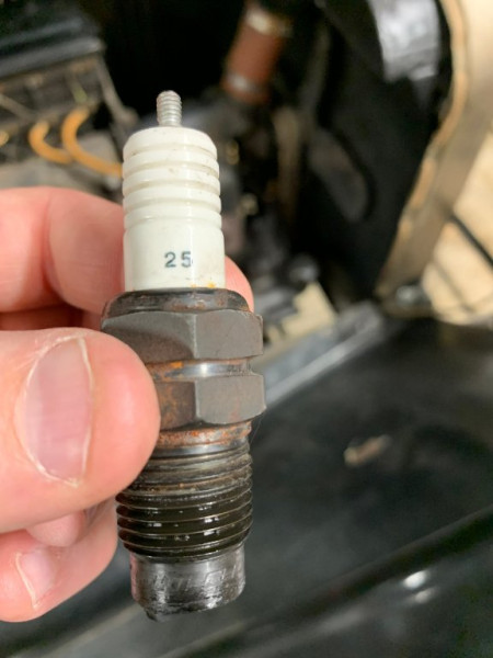

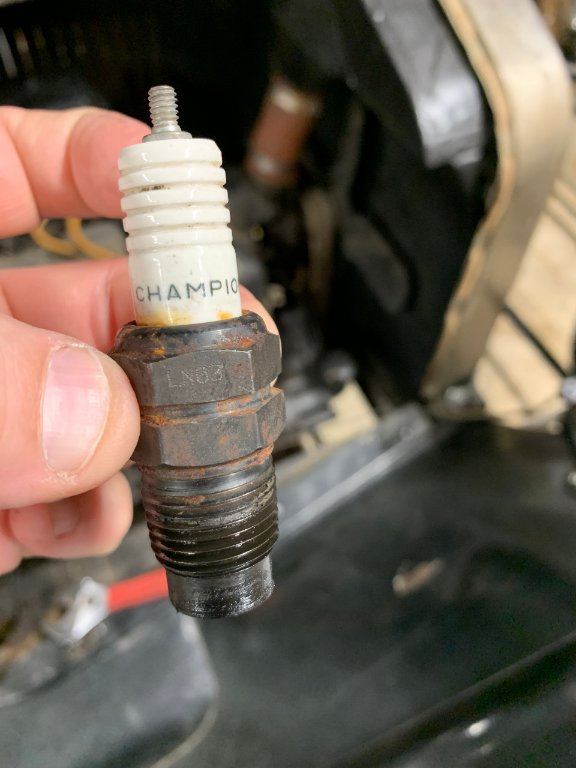

The plugs are fouled on my ‘26. It hasn’t run right since I got it at the end of March. I’m trying to clean these as best as I can. When I look in the spark plug hole I don’t see much shiny metal at all. I assume I have some pretty decent carbon build up. What causes this? I’m no stranger to old cars and cars in general. I realize that too rich of a fuel mixture can cause it. Also not getting the engine up to operating temperature, but what else? How far do I have to drive it to warm it up?

Yes, it does have a water pump. I cleaned the plugs last night and again this morning and checked the gaps. The gap was fine and was already at .025. This morning I drove to work (less than 2 miles) and it could barely get up to 13mph in low and eeked out 25mph in high.

I was getting some black smoke last night. I suspect that this car was restored in the 70's. The previous owner probably bought it from that guy (in 2011) and it was probably not driven much before he bought it. He said, and you can tell, that he cleaned the gas tank out. I never use ethanol in my A, T, '55 Chevy or mower. Maybe one night this week I'll take it on a long drive (if I can stand the jerking, bucking, missing) and see if that helps.
