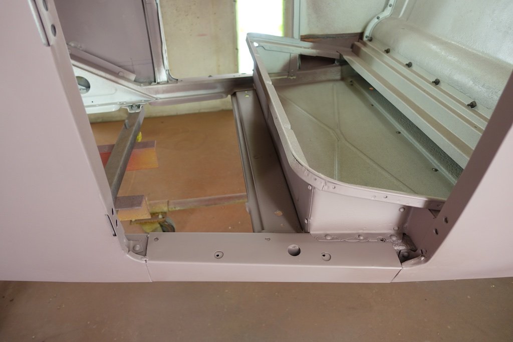

There was no under-seat sheet metal on my early '26 roaster. The lower sheet metal shown below is a replacement of what was there and had rusted out

The wood strip that runs the width of the seat in my car is not as tall as it should be but it seemed to separate two storage areas under the seat. The sheet metal in earlier cars that went under the seat spring cover the top of the gas tank and also prevented road debris, mud, rain from coming up saturating the underside of the upholstery. The 26 and 27 roadster and touring had a metal bottom seat frame. You did a nice job of cleaning everything up in your photo. Thanks

Had to look. There is about a 1 X 4 on edge. the upper edge is flush with the seat base.
It mounts to the front of the triangular cutout shown @ both sides. It supports the middle of the cushion springs.
