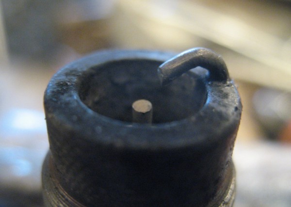

Topic author - Posts: 7347
Re: Another E-10 experience
As requested, this morning I got out the plug tester and checked the plugs I replaced. The first one was OK. When I applied pressure to the second one, air blew out of it due to a loose collar. So that cylinder lacked compression. After I tightened the collar the plug tested normal. The other two plugs simply don't fire at all. I don't know what's wrong with one of the dead plugs, but the photo shows the other. The mystery to me is how I ever installed that plug in the first place. Anyway, fire on just one cylinder explains the non-starting.
My eye tells me the gap is about 0.080"...
That's fine if you're running a GM HEI ignition system !
