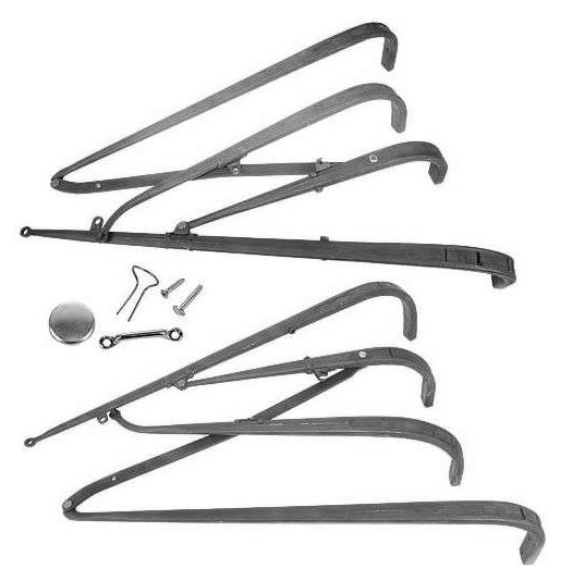

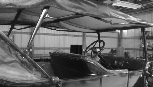

Does anyone have any experience with these aftermarket roof irons in picture 1? I have a set of these as per pic 2 below.
However it seems mine did not come with all the hardware such as the support bar and the hook brackets. Does anyone have any detailed drawings showing the dimensions of the support bars and position and placement of these so that the top extends correctly. If I cant find some used ones I may have to make them.

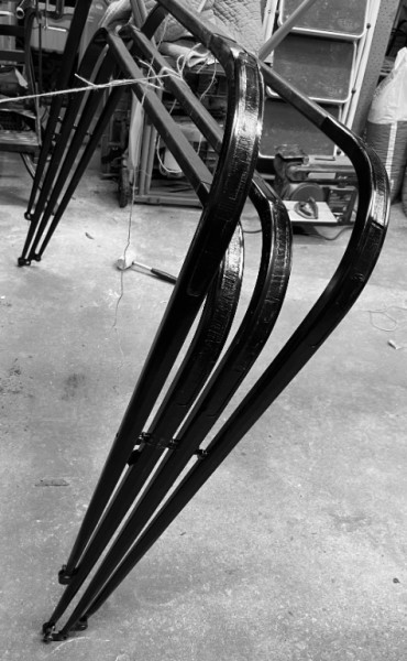

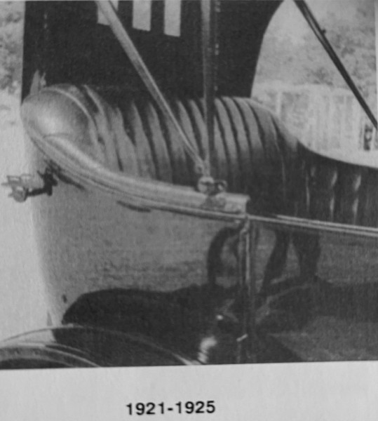

The 4th pic is one that shows this style of top iron that is attached together and then extends from there into a "V" All the other pics of roof irons Ive found show the iron extending towards the rear with a shorter iron extending about 12" up as per the 3rd photo

what year is your car ?
The first photo is the 1923 - 1925 style
the second photo looks more like 1921- 1922 style.

Picture no 2 is not a one man top. Does your car have body hardware for a one man top or a two man top? A two man top will have brackets on the front seat armrest for the front 1/2 of the top irons to attach to when in the up position. I do not know Canadian tourings, but if you have a straight up windshield and two man top brackets on the front seat, you have the right top irons. If you have a slant windshield and no brackets on the front armrest you probably have the wrong top irons.

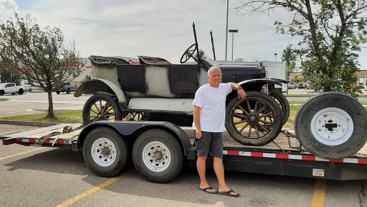

Hers a couple pics of my car. Its titled as a Canadian 1922 as its got 4 doors. Its got a slant windshield. Top iron posts only on the rear armrests and nothing on the front armrests.

Post by pete eastwood » Mon Apr 11, 2022 4:27 pm
Your car has the 1923 / 1925 style body.
Neither of the sets of bows you have are correct.
One of your sets is for a 1922, the others don't appear to be for a Ford.
You need to locate a set for the 1923 to 1925 body, like in the very first picture you posted .

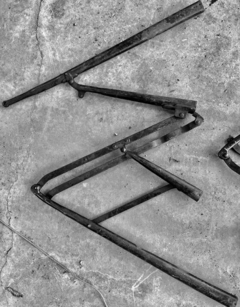

Update: I now have a set of top irons available as below. Does anyone have an opinion on these and whether I should use these ones?

From the picture they look restorable. They are touring one man top irons.

Canadian cars used different top bows than the US cars. Your original set, with oval sockets, may be the correct Canadian bows. That's not to say that the US style would not work however.
